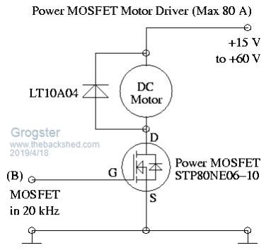

Using 12v fan out put of egs002 to turn a 48 volt fan on and off
A relay would be simple but can we do better with a mosfet
I think poida the great uses a mosfet
So what would the Circuit look like using a mosfet to turn it off and on
would a mosfet use less power than a relay
How about grounding when using a mosfet and wouldn't the mosfet need a diode and a resistor
Sorry if this is stupid simple
We are not exactly sure how we should do it
We was going to buy a control module but could not find one at a decent price for the DC voltages I needed
We already have 48 volt fans and would like to use onboard temp control
we would appreciate all the thoughts and ideas on this subjectEdited by BenandAmber 2019-04-19
Posts: 10084
Posted: 09:59pm 17 Apr 2019
Google Images is your friend with simple driver circuits.
This image found in a few seconds when I Googled 'MOSFET motor driver'.
Basically, any MOSFET with suitable S-D voltage and current to handle your fan will work. You need to be ABSOLUTELY SURE that Vgs(maximum gate-source voltage) is AT LEAST 12v(preferably a little more) in your design, or you could blow the transistor up before you get anywhere. Exceeding Vgs will usually destroy the gate and therefore, the transistor itself.
In this image from Google Images, I would also like to see a 100k or so pull-down resistor between gate and source, to keep the MOSFET off in the absence of an 'ON' switching voltage. I also tend to like using a series 1k on the gate just for a bit of additional protection, but then, as there is effectively zero current flowing on the gate unlike the base of a bi-polar perhaps this is overkill.
I would normally recommend my go-to MOSFET - the 14N05, but it's maximum gate voltage is 10v, so you would kill it with a 12v drive, so you will have to find another device.
EDIT: The STP80NE06 MOSFET in the schematic above would work nicely. It has a Vgs of 20v, so you could drive this one happily with 12v.
Link to PDF for STP80NE06 MOSFET... Edited by Grogster 2019-04-19

Thanks grogster I really appreciate your input
I have seen many circuits like this online
I just didn't know if it would cause any unexpected problems
like maybe the fan continue spinning after the circuits already turned off and back feeds into the circuit
or introduce noise into the circuit or hundred million other things that could happen that someone less experienced may not think of
People on here are very experienced
have been there done that
I figured I might ask around to see if there was any unforeseen problems
I might run into especially with grounding
And I wanted to know if a relay would do just as good or if it would use a lot more power
A lot of the questions that I asked on here I've already researched
But it's real nice to have somebody that's already been there done that tell you it will be fine
a lot of times they say hey this is a lot better way of doing it
But thanks again for chiming inEdited by BenandAmber 2019-04-19
Posts: 10084
Posted: 02:26am 18 Apr 2019
Grounding should not be an issue when you are only driving a fan-motor, solenoid or lamp etc. The grounding becomes incredibly important with the MOSFET inverters discussed in the other threads, due to the large currents being switched. You don't really need to worry about fantastic grounding techniques when only dealing with a few amps. That is not to say it is unimportant, but GENERALLY SPEAKING, so long as your ground is present and firmly connected, you'll be fine.
With the inverters, where there can be hundreds of amps being passed, a bad ground and I-squared-R heating can blow things to bits.
Oh, and your other question "would a mosfet use less power than a relay" - yes. Most definitely. A relay 'on' current could be upwards of 150mA or more, most of which is wasted in heating of the coil, but a MOSFET gate 'on' current is microscopic by comparison. Essentially, for most applications, you can assume that the gate current is zero. Or effectively zero anyway!
BenandAmber
Joined: 16/02/2019
Posts: 961
Posted: 02:30am 18 Apr 2019
That is exactly the information I was needing thanks again I really appreciate it I will most definitely use a mosfet instead of a relayEdited by BenandAmber 2019-04-19

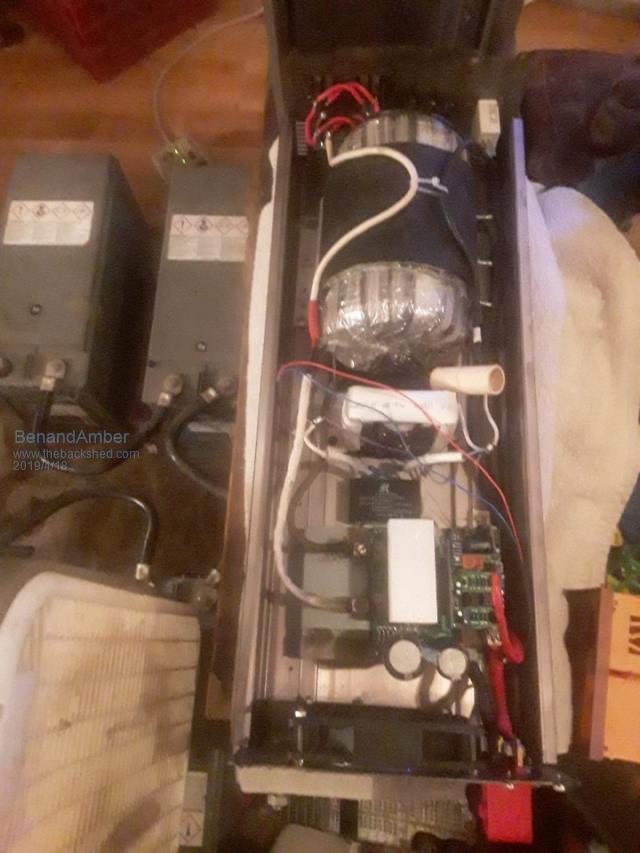

That big case fan the one I will be turning on and off with a mosfet I am very impressed with this little board I hope by putting those giant capacitors in there it will help it even more

I'm sorry I don't know how to do a link on here the name of the post is little Chinese inverter board
it is one of those little Chinese inverter board you can get for 27 bucks on eBay
I replaceed the Mosfets it came with Hy 4008 and done all the other things that poida told me to do to it
soldered in wire over the traces
I've done right at 2500 watts with it with no problem and it don't complain at all
For 27 bucks on eBay and a few parts good wisdom from poida not too shabby

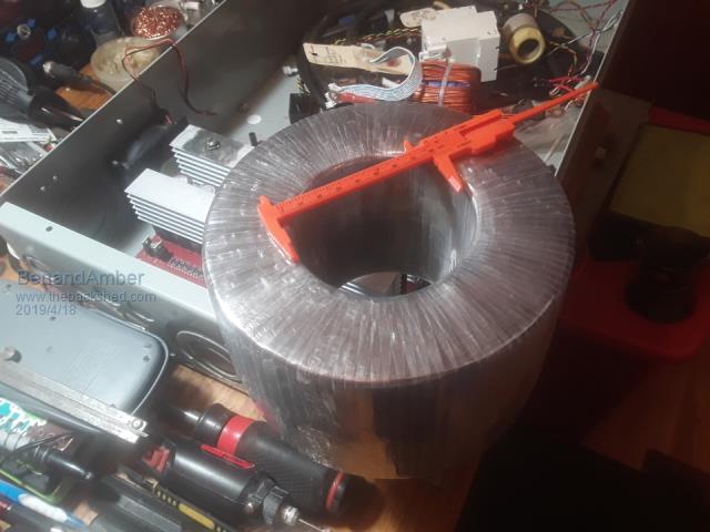

have you ever heard anyone making their own toroid core me and the wifey have done this and almost ready to wind wire on it will let everybody know how it goes
We wound the Silicon Steel around a sewer pipe and lacquered it with regular Automotive fiberglass lacquer
Poor people have poor ways we'll see how it works out soonEdited by BenandAmber 2019-04-19

That's one big toroid core.
The nice thing with big cores is the volt/turn ratio.
One this size will be great, you won't need to wind hundreds of turns
just to get to 120V.
We should start a contest. Who can guess the turns needed on the secondary for 120V,
without asking for dimensions. Just use the photo above.
Winner get's nothing much, just admiration.
BenandAmber
Joined: 16/02/2019
Posts: 961
Posted: 04:48pm 18 Apr 2019
Hint on size of transformer it's really not that big
it was made to fit in power jack case it's the smaller size swer pipe that we used for mobile homes
but it is quite a bit bigger than the power jack I'm not 100 percent sure after we wrap it if its gonna fit in there
we already have the volts per turn figured out staregazer dont get to guess because he was here when I done the math
So do you guys think going to work out okayEdited by BenandAmber 2019-04-20

The toroid is the width of a cantaloupe. It’s not as big as what the picture looks. He made it to fit in a power jack case.

A really big cantaloupe
I have a little under an inch to wind the primary and secondary
original Power Jack has lots of room vertically
this one will not it will be very close that way also hope it fits

  poida said   That's one big toroid core.
I look forward to the thinking process!
I know NOTHING about transformers so all your inputs will help me learn

LadyN I'm glad you chimed in
This may be a way of getting a large toroid core on a tight budget
This one that Amber and I made isn't all that big but it's big enough to tell if the concept is going to work or not
I will keep you updated

Using my old and tired eyes, it looks like the ID is 100 mm (3.9") and the OD is 200 mm (7.87"), roughly. Cannot guess the height.
