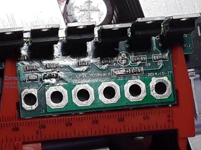

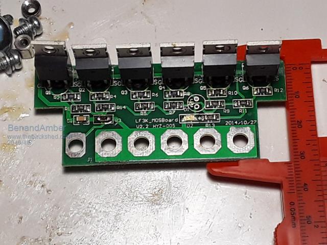

These little boards are out of a power jack inverter
as you can see these little boards take the little mosfet
I would like to use big Style hy4008 in these boards I would also like to have it be through hole
It would be nice to have a file that would make it possible for these to be ordered and made
I bet a lot of people would really appreciate this
these little boards are very expensive if you have to buy them from Power Jack
I could give somebody precise measurements of this board
I could send them one in the mail if anyone's interested in taking on this task
I have grown very fond of the hy4008 thanks you guys for telling me about it
I would really appreciate any and all comments on this subject

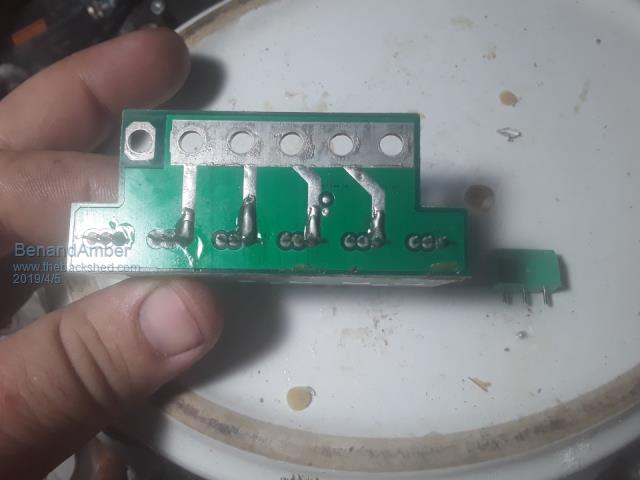

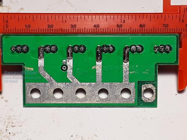

Thanks LadyN the little circuit board just has to be one-sided
I can add solder to it so it can be a very cheap
it needs no heat sink just a blank circuit board with the traces on it is all I need
it will fit four of the big mosfets instead 6
5 holes that are connected together and go to the right side pin of the mosfet need to stay in the exact same location
The single hole would have to stay in the same location
And I would want all the resistors to be through hole
I would probably have to send someone one of these little boards because there might be more going on there
It may not be that simple
I have a feeling there's a lot more going on there
all the mosfet would have to fire at the same time
I know anybody with a power jack would really appreciate these little boards
It would keep them from having to depend on Power Jack for them they are very expensive
And would be able to use the hy4008
so an expert needs to look at it but if you feel like you're up to it
I can send you one of these little boards and you can give it a try
you would have to chase out the circuitry and see exactly how it works and make sure the new one work the same
just using the bigger mosfet fewer of them and through hole resistor diode
I was hoping one of the experts on here that have experience with Power Jack would have pity on me
and make me a cad or Gerber file or whatever the PCB companies need to have them made
I know it would be awesome to have and not only for me anybody that had a power jack would really appreciate this hack

Now about PJ: these pictures are VERY VERY good quality - i think I will be able to design the boards right off these pictures.
So I will need your help with:
1. Part number and datasheet of the MOSFET
2. values of the SMD parts - you already have that component tester and that will give you the value of the cap (C1) on there.
We might need more close ups but let's start off with what we have once you give me the go ahead.

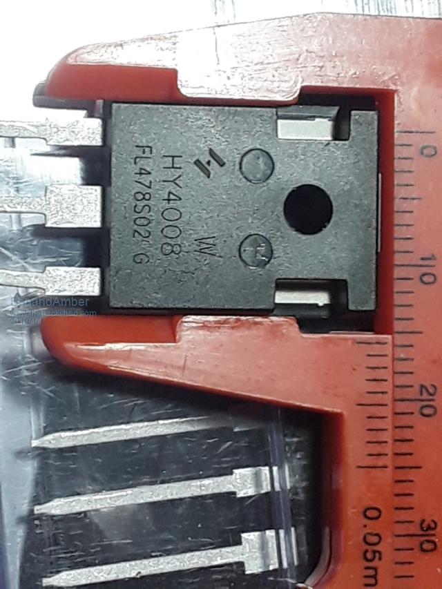

Take a few pictures of the MOSFET so I can see the part number and the area of the board near the MOSFET so I can see the trace better.
I need to ensure the MOSFETs can be interchanged.
I am also on the look out for the HY4008 247 Style. For some reason, I only see mostly the 220 style.
If you find a good source for the 247, let me know.

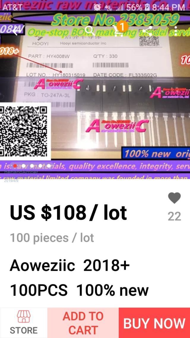

These are the larger size Hy 4008
Edited by BenandAmber 2019-04-10
BenandAmber
Joined: 16/02/2019
Posts: 961
Posted: 06:33am 09 Apr 2019
Someone gave a link on here or the otherpower website saying that these were authentic and a lot of fakes out there so I ordered them while I could and knew they wasn't fake
Keep in mind stuff changes all the time
I don't know if the ones you get will be fake or real
the ones I got were real and the person I got the link off of he ordered and got real ones off this guy
your results May Vary I hold no responsibilities if anybody orders and get gets fake ones I can just tell you my experience and how I got the linkEdited by BenandAmber 2019-04-10

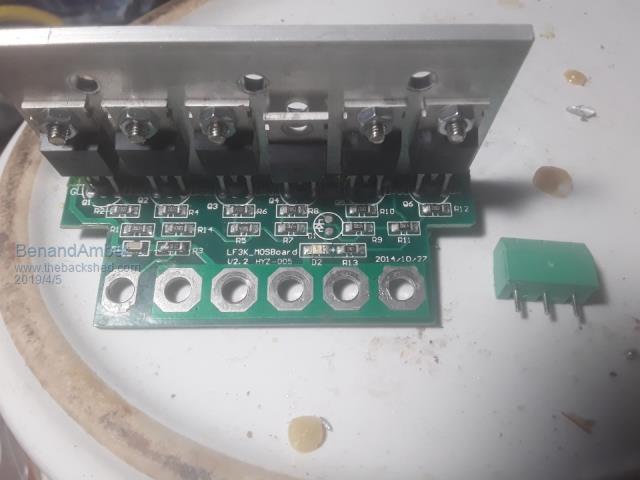

I have been pushing over 2000 Watts on just four of these on that little tiny inverter board I set that output amps at close to 20 amps on this little board so that's well over 2000 Watts it don't seem to mind it
poida
Joined: 02/02/2017
Posts: 1507
Posted: 08:09am 09 Apr 2019
  BenandAmber said   I have been pushing over 2000 Watts on just four of these on that little tiny inverter board I set that output amps at close to 20 amps on this little board so that's well over 2000 Watts it don't seem to mind it
It's important to have some idea of the nature of the loads, when you are pushing things (to see how far it can go)
Resistive loads like kettles, or space heaters are very different to inverter type microwave ovens, or inverter type AC units.
The inverter type appliances probably draw power in huge high current pulses, with little draw between pulses. The resistive loads are far kinder on it.
Ben, the specs for the HY4008 say they can switch 800A, but only for short periods of ON (milliseconds), with large periods OFF. They can handle 200A continuously, technically.
But that is only when they are on a heat sink good enough to keep the tiny silicon piece inside the package at 25 deg C.
One thing I have to ask is: DO you have a fan, that cools the heatsink?
The HY4008 specs show that temperature is the killer, when running them hard.
When they get to about 100degC - inside the package is hotter than outside - then you have to halve the amount of power they must deal with.
