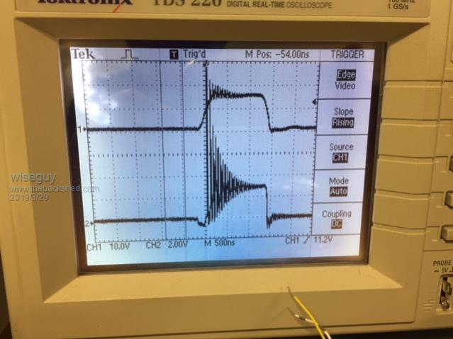

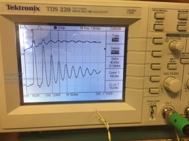

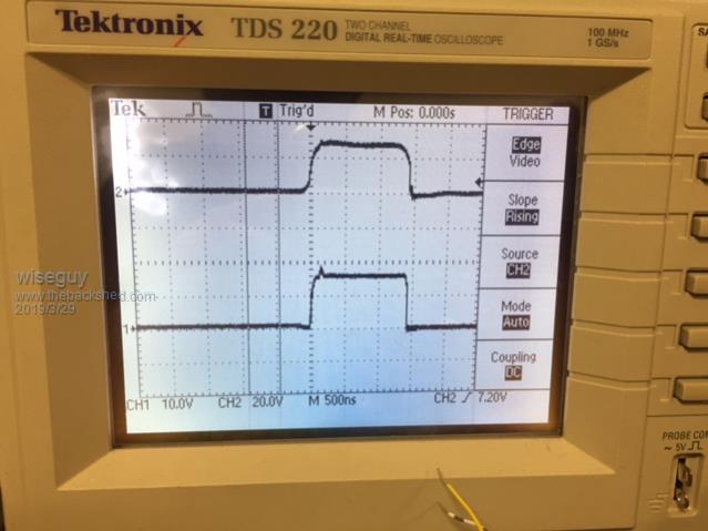

I have been chasing oscillations and ringing and other bad behaviour in my high speed FET power boards for a few days now. I was about to start a Warpverter in disgust but then I had a lightbulb moment - "I wonder if a ferrite bead might help".

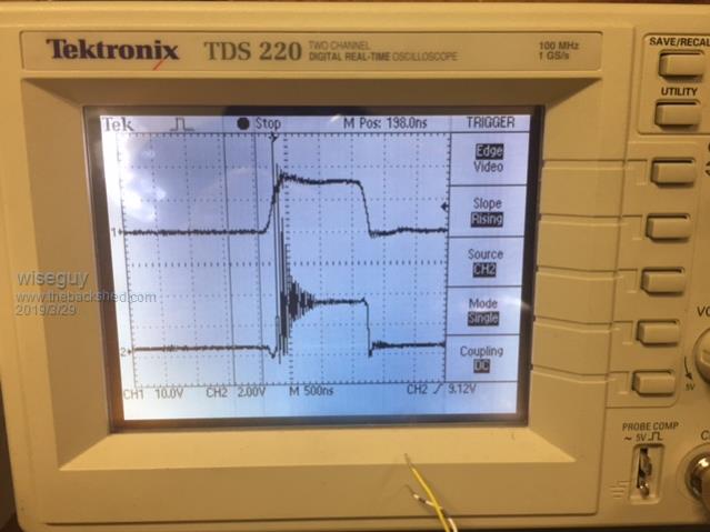

Here is a CRO shot of the crap that needed fixing. The top trace is the upper FET gate drive used for syncing the CRO. The bottom trace is the lower FET's Drain.
Here is an expanded view of the oscillations. Note the time cursors reveal a frequency of ~ 21MHz
OK so let me slip a Ferrite bead over the lower FETs Drain lead to see if it makes a difference.
Hmm slight change there, well that sorted out the LHS FETs.
What does the RHS look like ?
Ok so lets slip another ferrite bead on the centre leg of the Lower FET.
OK, I'm convinced I just love Ferrite beads - and I finally see with my own eyes - very graphically - why they are used.
FYI I tried combinations of 1 - 3 beads on each of the 4 FET's legs (12 in total) the best place was on the Drain of just the lower 2 FETs.
Some of the FET's legs I tried had some really weird effects and distortions, so dont go crazy adding beads everywhere willy nilly, they dont all make it better.

  wiseguy said   ....
Putting them on the drain in my case helps, adding one to the gate lead made it worse - but I already have an smd inductor in the gate circuit. Maybe when i start paralleling FETs I'll have more information to add.
Thanks wiseguy.
How about just a bead on the gate lead and none on the drain. This is how I did mine.
There is also some ringing on the gate, could be a chicken and egg thing.
Edited by tinyt 2019-03-30
wiseguy
Joined: 21/06/2018
Posts: 1335
Posted: 03:47pm 29 Mar 2019
Hi TinyT, The ringing on the gate is simply the ringing present on the Drain being coupled back to the gate via Drain Gate capacitance. The gate signal has no ringing of its own.
A bead placed just on the gate lead changed the shape of the ringing but in no way mitigated it. When I put it on the drain only it was like a signal from another planet compared to what I had been chasing, a bit like a whoa camel moment see here .

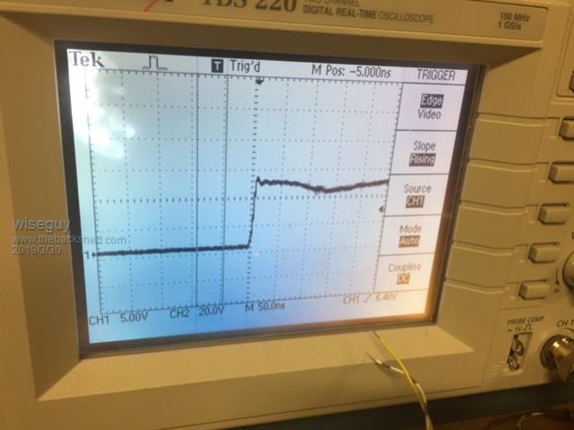

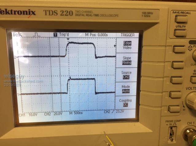

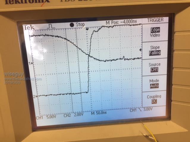

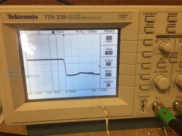

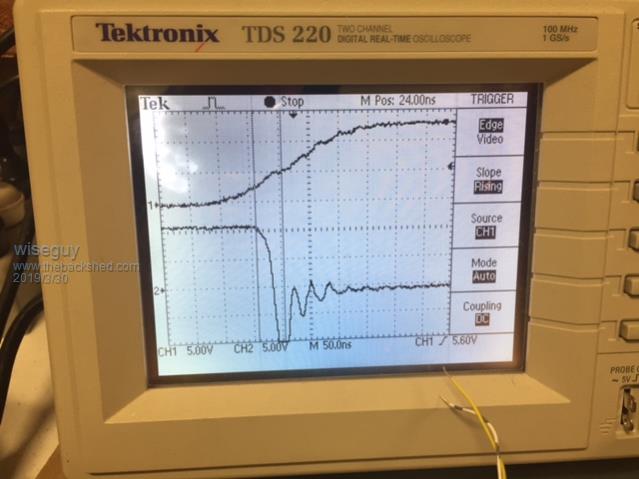

FYI & anyone else interested here are some gate drive waveforms.
Output rise and fall from TC4452 12A gate driver IC
Gate drive rise time against FET turn on (Drain falling)
Gate fall time against FET turn off (Drain rising)
So it can be seen that what appear to be relatively slow rise and fall times at the gates are still turning the FET on and off in a few tens of nano seconds.

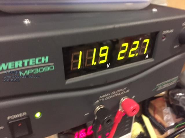

Lastly a picture of what happened to the supply current when I plugged in my Hakko desoldering tool as a test load. I probably should fit some heatsinks before driving it much harder.

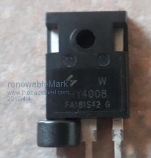

Posted: 12:56am 30 Mar 2019
I got these that fit on 4008 fets.

Posted: 05:46am 04 Apr 2019
Got these in today, they fit nicely on the centre leg too.
John, I'll stick some in the pack along with the other things that haven't turned up yet.

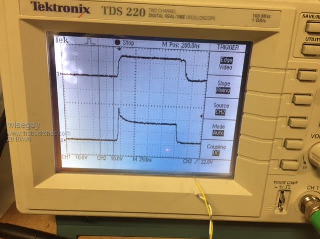

Mark, that's not a bead its more like a small toroid............
Ok it seems there may be a slight downside to adding a bead to the drain leg.
Yes it stops the 21MHz ringing I had - looking at the drain connection on the PCB it is well behaved now with no sign of bad behaviour.
But are we really looking at the Drain - No we are not, we are looking at the other side of the inductor we just placed in series with the Drain - what is actually happening at the Drain is now on the other side of the ferrite bead directly at the Mosfet's Drain leg.
Top trace is the Drain connection at the PCB side of the bead, bottom trace is on the FET's Drain on the FET side of the bead.

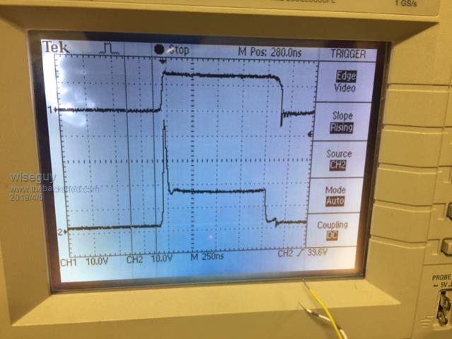

- where did that come from ?
Well we all know that if we put current through an inductor (the ferrite bead) and then suddenly interrupt the current, we get a voltage spike, in this case way above the applied voltage. Yep we just generated about 30V along 5mm of solid FET Leg !!
The only way I was able to tame it a bit was to put a resistor of 10 - 15 Ohms across the bead, the picture below shows the improvement.
Bottom trace is the Drain on the FET side of the bead with a 15R across the bead.
My inverter that these signals are taken from is 12V in to - 230V~ out.
This was an effect easily explained but was quite unexpected - it was just a teeny ferrite bead and it added nearly an extra 30V on top of the 12V to the Drains !!
On a 48V system I guess it could present well over 100V to the FET. Maybe the FETs can avalanche this bit of energy without batting an eyelid - the main reason for highlighting it is the extra noise generated by the spike. Its also an inherent downside of fast switching - keeps the FETs cool but can generates a lot of harmonic noise.
