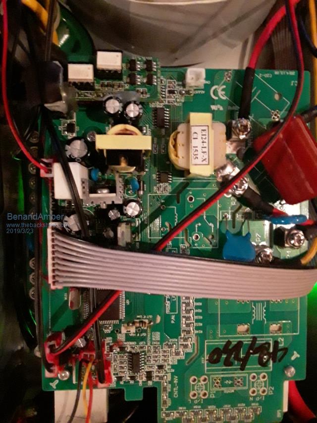

My wife ordered a 110 volt version got a 230-volt version
Need help badly from a expert
Questions
is this most likely 50 hertz and not 60 and how can I tell the difference I have no scope
Are the control board's the same 4 110 and 230 volt inverters maybe just Center tap on the 230-volt Transformer make split
Does anybody know how to change this board from 50 hertz to 60 Hertz or is that just a silly question
We can do without 220 volt but we can't do without 110 volt
We definitely don't want to send it back shipping cost way too much the sellar is good guy will send me parts to change it over just not sure exactly what I'm going to need this is a New Old Stock inverter from 2015
Thanks again everybody I really appreciate itEdited by BenandAmber 2019-03-24

I could rewind the Transformer I just don't know how to get past the 50 and 60 hertz problem
not sure if that control board would work with a center tap Transformer

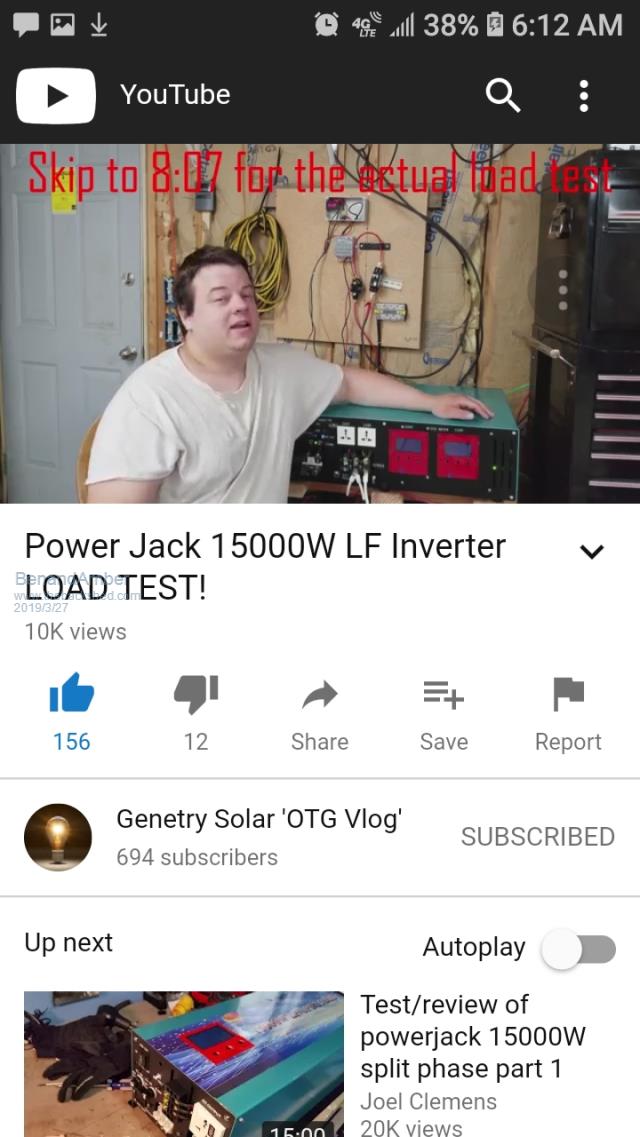

Update the guy that sold me the inverter insisted on sending me a replacement
I told him it wasn't necessary I would be happy with control board
I would rewind the transformer
He said no this was his fault he don't do business that away and he was going to send me nicer one with a bigger Transformer
told me for my troubles to keep the first one and he would try to get me a control board ordered in for it I knew he was a really good guy
He said he sent it out today I will keep everyone informed and take pictures when it gets here I bought it off
Genetry Solar here is his YouTube channel he has hundreds new and used power jack inverters all different sizes

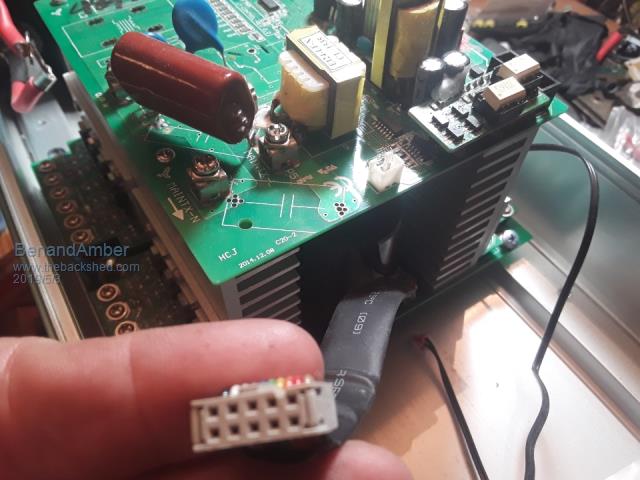

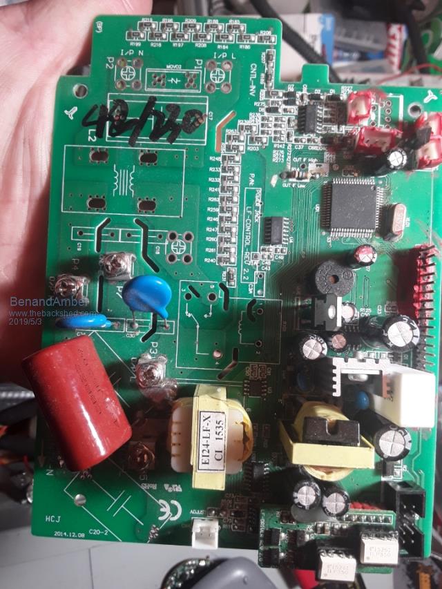

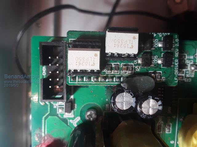

I was hoping someone could tell me this Power Jack control board could be replaced by the Nano or mad control board
it is out of a 8000 watt power jack
I was hoping to make this inverter a 60 hertz 120volt
it is currently a 50 hertz to 230-volt
I am in process making a Transformer for itEdited by BenandAmber 2019-05-04
renewableMark
Joined: 09/12/2017
Posts: 1679
Posted: 08:06am 03 May 2019
OK I got in touch with Oztules for you.
The pinout of that p[ower jack 10 pin connector is the same for the oz/Mad and Nano control boards.
I don't know what else you would need to take into consideration as I'm not familiar with the power jacks, but at least the ribbon cable is compatible.

Use a nanoverter control board to drive a Powerjack power board?
I think it will work.
I have a Powerjack LFPSW-6000 model here, not being used.
And a good working nanoverter control board.
(oh, and a Mad control board, using the 8010 too, which should run it as well)

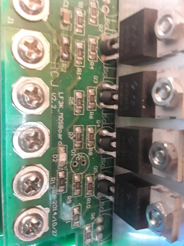

If going on original PJ standards, you will need to change the 47ohm mosfet gate resistors with the 4.7ohm/4148 diode combo (for eg8010, assuming nano the same ??).
Everything else will work fine. .. i do remember something about the snubber circuit the PJ's run will get hot, but don't quote me on that one

Poida is talking about my Mad control board.
Ben you are welcome to it.
Just send Poida some coin for the postage.
Poida, you may need to change the crystal for 60hz???
EDIT, the Mad board has digitally assigned temp sensors, I have those here still.
If you send it off better get those and a programmed nano, otherwise it will be a turd of a job to work it out. Let me know, I'll drop them over.Edited by renewableMark 2019-05-04
