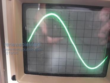

I got the chips from Mad that he has been running.
This is it with full power but no caps.
No wobble with the voltage like the others.
Will fit the big caps and re test.
Very frustrating that your success is dependant on quality control from unknown sources.
I still can't see the difference in the signals coming from the 2010 test points, there has to be something.
