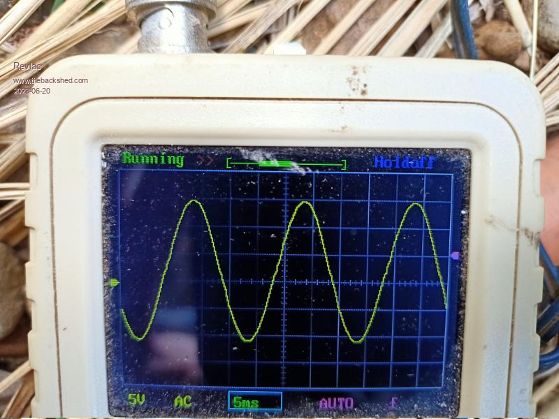

Ok, time for some boring sinewave pictures, These tests were done on the Old (2015) PIP4048HS inverter (voltronic)

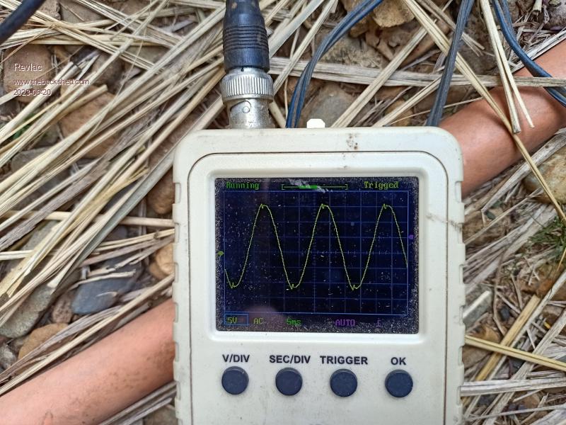

First picture, no load just for reference.
Now the load here of 1600w induction cooker running, surprised me that it looked as good or better than no load at all, I was expecting a lot of hash but didn't see any.

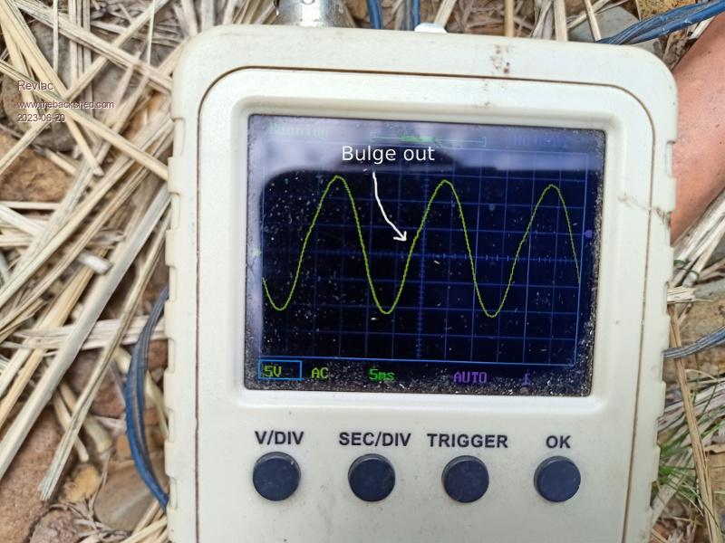

Now the dreaded heat gun on low, I have tried running this one on this inverter before and the inverter would shut off the output due to over voltage on the high voltage DC Bus after several seconds then restart and try again.
I had never test ed the sinewave when this was happening until now, I was expecting it to have some nasty chopping going on as it did in the little generator.
What it did was bulge out just above zero crossing and go progressively larger than in the photo, just too hard to capture it with these limited tools I have.

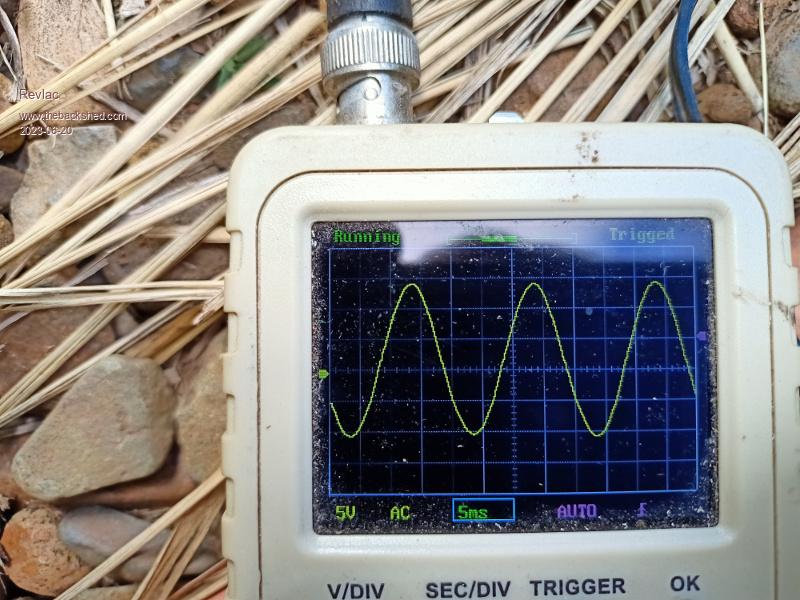

The next idea was to forget using the low setting on the heat gun and just use the 10Kw scr speed controller to see how that turns out.
I connected the speed controller and turned it on, it puts a few spikes on the sinewave at irregular intervals, wound it up till the output was up to 1000w can see some ripple just after the peak of the sinewave, inverter was happy running with this but not sure for how long.
wound it up till the output was up to 1300w can see some ripple just before the peak of the sinewave, sort of makes sense that it would work that way.
Turn the speed controller all the way up and its perfect, the heatgun is just a restive load then, all good.
So I think I will just remove the low speed setting from the heat gun and use the speed controller...much more fun.
I know these tests on a low Frequency inverter are going to look a little different but I will get to that on the next build.........Hopefully.

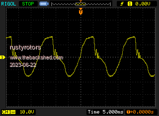

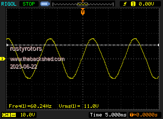

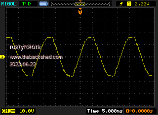

here is my baseline waveform, running the house with minimal load. 24v 3kw egs002 low freq inverter with 25uH -26 powder iron choke
heatgun on low
microwave.  whats going on in a microwave that causes so much distortion?
2500W air compressor. i think whats happening here is a large motor load acts like a filter. the motor absorbs anything that is not a perfect sinewave, converting it to heat, and makes the waveform very clean. clean waveform is not due to the inverter build quality, its actually the motor doing all the work here. agree?
Edited 2023-06-22 05:26 by rustyrotors

Thanks for the DSO screen shots.
The first two show ringing in the toriod caused by the loads, you can improve this by adjusting the choke Inductance down a bit, however you need to be mind full on not compromising the FETS switching current at Idle and low power.
I managed to remove almost all of the ringing and the H-Gun on low looked like that before I lowered the inductance, now it only has a kink, the toriod noise is reduced dramatically. But you are very close to having it right, and at 25uH this might be as good as it gets with this inverter.
I've noticed that with most inverters, placing a big resistive type load results in the cleanest AC waveform. If I drive 4kW of heating elements or a big induction motor, the AC waveform is a copybook sinewave and it was the same at 8.2kW.
I would still suggest that the size of the toriod and the winding ratio will have an effect on the final loaded waveform and noise with bad loads. But obviously the Toriod is dampened by this big resistive loads that swamp the other crap floating around on the AC line.
I'm still amazed at the silence of this inverter, and I can't even remember the last time a fan started.
Edited 2023-06-22 09:24 by KeepIS

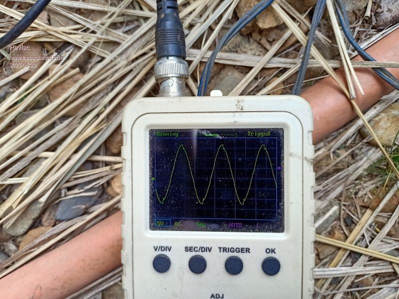

I tested the sinewave on with the microwave (old whirlpool 595) running at full power on the HF Inverter and it had 2 small kinks halfway up and down the other side, cant find the picture I took back then, I tried running it today to take another photo but no kinks at all this time it was just a perfect sinewave, just a slight drop in voltage, so I'm sure a good low frequency inverter should run an old microwave without issues.
