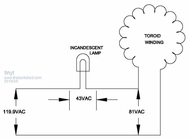

119.9 main wall outlet
81 volts after light bulb
43 across the light bulb
I'm trying to figure out volts per turn

The way I understand the above, the connection looks like this. Lamp wattage is not given. I don't know which winding is connected. It should be the one with the higher number of turns for this test.
And there is no load on the other winding. For an efficient transformer, the voltage across the lamp should be low and almost all of the 120vac should be across the transformer winding being tested.

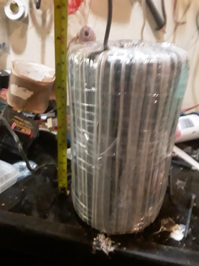

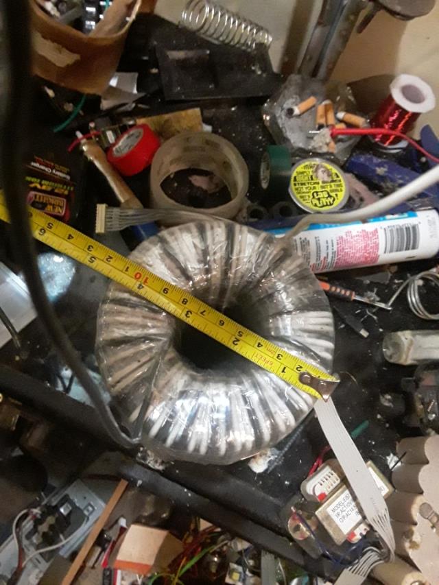

Based on the pictures, the toroid is roughly 4 inches OD and 2 inches ID and the toroid core stack is 7 inches (177.8mm). The toroid core ring width is roughly (4-2)/2 = 1 inch (25.4mm).
So the toroid core cross section is 25.4 x 177.8 = 4516mm sq.(roughly)
Using the magic number of 2800 (for 50Hz) in Clockman's guide, the volts/turn(?) ratio is 4516/2800 = 1.6128. So, for the 120vac winding, the number of turns is 75 (for 50Hz). I think we can just use the ratio 5/6 to get 75*5/6 = 63 turns for 60 Hz.
Looking at the pictures, I assume the white thing is the wire winding with more turns and the black thing has less turns. I am assuming that in the test, the white winding is the one connected. I don't know how many layers of white wires there are, assuming there is only one layer, I counted roughly 50 turns. I think you will need more turns. And since there is a big space inside the toroid hole, I will put more turns than the rough calculation above.

Thank you tinyt the white and black wire is the 120 volt 60 hertz wanding she did it about a year ago and lost her Notepad that she had everything wrote down in but I'm thinking she put around 114 turns on it she did the calculations and added a few more turns she was trying to figure out how many windings for the low side windings she figured it out few nights ago I helped her wind it I know she had me help her wind 22 turns I can't remember how many volts per turn and all that though I think you got a really close especially for just looking at a picture thanks again for all your help

  BenandAmber said   Thank you tinyt the white and black wire is the 120 volt 60 hertz wanding she did it about a year ago and lost her Notepad that she had everything wrote down in but I'm thinking she put around 114 turns on it she did the calculations and added a few more turns she was trying to figure out how many windings for the low side windings she figured it out few nights ago I helped her wind it I know she had me help her wind 22 turns I can't remember how many volts per turn and all that though I think you got a really close especially for just looking at a picture thanks again for all your help
So based on the picture and your description above, you have two separate windings in series. One winding is black wire and the other is white wire and the total of the two is 114 turns. But I don't know if they are split equally ( white=57 turns, black=57 turns). And there are no other windings.

Amber didn't have enough of the black wire so she had me solder the black and the white wire together
it's the exact same gauge it's 10 2 electrical outside burial wire
both wires came from this wire the outside sheath was cut inside wires removed
they were put end to end and soldered together
then heat shrink was added
it was wound in a single wind in out and around
it was so long it was about impossible that's what she uses me for to chase wire while she Loops it through
she puts her feet on the Transformer and pulls like hell lol
probably a much better way to do this
it wouldn't fit on a bobbin
the least winding side is number three enameled wire from a giant e style Transformer

core size OD 101.6mm ID 50.8mm, HT 177.8mm
core area 4516cm2
Flux density : 0.875 T @ 60Hz
Primary : 114 turns (1.053V/turn) - 120V input
Secondary : 22 Turns - 23.16V output
You need closer to 30 turns for 32V
I think... 1st edit..Edited by ltopower 2019-03-17
