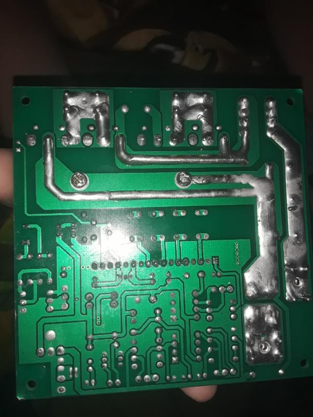

Time to figure out what parts I need to upgrade it to make it Bulletproof
So i get practice before I get my big board
This little board has a EGS002
it also has four iRFp 2907 Z mosfets
it is supposed to B good up to 1800 watts it has two little 470uf 100 volt capacitors
2 soldered in car type fuses 40 amps each 4 trim pots
2 LM 358 chips
it came with a separate dark red or maroon hard plastic filter capacitor
the number on it is MPP 335 k 2 f. Co223212f
I have a extra ESG 0 0 2 and the little LCd screen also
BenandAmber
Joined: 16/02/2019
Posts: 961
Posted: 05:35pm 21 Feb 2019

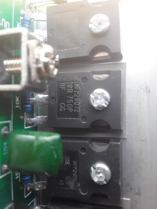

All 4 irfp2907z the print on each one of them looks a little bit different
like they're not from the same batch
the top line of print is all the same letters and numbers
the second two lines of print are different letters and numbers
it came with one of the capacitors bent over
and the little board that sticks up vertically also bent over
which I think controls what voltage input came packed in Thin star foam looking stuff wrapped around it
With a little bit of tape no box not much protection at all
it has three bad solder points on the bottom
to dry joints and one without any solder all components go through the board and solder on the bottom
the mosfets are incredibly close together and it has screw on connectors for the in from battery and out to Transformer
the board is 4 in by 4 in
the heatsink is the tallest thing sticking up and it is 2 and 1/8 inches tall
I paid $28 with shipping off of eBay
I guess you get what you pay for LOL
the only thing that was a surprised to me was I thought the mosfets was going to be hy4008
looking forward to any comments or suggestions this is my practice boardEdited by BenandAmber 2019-02-23

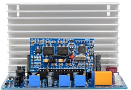

https://www.ebay.com/itm/Pure-Sine-Wave-Power-Frequency-Inverter-Board-12-24-48V-600-1000-1800W/362490571177?hash=item54 661f29a9:m:mhPyFyazEiGJzOlfxDsHrAg. This is the board I have I hope this link Works because I can't figure out how to upload pictures
BenandAmber
Joined: 16/02/2019
Posts: 961

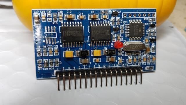

Posted: 09:03pm 24 Feb 2019
I got to looking real close at this little board trying to figure out how it works
I had my magnifying glass out there
I'm getting a little bit old

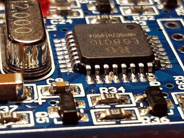

I noticed the little 8010 cip had two pins shorted out to each other
I have pictures. I just don't know how to put them up here
help please but anyway I had another EG s002 board so I switched them them
but this was a good excuse to tell the wife why I needed a rework solder station yeah Boy I got it ordered
I have three irons already
the giant one was probably made in the 30s I love it by the way it's just Giant
I have one of those Walmart $10 jobbies then I have one I ordered off of eBay that I was very impressed with
cost of like 7 or 8 bucks blue and it's got a temperature setting on the handle of it ceramic element inside really impressed with that oneEdited by BenandAmber 2019-02-26

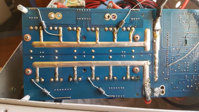

I now have a couple of photos of my board's protection.
Here is part 2:
Obtain some 15V TVS devices. I think of these as good, strong, fast acting
zener diodes. They permit up to 18V to pass in one way, and very quickly clamping any voltage over this. And when voltage is flowing the other way, they are fast diodes, conducting the current, but with a small voltage drop of about 0.4V at the working currents.
RS part no. 815-2578
Vishay ICTE15-E3/54, Uni-Directional TVS Diode, 1500W, 2-Pin 1.5KE
AUD $0.92 each in a pack of 10
We want to protect the gate drive outputs of the IR2110 chips.
The manufacturer states all outputs must never go below about -0.3V compared with
ground or the high side "ground" which is the high side MOSFET's source pin.
Additionally, the specs say to never exceed 20V.
These 15V TVS diodes are about right for the job. Read the specs.
We only need 4, and we connect them near the MOSFETs, since that is where the potentially damaging voltages are generated. We connect each gate drive output to the corresponding MOSFET source pin.
In the case of my board shown below, I have 3 MOSFETS in parallel for each of the 4 legs of the full bridge. So I only need to do each leg of the full bridge, not all 12 MOSFETS.

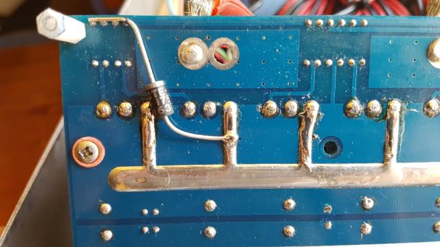

all 4 TVS in place:
a detail shot of one, showing polarity. Take care to fit these the correct way.

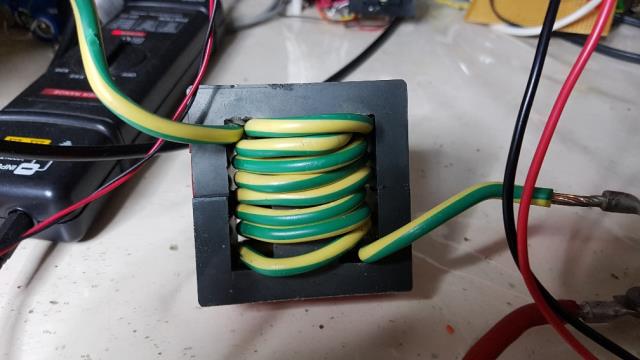

part 3, the choke:
Find a suitable and large ferrite E core.
I used one of these
https://au.rs-online.com/web/p/products/8407648/
stock no. 840-7648
It has a 0.5mm gap. Wiseguy correctly pointed out in another post of yours
my incorrect calculations.
Other people here have made their own, in different ways, using different cores.
We need something like 45uH, and the inductor (or choke) needs to still
work with currents well over 100A if you are planning to put 5000W through a 48V inverter.
You probably need 6 turns of the thickest cable you can fit.
You have an LCR meter? Handy to have but not mandatory.
No need to sweat over the value, 40 or 60 uH is good enough.
Here is one of mine. I used 6mm2 cable, 8 turns as you can see.
The LCR meter shows 46uH and in testing, it does not saturate until about 70A or so (from memory)

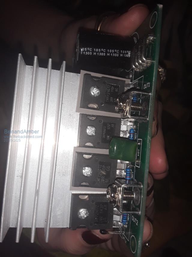

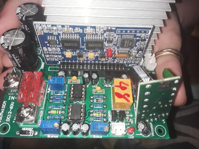

Little practice board
BenandAmber
Joined: 16/02/2019
Posts: 961
Posted: 02:15am 25 Feb 2019
BenandAmber
Joined: 16/02/2019
Posts: 961
Posted: 02:17am 25 Feb 2019
The ESG egs002 board game with a short across two pins but luckily I had another one and I haven't powered it up so I should be able to fix thisEdited by BenandAmber 2019-02-26

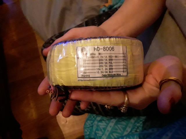

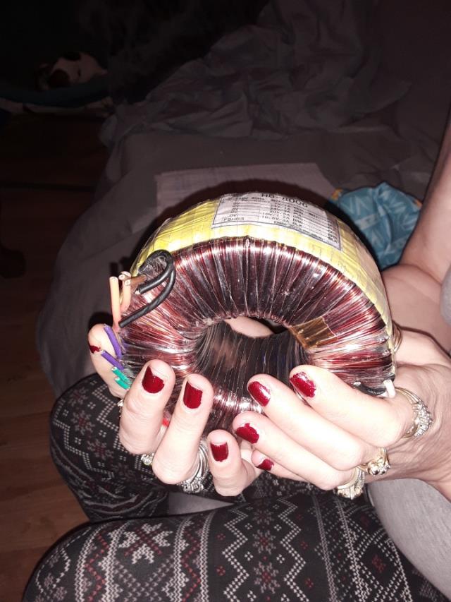

I thought about rewrapping a couple of these to run this test board or maybe I can use them the way they are I'll post another pic of your tag
BenandAmber
Joined: 16/02/2019
Posts: 961
Posted: 05:59am 25 Feb 2019
These are the ones I said I had a few extra for somebody needed

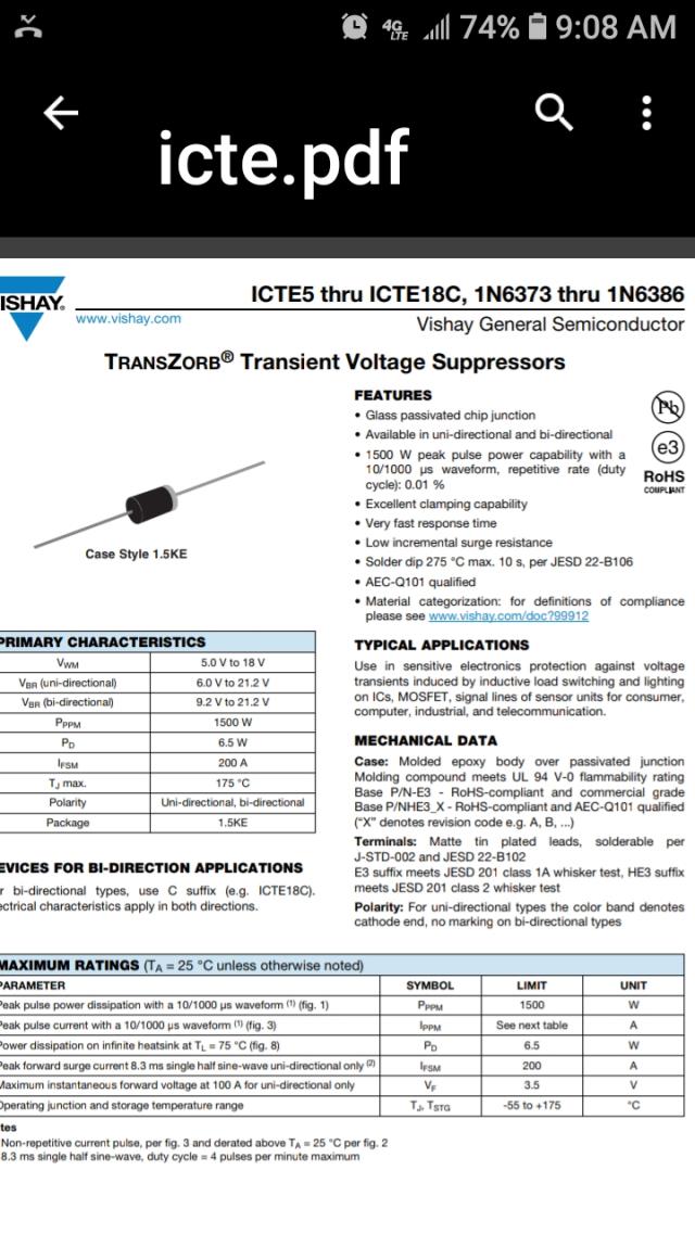

Poida is this the right part it is from digikey
