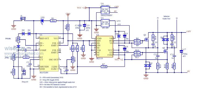

Instead of a heap of words followed by a schematic I will do it in reverse, so here is the schematic. I have been prompted to provide some details so here it is.
Or for a clearer image 2019-02-17_102257_ST_Schematic.pdf

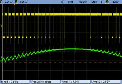

Instead of driving the inductor with a 50% square wave and variable frequency I decided to try a different approach. I have excess SG3524's around so chose that for the PWM generator. Using a pot I can create a PWM pulse as narrow as ~ 300nS, at the max pot setting it becomes a 50% square wave of the frequency determined by pot 2 which has 2 ranges. The max pulse width at the minimum range & minimum pot is ~1.6mSecs the maximum on the highest range max setting is ~ 15uSecs.
So in effect I have a variable pulse width generator at a variable repetition rate.
I also wired the SG3524's current limit input with an adjustable current limit after proving that a saturated inductor indeed becomes a dead short..... & killed a FET.
The current sense is a 0.005 ohm shunt and is the best place to view the current ramp. I purchased one of the 4/40/400A active current probes with a BNC for the CRO - but am quite unimpressed with the performance compared to just monitoring the 0.005 ohm shunt.
I chose an arbitrary inductor of 30A which yields 150mV for 30A across the shunt as a starting point. I had to provide some voltage offsets for the shunt current/voltage feedback and the current target setting trim-pot. This allows the current limit to fully disable output drive at minimum current setting. Note the current is not reduced at all until the current applied to the current +/- pins has increased beyond the internal 200mV current sense threshold. I empirically set the current limit by setting the trim pot near minimum and driving an inductor into saturation and then slowly adjusting the current limit until the max amplitude was 250mv on the CRO which corresponds to 50A. The Mosfets I used are IRFB4710's (~70A @ 100V) but the HY4008's would be excellent also. The U30D20 power diodes I user were also a TO247 mount.
I provided a small DC/DC converter to supply the isolated upper FET gate driver - these are only a few dollars, I also provided for the usual diode fed bootstrapped upper FET supply voltage but havent proved that it works. As I expected that the voltage required for testing would be at least 30V, I used a cheap ali express step-down converter to provide the 12V power for the circuitry. So inductors can be tested with voltages from 15 to at least 40V.
Whilst viewing a repetitive current Ramp of 20A the circuit draws around 60mA from the 30V supply.

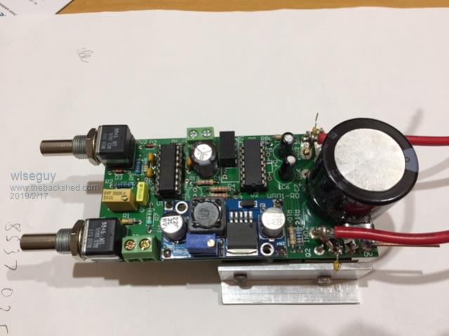

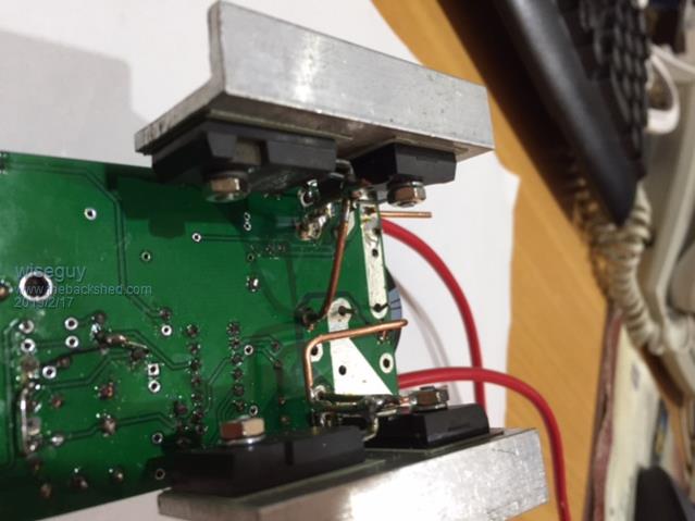

The PCB is 50mm x 100mm and the main capacitor over hangs one end. The Mosfets are soldered to the PCB, the 2 diodes are connected to the FETs and PCB with 1.5mm copper wires.

I stole this picture off the internet, it shows how ripple falls to a minimum at the exact 100% duty cycle, and at the extreme left hand edge of the screen the duty cycle looks to be about 50%.
I think you should give the picture back....
That picture tells a good tale - it tells me that at the peak of the sinewave there is no headroom left from the supply voltage - to meet the peak, the PWM went to 100% and there was no more. If there had been a few volts of headroom the ripple would not have gone to zero. Except for the zero crossing where no switching or current briefly flows, there should be a variable height sawtooth ramp over almost the whole sinewave.
Of course the P-P ripple and the rising and falling ramps will have different slope rise and fall ramp angles according to load and Vin.
What I am suggesting, is we set some minimum acceptable target inductance for worst case ripple current, and try to do better than that if we possibly can.
