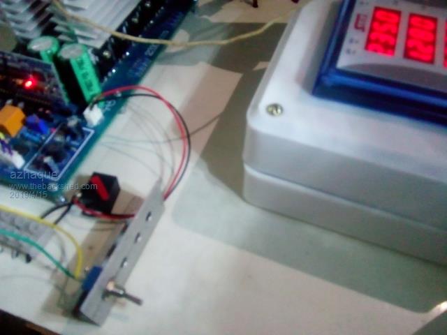

Hi Poida,
What a coincidence! I have just finished making an inverter using the chinese inverter board that you have described above. Photos of the homebrewed inverter are given in another thread (https://www.thebackshed.com/forum/forum_posts.asp?TID=11134&PN=1 see page-2) on this forum.
I tried the unit the first time today. The test was unsuccessful. The voltage drops to 161 volts as soon as the wires are connected to the house wiring into the fusebox.
Reading your response above indicates to me the mistake I have made. My inverter does not have the high frequency choke installed. The webpage of the inverter board indicates that in case of E-I cores such a choke is not required. However I think it may not be possible to operate the inverter without it. I will now make amends as suggested by you in your post above.

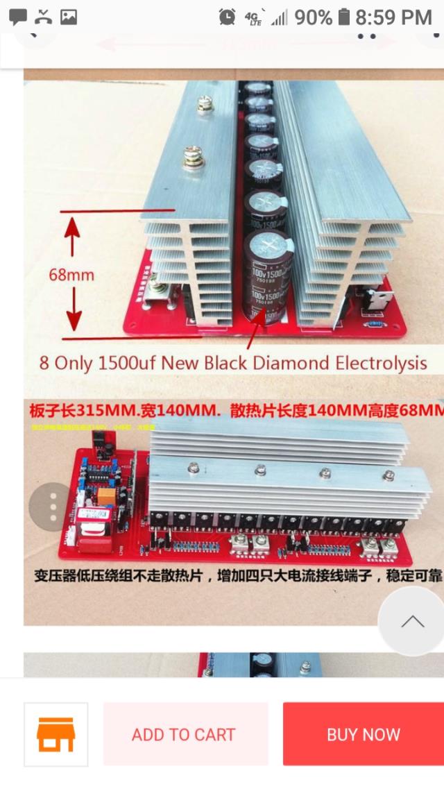

This is the board I plan on using

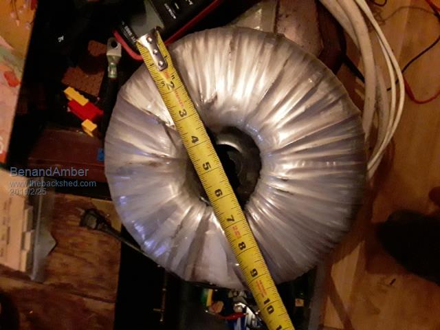

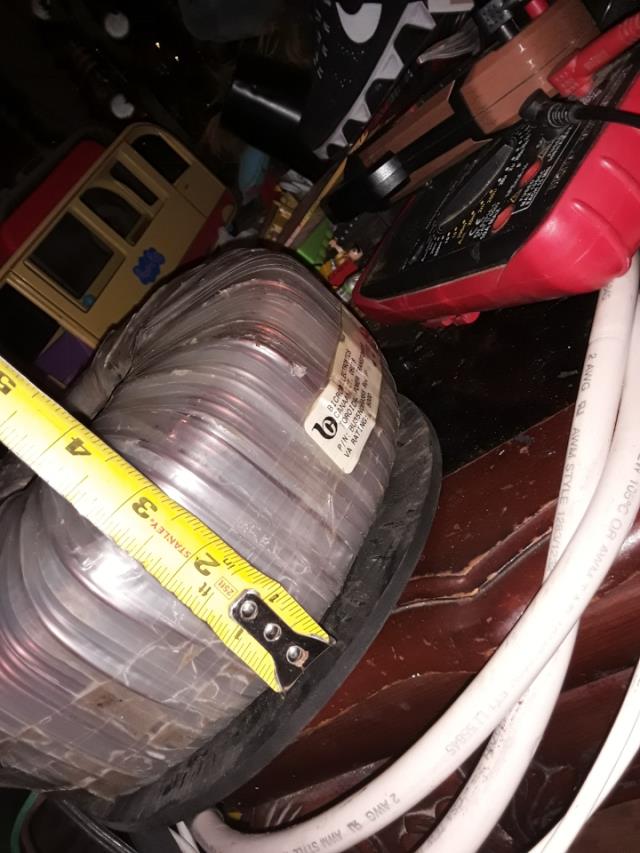

This is my 52 lb 5000 VA Transformer I will be using

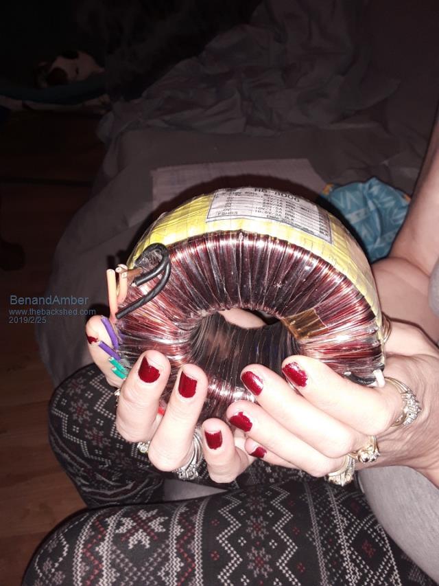

This is one of those Transformers that was talked about previously Lady M decided they were too small for her I think there are around 250 VA if anybody wanted one they would have to figure out what shipping company they wanted to use for the cheapest price and I would help with that if somebody needed one one of these would probably work with warpspeeds inverter design with three of these you could probably have your Transformer for two stages of the four that he talks about I could be misunderstanding that though or maybe one of these could have a thin cut made in it and use for a big choke who knows that be up to whoever wants oneEdited by BenandAmber 2019-02-26

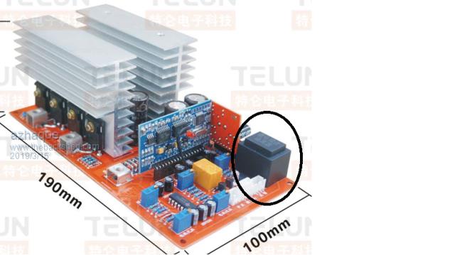

In your inverter mentioned above, is the input voltage being fed back connected to the output transformer secondary, or is there an intervening isolation transfo in between the input terminals and the main transformer secondary.
Looking at other examples on aliexpress, one finds that there are similar boards that have a small transformer on the board (see image copied below)
Are you using something like this intervening/isolation transformer?
