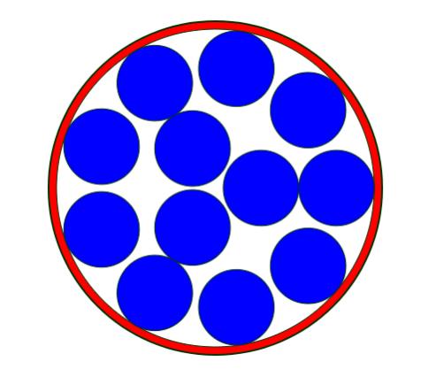

There is a curious mathematical property of circles that may come in handy knowing, when planning how many turns per layer will fit on each layer, particularly for a multilayered secondary.
As you add layers, the hole size obviously becomes smaller, and each additional layer has to fit into a rapidly shrinking circumference.
If everything is perfect, each additional layer will have room for exactly six less turns than the layer directly underneath.
If planning to wind on four secondary layers, the fourth inner layer will only have room for 24 turns less than the first layer.
Amazingly this odd effect is independent of both toroid hole size or wire diameter.
Here is a fairly dramatic picture to illustrate this with huge wire.
If nine turns will fit onto the first layer, six less turns than that are all that is going to fit onto a second layer.
With very fine wire. if 180 turns would just fit onto a first layer, expect to have room for only 174 turns on the second layer, and 168 turns on a third layer, and so on.
Prove it yourself with a bag of small washers arranged around inside the rim of something like a large paint can.
Edited by Warpspeed 2019-02-15

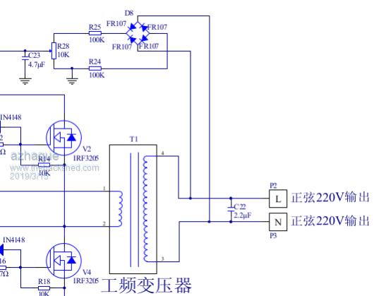

What I have learnt from the above discussion is that a choke (in series with the transformer's input leads connected to the MOSFETS) is of primary importance in reducing no-load current (thanks Clockman for that insight).
My question is therefore as follows.
Since I already have the E-I transfo built, what are the design parameters of the choke that must be added in series with the E-I core to reduce the no load current.
A bit of background. I have used a Chinese inverter board for designing my inverter. The design notes on the aliexpress website indicate that an E-I transformer would not need a series inductance choke. Now after construction of the inverter I have found that a choke is NECESSARY. I am now trying to read up on the theory of why a choke is necessary for reducing no-load current. Maybe ClockmanFr or Warpspeed or others can dilate this point further.
Additionally what is the best and most cost effective method to build such a choke. Will it be iron-cored or ferrite or air? My engineering sense tells me that Iron is out because at 150KHz or so, Iron would probably be useless. The one that is being marketed by the Chinese inverterboard maker is ferrite and its inductance is 47uH. How is this value calculated, is not mentioned on the page.
I ask these questions because I would like to add a spreadsheet for the choke design, into the transformer design excel spreadsheet. This would make the SS much more wholesome and useful for the backsheders like us.
azhaque
2019-02-16_134003_transfo5.zip
Posted: 04:56am 16 Feb 2019
O/k let's look at our large efficient inverter output transformer (toroid or E core) that probably has a step up turns ratio of about 8:1 (30v to 240v).
Its a wonderful thing at 50Hz, and if there are enough turns to keep the flux density low, the magnetizing current should remain nice and low (when driven by a 50Hz sine wave).
Now what happens if we connect this DIRECT to a very low impedance PWM switching bridge switching at 23 Khz?
The secondary of our transformer will have a lot of capacitance between turns, between layers, and between the secondary and the core. The secondary inductance will be very high, but there will be a self resonance of only a very few Khz with all that self capacitance.
The combined capacitance across the secondary is reflected back into the primary at a rate of turns ratio squared. So there will be x64 the secondary capacitance that the bridge sees as a direct load. That capacitance has to be charged and discharged 23,000 times per second.
If the transformer connects directly to the bridge there are going to be some pretty fearsome current spikes every PWM switching cycle, even with no external load on the transformer. This will definitely increase idling current, but worse, its going to really stress the mosfets as the current spikes will be almost unlimited with such a low source and load impedances.
So we fit a series choke into the primary to vastly reduce the rate of current rise each time the bridge switches.
With sufficient inductance the voltage at the bridge can switch very fast while the voltage across the transformer and its capacitance hardly changes.
You will see a very fast high frequency rail to rail waveform on one end of the choke, and a smooth 50Hz sine wave on the other end of the choke with only a very slight high frequency ripple feeding the transformer.
Now in the early days of all this inverter development, it was discovered that a ferrite choke would greatly reduce the idling current, and it will certainly do that.
The problem with ferrite is that it saturates very easily, and although it will reduce idling power, above a few amps through the choke and primary, it will saturate and have no effect at higher power.
We really need a choke that will keep on working up to full rated inverter power and ideally beyond, to greatly reduce the switching losses in the mosfet bridge. This will create far lower switching current spikes, reduce the stresses and heating on the mosfets and heatsinks, and generally improve inverter robusness and efficiency.
How big ? Well minimum might be something like 50uH would certainly work at 48v and 2-3Kw but something a fair bit larger would be better if you can arrange it. It really cannot be made too big, either in inductance or saturation current. Its rather like the decoupling electrolytics. More is always better.
When you have a really nice big non saturating high inductance choke working, it will effectively decouple the transformer from the bridge, and it allows the transformer to "do its own thing" as far as any self resonant behavior goes.
Expect to see some wobbles develop in the 50Hz waveform due to transformer self resonance, especially at zero load. With higher loading the wobbles usually become slightly less.
The wobbles are not caused by the choke, but actually indicate that the choke is working properly.
Some people get alarmed by the now distorted sine wave output, and assume fitting a much large choke is the wrong thing to do. Fixing one problem has just created another problem, but its definitely a BIG step forward fitting a large non saturating steel cored choke.
One sneaky solution to the waveform distortion is to lower the self resonant frequency of the transformer down to exactly x1.5 times the inverter frequency. That is 75Hz transformer resonance for a 50Hz inverter, and that usually takes around 4uF to 10uF across the secondary, but that varies a lot from transformer to transformer. This also sounds a bit suspect.... But try it and see, it definitely works !
The magic of exactly x1.5 times the inverter operating frequency produces a self damping effect, where any resonant buildup on one cycle will be exactly out of phase the following cycle. If its not tuned exactly right, resonant energy can build up causing even worse waveform distortion, and the inverter output voltage may do some very strange things at zero load.
Voltage feedback may lose control. But if you get the transformer tuning exactly right (ideally +/- 1Hz) after fitting a really nice large non saturating steel cored choke into the primary, a great many problems will have been solved, and you will then have a sweet running and efficient inverter with a good clean low distortion sine wave at the output.Edited by Warpspeed 2019-02-17

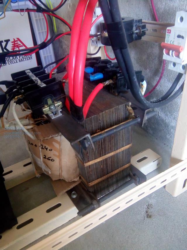

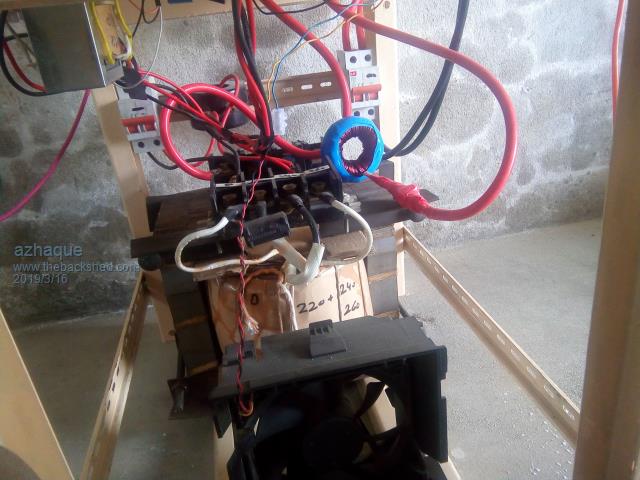

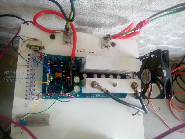

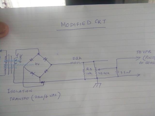

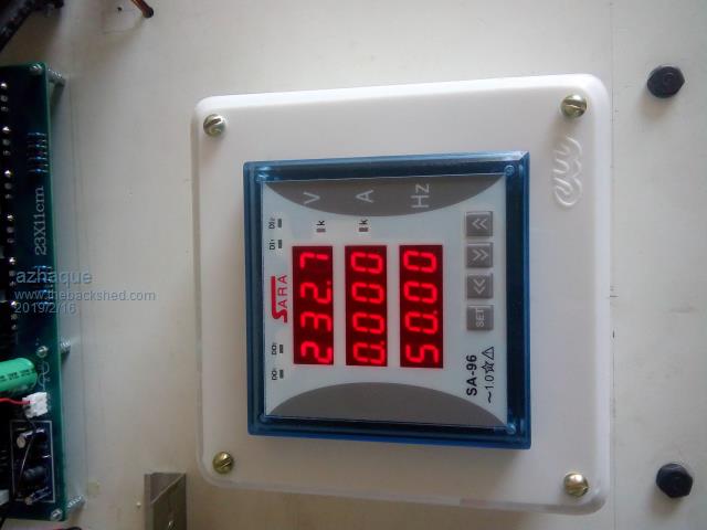

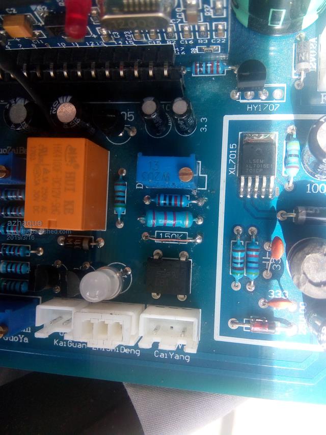

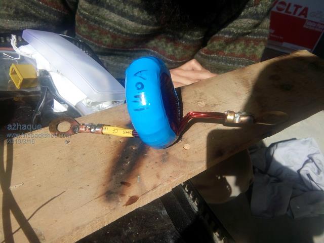

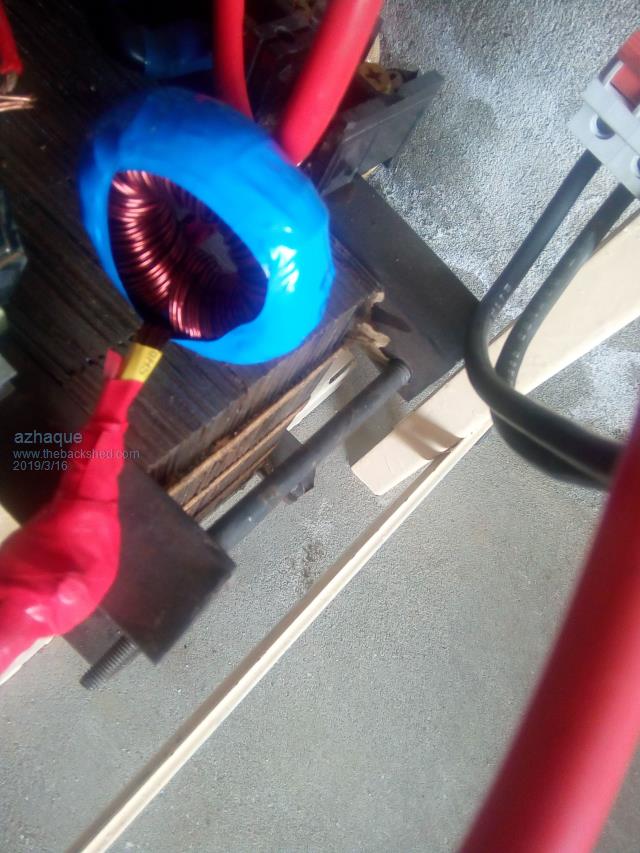

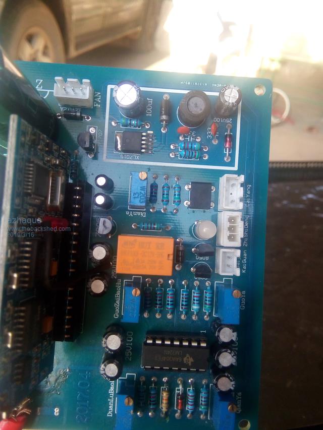

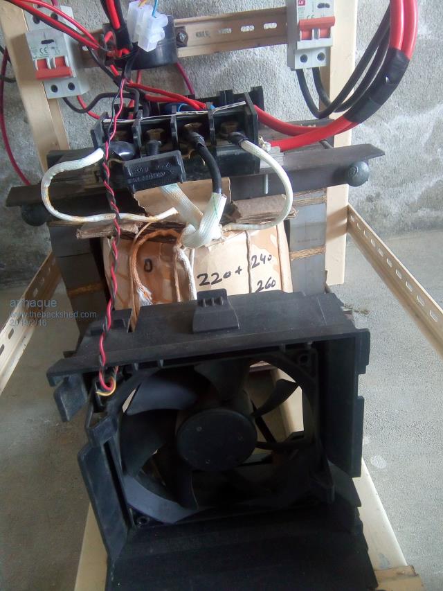

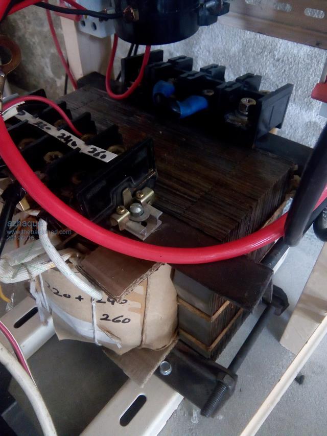

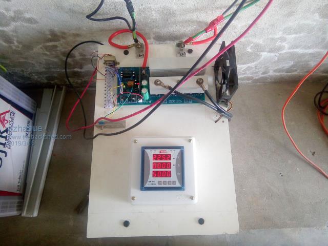

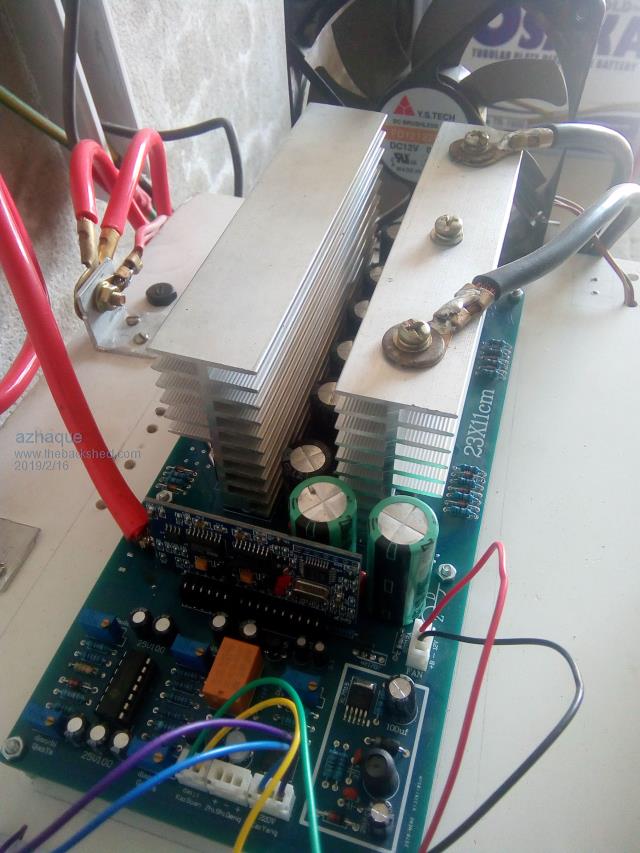

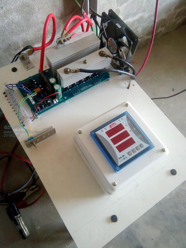

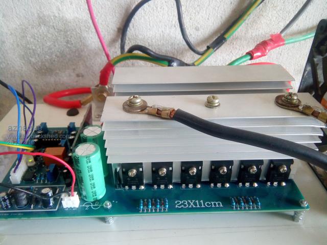

There is enuff in the above posts to take a few hours to digest. Thanks Warpspeed, Clockman et. all. Will continue on the technical aspects later. So this session for uploading video and photos only.
Youtube video of first electrons of homebrewed inverter .
The top platform with the inverter board and instrumentation.
The transformer under the top platform.
The Chinese inverter board
Volts, Amps and Hz.
Inverter Board- Side view
Transformer Cooling Fan
Transformer- Another view
Edited by azhaque 2019-02-17
