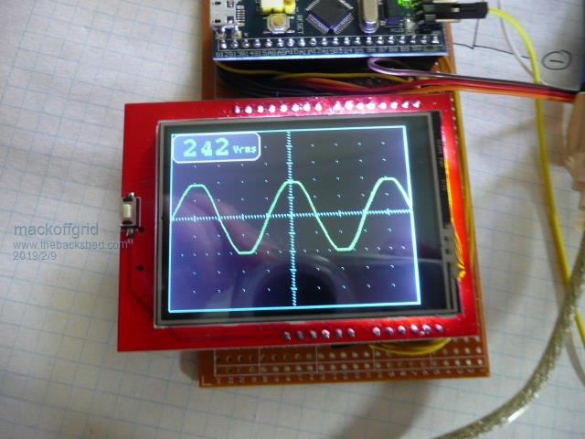

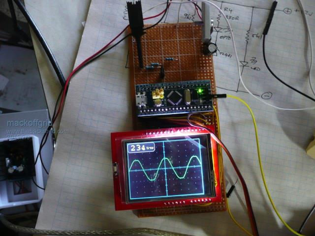

Inspired by some of Tinkers posts / photos of his DSO138 and the STM32-O-Scope I thought a dedicated, SIMPLE Scope displaying our Inverter's output waveform would be nice bit of bling.
The "Blue Pill" stm32F103C8 is only $AUD 2.50 and the 2.4' LCD is about $AUD 5.80, PCB will only be a couple of dollars.

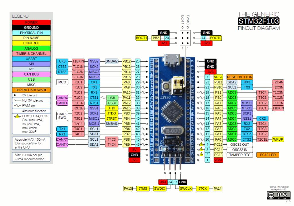

This is my first project with the STM32duino, I had to repair the BluePill, ordered the wrong programmer, got the parallel LCD instead of the SPI LCD But it all came together.

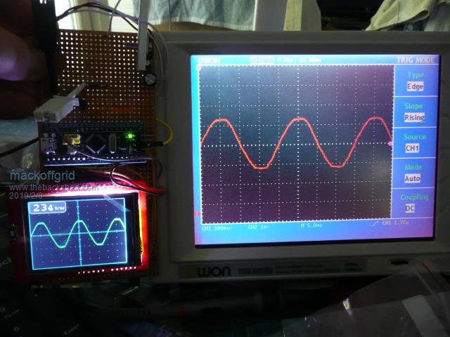

It is a fixed timebase of 5ms/div and fixed Volts per Div and fixed trigger of rising over the zero line. Its rock steady on my test of a transformer secondary.
It also has a persist feature (indefinite) or not, I thought it would be good to pick up interesting events. Having said that this is definitely not, obviously, a piece of test gear.

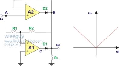

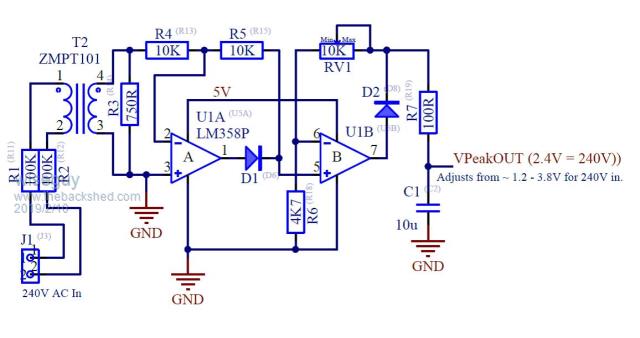

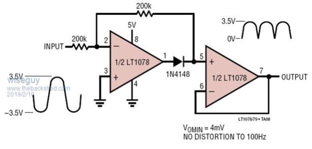

I have attached a suggested circuit for full wave amplifying and rectification of the small ZMPT101 transformer, with a Vpeak DC output. I was inspired by the second circuit but I added gain in the second stage & finally another approach in the third circuit for interest (R1 = R2). All will work ok on many single supply op amps.
I have bread-boarded it and it works fine.
The dual opamp I used is an LM358 which is cheap & will operate down to the neg rail on the input (important) as when the input of the first stage goes below ground the output goes positive with an equal and opposite level which is also fed to the second gain stage. The positive input part of the signal is passed directly to the second stage via the 2 gain setting resistors (R4,R5) as D1 is now reverse biased.
The second gain stage simply multiplies the first stage between 1 - 3 times for calibration with VR1.

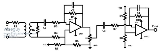

The Ali Express module PCB with amplifier is an AC output and its output appears to swing up and down from half the supply rail & for your application it should work well I think.
Sorry - I went off at a tangent as I am after DC and you are after AC but thought I would leave the rest here anyway.
Edited by wiseguy 2019-02-11
Cheers Mike

FYI here is the actual circuit which I believe is used in the Ali Express module

Thanks very much for the schematic of the aliExpress module. Saves lots of time. I couldn't build that module anywhere the price they sell them for.
Also thanks for the other reference schematics. I've several other projects where these become useful.

I have now implemented the second ADC and is running in "DUAL" mode which means that the ADC's are sampling and converting simultaneously - Cool.
The syncing is amazing solid, I leave it running in persistence mode all night and the trace just gets a little thick!

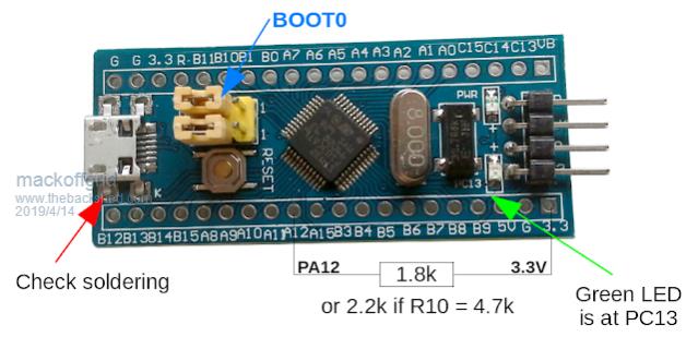

By the way, I didn't install the USB drivers.
In my haste, I soldered the pins on the "blue pill" only to find out later that a smd resister has to be replaced, its a usb pulldown I think, it needs to be 1k5 but they build them with a 10k - hard to change with the pins on. Consequently I couldn't get the USB to work - no matter don't need it.
The "blue pill" comes with a (Hard Coded, I think) serial boot loader. Its fast enough and seemed to work well.
I do like the pin numbering with stm32Duino, it uses the proper port names rather than a meaningless number.

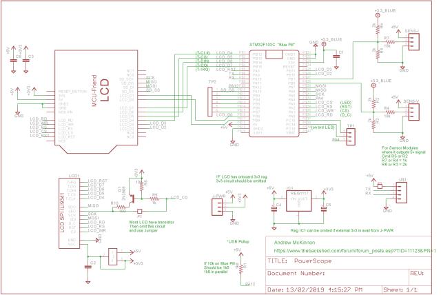

I have drawn up a schematic in Eagle.
I have included both types of LCD.
The schematic is compatible with Andrew Hull's STM-O-Scope using the SPI LCD.
2019-02-13_162302_PowerScope.pdf
Andrew
