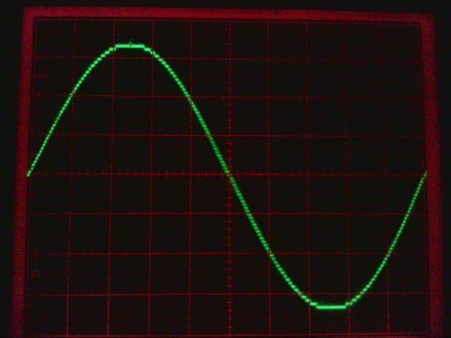

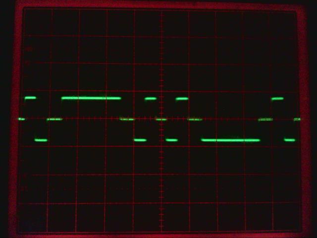

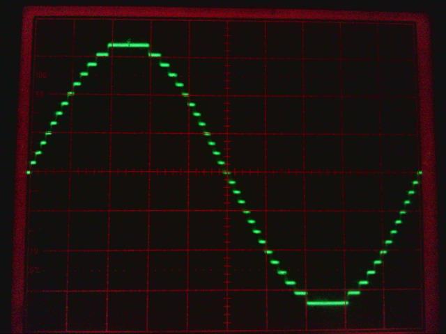

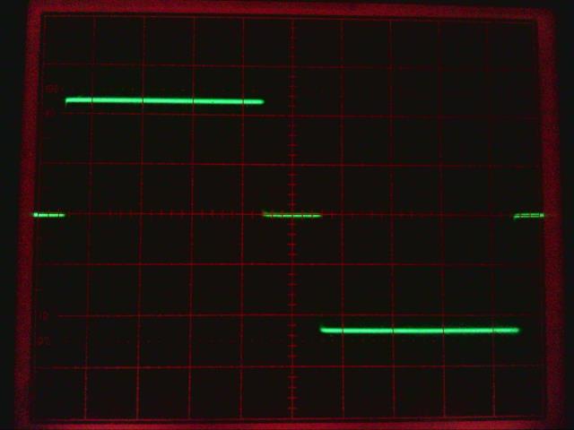

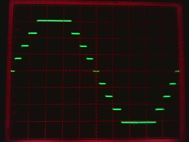

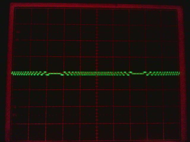

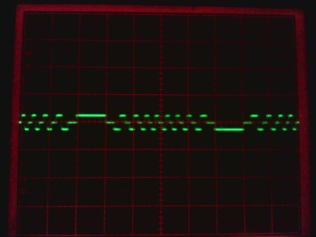

Thank you Tony for these images.
First picture is the secondary winding of the largest inverter that as a plain vanilla 225v 50Hz square wave +225v, 0V and -225v that is Inverter_1.JPG
Second picture is the secondary of the second inverter which is exactly one third of the voltage, +75v, 0v and -75v that is Inverter_2.JPG
When you look across the combined secondary outputs of both inverters, a really interesting thing happens. See Inverter_1_2 .JPG
Inverter three looks like this, and is one ninth of the voltage +25v, 0v and -25v see Inverter_3.JPG
Three inverters in series looks like this with 27 steps peak to peak (3x3x3) see Inverter_1_2_3 .JPG
The final act is all four inverters connected in series and 81 steps peak to peak which has less than 1% total harmonic distortion Inverter_1_2_3_4.jpg
Follow that with a fairly low 20Khz cutoff frequency EMC filter and all those tiny ripples are GONE !

Posted: 11:26pm 05 Feb 2019
Thank you Natasha for posting my waveforms and explaining that using the # hashtag as a file name for HTTP is a definite no no.
My file names were "Inverter #1.JPG" for example, and that ignorance is what brought me undone.
Choice of exact transformer voltage ratios primary/secondary is made a lot simpler if whole integer volts are used on both sides, to work out the turns ratios when designing the transformers.
If you add 225v + 75v +25v + 8.33v you get 333.33 volts peak which is an easy number to remember. That produces 235.7 volts rms which should be a workable starting point in most parts of the world. If voltage regulation is added later on, tweaking the exact output voltage can then be done with a potentiometer.
The one big disadvantage of this type of inverter is the requirement for four special transformers, which you will probably have to wind yourself.
Its the cost of the transformers that has also kept this method from becoming popular commercially, although there have been some on the market from time to time.
Its not my invention, just old technology revisited.
At very high power levels say several tens of Kw up to Megawatt power levels, its really the only practical way to turn dc into ac electronically without rotating machinery.
For us, PWM has more attraction because its simpler and uses fewer parts. But switching at 50Hz is FIVE HUNDRED times slower than switching at 25Khz, and many of the noise and physical layout problems make PWM a much more difficult challenge for the novice home constructor, especially at the high power levels.
It can be done, but its not as easy as many people expect, and it gets more difficult as the power level and switching frequency rises.
Anyhow, the easiest approach to generating the stepped waveforms is from a simple lookup table. A lookup table with 1,024 addresses can have a time resolution of 20uS with a 20mS (50Hz) output sine wave which is plenty. Each inverter requires two data bits which just switch on and off as required, in the correct switching sequence.
For instance, the positive peak would be all inverters switch on +ve in the same direction and the data to do that could be 1010 1010 for four inverters.
All inverters off at the zero crossing would be data 0000 0000.
The negative peak would be data 0101 0101.
Now to generate a normal sine wave lookup table we usually wish to know the amplitude, and we already know that the angle (lookup table address) advances constantly.
This is different, we know the step amplitudes which correspond to the actual dc input voltage to the inverter.
What we wish to find are the angles where those amplitudes are crossed, and switch as close as possible while introducing minimal error into the process. That enables us to program our on and off times with 20uS time resolution.
To do that we use an arcsin table to convert amplitude to degrees or radians. There are arcsin calculators available on the internet, and you only need to work out values for the first ninety degrees (256 lookup table values).
One lookup table will then give you a working inverter which is a very big step forward.
To regulate the output voltage, we can use multiple lookup tables and switch between those at the zero crossing point. If we make every step very slightly narrower, that would reduce the ac output amplitude very slightly with very fine control of amplitude for any given dc input voltage powering the inverter.
By having multiple lookup tables, we can very smoothly crank the output voltage up and down seamlessly. My own inverter has 256 different lookup tables, each 1K with a 2:1 dc input voltage range.
I am sure it could all be done with a microprocessor in real time, but it all becomes very time critical. I overcame the time criticality by using a dual port ram, but it all became unnecessarily large and complex.
A bunch of lookup tables in an EEPROM is fast, simple, and reasonably easy to get going. The LSBs are continuously clocked sequentially by a counter. The high order MSBs are selected by an analog to digital converter. The analog input voltage just scrolls through the lookup tables to adjust output amplitude.
I started out with a microcontroller and eventually gave up in doing it all in real time. I just added an EEPROM burning sub routine to the same program and let it loose filling in all of the 256 lookup tables, which took a couple of minutes.
This is just a fairly quick overview of how its all supposed to work.
Edited by Warpspeed 2019-02-07

I am wondering about trying this with old microwave oven transformers.
They would need the old secondary and magnetic shunt removed of course. The old
primary could be used as the output (secondary), a new primary should be easy enough to wind as it will only have a few dozen turns. I guess say 700 watts from the first transformer, and so on, to a total between 1.5 and 2 kW output ? A fair
bit of effort but really low cost (and a good way to recycle)... Maybe two could be wound in parallel as one, to increase power on the first stage (?) I don't know how efficient they are though, maybe they'd waste too much power.
Posted: 04:53pm 07 Feb 2019
Microwave oven transformers usually run at extremely high flux density and often have aluminium windings. The laminations are commonly welded up, so its not really possible to dismantle the transformer. Microwave oven transformers while pretty easy to find, are not really ideal material to work with.
They might have possibilities for the smallest transformer, if run at much reduced power. The voltages on both primary and secondary would both be low requiring few turns so winding it would not be too frustrating.
Once anyone has some definite plans and some transformer parts to play around with, I can provide some design guidance if required.
Probably the best way to to begin is to cobble together any old junk you can find, get that working, and concentrate on getting the drive waveforms and the electronics sorted out. By that stage you will have some experience and some definite ideas on where to go from there.
If you wish to start by playing around with just some ideas in software, you could make a "virtual" inverter without needing any mosfets or transformers.
If you generate all the required on/off gate driver waveforms, feed those into a 256 x 256 bit lookup table to convert the gate drives into numeric values. That can go into a digital to analog converter and the output will be a beautiful stepped waveform. The whole thing can be put together on a breadboard and you can view the analog output on an oscilloscope. That is much easier than building four bridge inverters and winding four transformers.
For me, the most difficult part of all this was generating the switching waveforms in software. I am not too good at that type of thing, but for the software guys it should all be a lot more straightforward.
