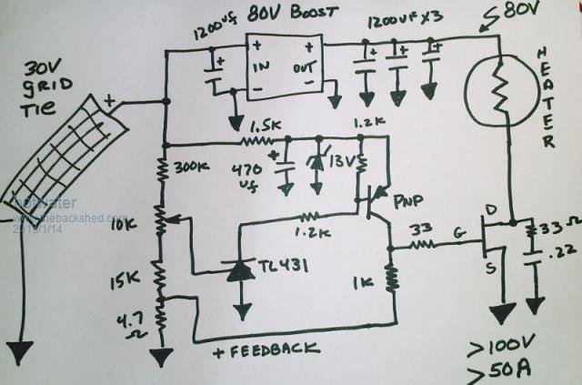

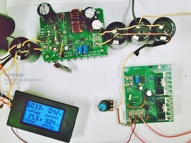

I actually do this with a slightly different boost converter into a water heater. The trick is to maintain the input voltage at near power point. I sense the input voltage with a TL431. When voltage drops below 30V, it fakes the boost converters controller chip into thinking the output voltage is higher than it should be and starts driving the controller off. I have a zener that limits the TL431 to 6.3V. The voltage sense pot trip point of boost is about 2.5v and the 431 can clamp to about 2V. An LED connects the two and that voltage offset provided by the LED makes it work and provide a visual indication of it going into limit. You ain't going nowhere with what you have set up.
The heater resistor can never drop below the panels voltage as it is basically a diode drop pass thru. That means a high load on the panels till you reach a panel output of 60 or more watts.Edited by hotwater 2019-01-13

  hotwater said   I actually do this with a slightly different boost converter into a water heater. The trick is to maintain the input voltage at near power point. I sense the input voltage with a TL431. When voltage drops below 30V, it fakes the boost converters controller chip into thinking the output voltage is higher than it should be and starts driving the controller off. I have a zener that limits the TL431 to 6.3V. The voltage sense pot trip point of boost is about 2.5v and the 431 can clamp to about 2V. An LED connects the two and that voltage offset provided by the LED makes it work and provide a visual indication of it going into limit. You ain't going nowhere with what you have set up.
Exactly!

But, hopefully when I introduce Vout control with the microprocessor I will. Or, do you see a fatal flaw?
No you actually have to monitor Vin. Connect the panels directly to the boost converter. Add extra capacitance to the input and output to handle the pulsing current.
The boost converter only draws about 50ma once the caps are charged so it can be left to free run. Monitor the input voltage and control the output pulse to heater to maintain voltage. If rate is kept under a couple hundred HZ the FET driving is pretty simple. Don't even need a micro, but I love them.

Having full MPPT tracking doesn't really matter much as this is temperature dependent. Changing the power point voltage a couple of times a year is sufficient. It also affords the opportunity to operate the system in parallel with a charge controller for harvesting wasted energy. A bust or buck converter on a solar panel alon will quickly put the panel into a death spiral.
For your edification and amusement, this is something I whipped together from whatever parts were handy. t seems to work well. Needs extra capacitance on the input and a couple of FET parallel on the output. 75N75 are cheap and plentiful as are IRF540.

Its fine but highly dependent on the characteristics of the boost converter, like how much insolation does it require to start up and successfully charge the output capacitance and how low can it go (all part of the OP's original problem) :)
It is not true to say Vmpp is only temperature dependent as it is also insolation and therefore load dependent however as an approximation it may be good enough depending upon your requirements. Temperature itself can vary a lot between the early morning hours and midday sun at full power.

Th OP's problem is that the boost converter in an effort to satisfy the output demands puts the panel into a death spiral. These boost converters will start up easily if they can e supplied with less than a couple watts from the panel.
I've been testing this for years and power is fairly insensitive around a fixed power point voltage. It just doesn't matter that much in real life. It is easy for people to think that MPPT is wonderful. There is always a cost to tracking and that makes many MPPT algorithms suck. Constant voltage is very fast in responding to clouds and not wasting power. As a total system, constant voltage performs pretty well. I can't print what I think of many MPPT controllers.Edited by hotwater 2019-01-16

OK on what happens as I drop below about 100W on the panel. My attention was focused on all the wasted power from 100 to about 500W! One of those boost inverters will run at about 500Watts output (fan duty cycle 50/50). At 600 Watts the fan is running all the time.
The final implementation will have two of these boost supplies each one feeding an 18 Ohm element. This will give me a power range of 30V * 30V / 18 Ohms = 50W to a maximum of 1000Watts.
hotwater,
Thanks for the schematic ... looks like it was designed for my panels and SMPS :) I have those other bits. Basically, it turns off the load at low power levels, right?
The SMPS I am using has a low voltage disconnect FET in it, which I have set at 25Volts, hopefully it will perform the same function.
The controller gives me 5 voltage levels, 33, 43, 53, 61 and 70Volts. The code just selects the highest voltage to keep the panel voltage above 30V. It changes one step per second ... I may need to speed that up.
Now, we just need some sun!
