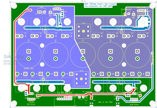

Our temporary off grid project for a garden center is now running in limited capacity 24 volt form until the full project can be built and assembled into a container, which I'm still waiting to arrive, along with the 20 remaining 300 Ah 6V lead carbon batteries.
At least we have some off grid power, managed to pickup a Honda DC generator for charging the batteries during cloudy weather, it has a 140 Amp DC 24V alternator fitted with a fancy Balmar microprocessor controller, all seems to be working fine and easily adjusted to limit charge current to 60a with the small number of temp batteries.
However when the 48v bank is finally made up later next year I will require a higher output voltage and I don't want to pull the alternator to bits and alter it; so planning to make a high freq voltage power doubler using some large ferrite cores and HF rectifier. Basically an DC to DC H-Bridge HF transformer + rectifier stepping up the voltage to match the batteries. Thought perhaps a simple push-pull would work and it probably would, but uses more wire, so bigger cores are required, which I dont have.

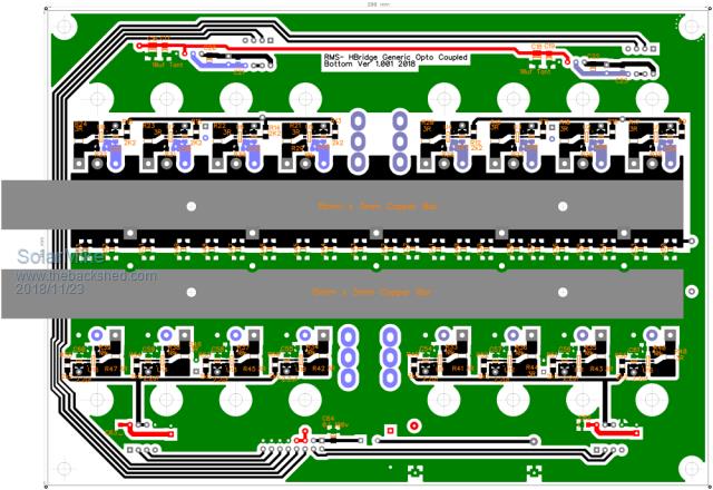

Thus the layout below, sorry no schema, I just built the pcb design as is, thought would just build a generic opto-coupled H-Bridge that can also be used as an inverter. 4 mosfets on each leg, they are mounted under the board on an alloy plate for heat sinking, each device has its own driver chip. Copper bars are soldered along the +- rails. Plug a cpu board into it to suit whatever function is required. Cannot wait to try out Poida's Nanoverter driver on it with a toroidal core.
Bottom: Have colored some power nets to see better any errors. Size is 200mm x 146mm.
Top:
