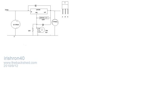

Hi everyone, I am baffeled by the voltage drop under load.
Load is 2.3A and @ startup it draws 2.7A.
my transformer is able for 10 amp
Rectifier is rated 25 Amp
with no load it reads 14.8V
with load voltage drops till 4 volt before ic is getting warm
the lm338 is fitted on large heatsink
I have tried different lm338 and caps
thank you

whats wrong with this drawing

What voltage are you trying to get, and what is your input voltage? The input to these types of regulators need to be a MINIMUM of 3volts above the output. Otherwise the regulator is in saturation and won't control. Also, as a rule of thumb, the output capacitors should be 10uF per amp drawn.

thx Pete. I am building a hotwire foam cutter.
The wire I use is ni-chrome.
MY INPUT VOLTAGE IS ABOUT 17VOLT
DIODES ARE RATED 3A THINK THEY ARE 1N5401
i LIKE TO REGULATE MY OUTPUT FROM 5-12 VOLT
I JUST CANT SEE WHAT I DID WRONG WITH THIS CIRCUIT UNLESS LIKE YOU SAID IT COLD BE CAP SIZES.

Posted: 05:36am 12 Sep 2018
  irishron40 said   whats wrong with this drawing
It's literally the size of a postage stamp. even zooming right in it is barely readable.
Posted: 06:53am 12 Sep 2018
The drawing is rather small...

17v input, 14v output, 2.7A current.
Regulator is trying to dissipate: (17-14) x 2.7 = 8.1 Watts of heat - that's a lot for a TO220 package. I can't remember what the 338 is rated for, but I seem to recall all those linear regulators are 5W devices. I may well be wrong. I will now have to dig up the PDF so I can find out.

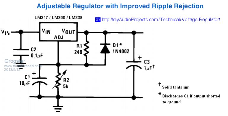

Why do you have a 10k/12k(can't read it) between ADJ and GND?
Why not just the pot? That is probably part of your problem. I don't normally have an additional resistor there...
Most adjustable regulator circuits have the 220/240 Ohm from output to adj, and a resistor from ADJ to ground to set the voltage. A variable regulator usually uses around 5k pot between ADJ and GND to vary the voltage.
You should also be using 100n caps in parallel with your electrolytic caps. The 100n's filter off any high-frequency noise that might upset the stability of the regulator. Not quite so critical on the output of the regulator, but I always put one on the input and output just to be safe.
Google Images is your friend:

Data Sheets Here
It may be getting too hot as G mentioned. Probably don't really need the big C on the output.
I assume you've checked the protection diodes (Orientation etc)
Should work unless a dud

I WAS WONDERING FOR JST SCH A SIMPLE CIRCUIT. MUST TRY A 317 FOR THE CRAIC
i ONLY WANT THIS TO HEAT UP A NICHROME WIRE FOR CUTTING FOAM AND FOR BENDING PERSPEX.
i WANNA REGLATE IT AS FOR CUTTING FOAM I NEED LESS HEAT THE FOR BENDING PERSPEX.
I MADE CIRCUIT BIGGER. I WONDER DO i NEED ANY CAPS AT ALL.
RON

Posted: 09:17am 12 Sep 2018
Yes, you do.
You need at least SOME kind of caps on the input, and usually, some on the output.
As you are only running a resistor as a load(your wire), then you can probably ignore the output cap as Warpspeed says. But you still need some input caps. In your application, I would tend to go for 2200uF and 100n on the input, and nothing on the output as your load is purely resistive.
