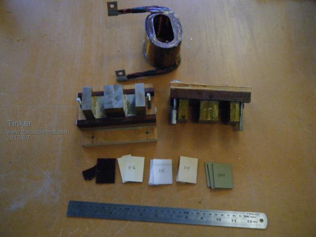

In the three 3KW Aerosharp inverters I took apart there were three big chokes. Two were smaller than the one large one.
While the coils on these are useless for the inverters being built here, the C- cores certainly are very useful as I found when testing some with inverter #4.
The core is made from some very thin, sharp flaky material and requires caution when handling.
I had written elsewhere how best to get these chokes apart to remove the existing coil but my last one refused to come apart by that method.
So I slow cooked it at around 100 degrees C in an old oven, it softened the varnish and it disassembled easily.

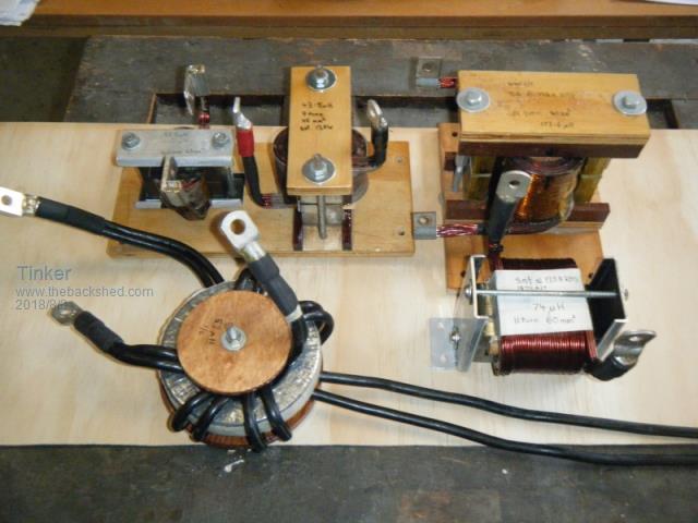

Anyway, I ended up making 5 different chokes for testing which one works best, and the result was surprising - to me.
On the picture above, on the left, back row, is the usual E65 ferrite choke that was recommended by the original inverter builders. It has 4 turns of 63mm sq. L=53.8uH
Left front row is a ferrite ring core with 2x3 turns of 40mm sq wire (2x20 in parallel).
L=56.3uH for each coil.
Center, back row, is a choke made from 2 sets of the smaller Aerosharp choke, the C cores arranged to form an E core. It has 9 turns of 45mm sq and a 2mm air gap. L=43.5uH.
Right, back row, is a choke made from 2 sets of the larger Aerosharp choke, similarly arranged as above. It has 18 turns of 40mm sq and a 2mm air gap. L=174uH.
Front row, right, is my latest choke, made from a single large Aerosharp choke. This one has 11 turns of 60mm sq, a 1mm air gap and L=74uH.

So to continue my experiment I fitted the single large ex Aerosharp choke (silicon steel as you say) with 11 turns of 60mmsq wire into my big dual core toroid inverter. I set the gap at 0.8mm.
I prefer bigger wire cross sections for the high currents even if the wire length is only from 2.5 - 3m. I wind these coils using three wires of 1.8mm dia. enameled wire, wound simultaneously and can fit 11 turns in the 70mm space available. There are 8 parallel layers of that, adding up to the total of 60mm sq.
This makes max available space usage and could not be done with round insulated cable of the same specs. Besides, I have a stack of that wire left over from the original Aerosharp toroid just begging for a use .
This choke measured 74uH and saturated at 120 Amp RMS. A bit low but still good for almost 6.5KW.

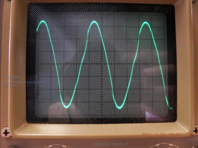

This is the trace at idle. Idle being 35W of which 3W go to the displays of the V/A/W/KWh and the fan temperature controller.
Note there is a small wiggle in the up slope but no zero crossing kink. If there were a ferrite choke as well it would have that zero crossing kink.

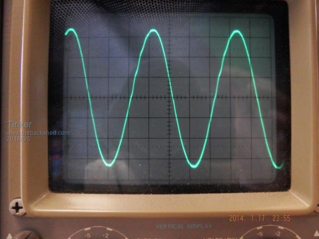

And this is the trace with a 5.3KW load (100 Amps from my battery).
Note there again is no zero crossing kink.
I had experimented with my dual large aero C core choke which has 18 turns of 40mm sq wire and a 2.5mm gap. It measured 174uH which is good but the trace from it was not so good looking.
So I'm going to wind another coil for the dual large C with just 11 turns, 60 mm sq wire. Doing some testing with my 125 turn test coil for this core I can get the saturation RMS Amps up past 150 with a 1.5mm gap. If the inductance gets above 100uH with that it will get fitted in my dual toroid core inverter. The single C core choke can then fit into my spare single toroid core inverter.
I got that choke coil winding sussed out by now too but making the rigid coil former takes more time than winding the 8 layers. Perhaps I should start selling these coils, the labor contend would have to be free though .
No ferrite chokes any more for me.
I suppose we had them because the pioneers of these inverter conversion found ferrite chokes good for reducing the very high idle current of the PJ inverters.
And everybody seems to have followed that idea since...

About that "kink", my large double core inverter does have a good electrostatic screen. That might explain why its not present on this inverter but 'is' visible on my smaller test inverter which has no such screen. I just was not aware what could have caused it.
About the "wiggles", my large double core was very carefully tuned to 75 Hz resonance. This was much more obvious to see here than on the smaller test core.
I fitted 4.6uF, had to improvise with what caps I had on hand.
From what little of the "wiggles" is left now under load, I can live with that.

In the picture below I show how I arranged the two C core halves, bedded in epoxy, to make a rigid E core so the lot can be clamped together easily.
In the foreground are the various gap spacers I selected for different gap sizes.
From left to right, 0.9mm bakelite, 1.2mm plastic, 1.5mm plastic, 1.9mm model aircraft ply, 2.4mm (3 layers of formica superglued together.
Many other materials might be suitable, I used what I had in my shed.
In the background is that 18 turn coil I mentioned earlier in this thread. I'm going to make another one as this one has the connecting lugs arranged so it won't fit into my inverter.
So here are my test results for the pictured choke which might give a good ball park figure to those who do not have a suitable test coil nor the required saturation test equipment.
Dual large C core choke (cores ex Aerosharp)
Core X area 33x45 = 1485mm sq. Area available for the coil 20 x 70 mm
Saturation occurred with
no air gap: 625A/t
0.9mm gap: 1562.5A/t
1.2mm gap: 1875A/t
1.5mm gap: 2625A/t
1.9mm gap: 3125A/t
2.5mm gap:3750A/t
Keep in mind that I had read these values off the graduations on my oscilloscope screen, alas it has no fancy digital value display.
Also, it applies *only* to that particular core material, other cores, even if the same cross section, are likely quite different.
These currents are the peak values. For the equivalent RMS power calculation divide the A/t by 1.414.
Example: 1.5mm gap, 2625A/t, 18 turn coil = 2625/18 = 145.83A peak = 103.3A RMS.
103.3A RMS at 55V battery voltage means at 5672W RMS power draw from the battery the choke begins to saturate.
As there are losses involved I would limit that inverter for a steady 240V 5.5KW power draw.
If things like fridges, motors etc are plugged in the steady draw should be quite a bit less since the start up current of motors can be 10 times higher (briefly) than the running current.
Next post is the same test with two C cores of the smaller Aerosharp choke. As there are two of these in each Aerosharp it might be useful for the single toroid inverter builders.
I plan to have one of each arrangement with max # of turns & optimal copper cross section. Testing of these later.
Edited by Tinker 2018-08-08

I have now finished a new winding former for that twin large C core choke, the old one gave me trouble extracting the finished coil.
Anyway, from my calculations I should just fit 17 turns of twin 1.8mm dia enamel wire on it. Also 10 layers of that, so 5mm sq x 10 gives me the same 50mm sq area than the copper sheet idea.
2 wires side by side is about the minimum that can be securely clamped at the start. The last coil had 3 wires side by side which clamped nicely. A single wire would result in 34 turns at 25mm sq with this method but clamping the start would be difficult.
Its not enough to wrap the start around something, it must be clamped very well for to wind a tight coil on the lathe a fair bit of toolpost 'brake' is required.
The new coil will take a while, can only do one layer a day. It should have above 150uH, I'm planning to use the 1.9mm core gap.
