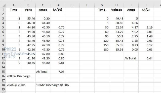

Can probably extend the batteries out with a couple of Anderson leads I use for camping, but they are a few metres long.
Still suspect the Charge/monitoring though as I don't see what I could really consider a bulk charge.
Left table relates to discharge, right to recharge.
7 Ah out on discharge seems pretty realistic, considering it's at 40+A, not the rated 1A.
But charge back in only accumulated to about 6Ah, & voltage is more what I'd consider a float than bulk charge level.
seems like a perfectly normal scenario for a UPS, if you dont have daily power failures it has endless hours to reach full charge, if you wind the voltage up it will cook and corrode the batteries.
car alternators are made to charge the same way.
