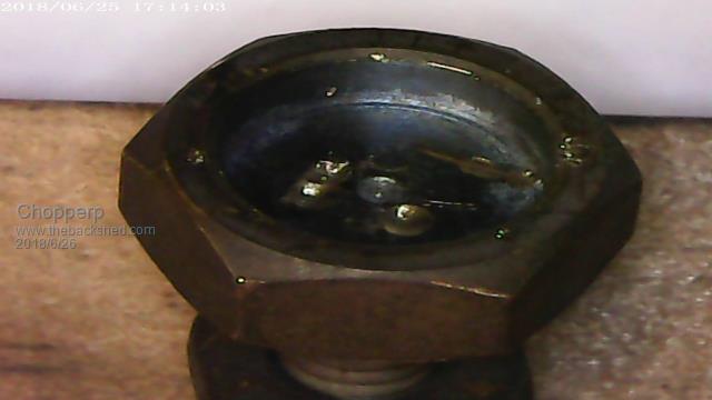

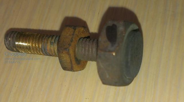

I'm working on a couple of old GE voltage / current regulators out of diesel-electric locos. The regulating relays fixed contacts (4 in total) are carbon tipped & most are badly worn (see photo).
Does anyone know if they can be refurbished or not? Mr Google or Mr Bing haven't been much help.

What you want are carbon contacts, not carbon brushes, but the two are sort of related. Many shapes and sizes, many different grades (hardness) of carbon.
Remember the old "Scope" soldering irons with a push to heat carbon heating element ?
Try Googling carbon brushes...
There are many companies that specialize in making replacement carbon brushes for all kinds of motors and generators, and related things such as carbon contacts.
I am sure they might either have something suitable, or can make something up for you, or at the very least give you some excellent advise.

I used to go to most of the QR Railway Auctions, pick up some goodies at times, last one I went to they had a large box/vat full of used and or unwanted motor & generator brushes and possibly some of those in there as well, all went for scrap.
Looks like that brass bolt has a recess turned in and the carbon sits in a little then the brass might be rolled around the top, just enough to grip the carbon insert?
I could well be wrong but thats all I could guess.
It would have to be good quality carbon too, unlike the stuff they have in cheap power tools.

At Revlac. Drilled into the carbon bit. goes down about half way or ~3mm

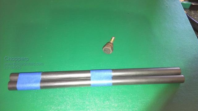

Have you tried the EDM carbon ,which is a special hardness used for EDM sinking machines
It is relatively hard and easily machined, if you cannot get some locally I think there is still some round bar in the shed that you are welcome too.

Found this. At 10mm, it's ~0.5mm bigger than what I want (0.375" or 9.525mm). Cheap enough to try.
You mentioned that it was easily machined so I assume it be turned down & cut to length in a lathe?
EDM Rod

Yes you can machine with a lathe or a milling machine(beware that it puts carbon dust every where) It is a especially fine grained
And a very good conductor, it usually machined the male shape, then a controlled current, sparks the metal away electron by electron to form the female shape for injection molding.

Would this stuff be better? A more expensive, longer, but the right diameter.
More Rods

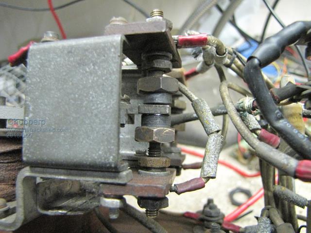

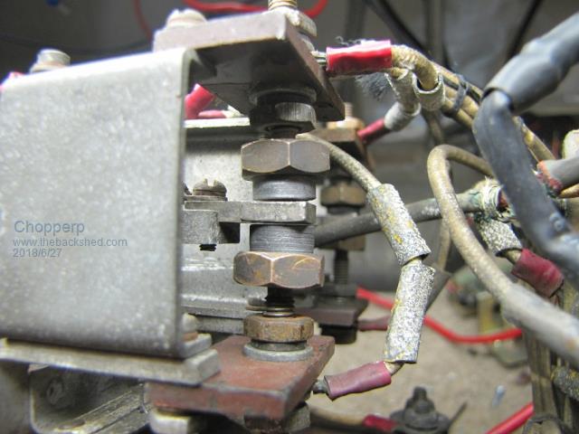

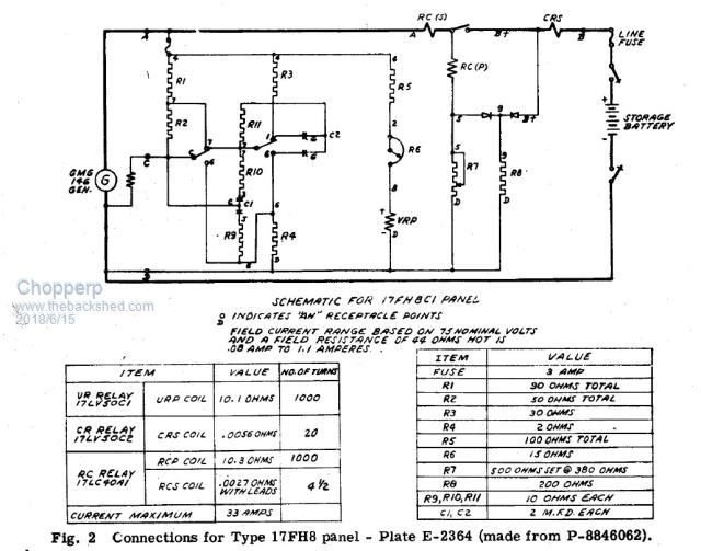

John,

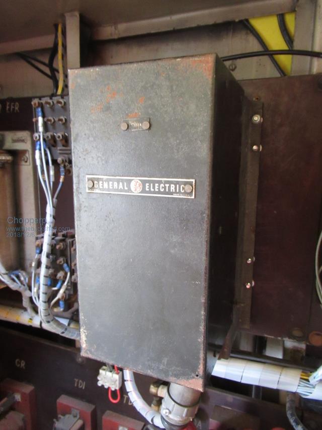

Circuit & unit image below. Hope it is clear enough.
The current relay CR, is on the far left of the circuit & VR, the voltage relay is on it's right. (The cutout is at the top). There are some suppression capacitors with series resistors across the contacts which make the drawing even more confusing (for me anyway).
There's only about 0.5 - 1.3A switched on & off through the field coil by the relays when regulating but it operates at about 70V which can cause a bit of arcing if not set up correctly. The relays are quite finely balanced when limiting.
The contacts themselves are a pain in the butt to replace & setting the unit back up again is even worse. (Require 70V+ for the volts & 33A+ for the current).
The Loco is for a Heritage railway, so will not be in continuous operation so the cheaper ones may do for the time being.
Regards Brian

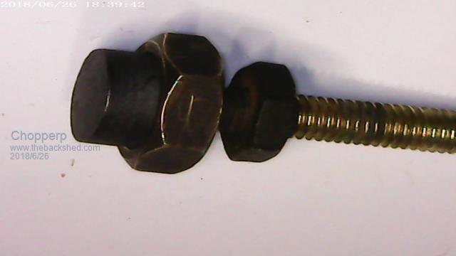

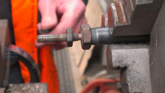

It looks to me like you need 3/8" Dia Graphite rod.. is 10mm too big in practice?
The way I would go about replacing those is to use a lathe and bore into the head of the Brass screw a few mm.. The bore needs to be probably about 1-2 thou (0.001-0.002") smaller in dia than the carbon rod..
Heat the screw up in an oven (Or blow torch) the rod should be able to be pressed home and when the screw cools down the rod should be held fast without glue etc..
Just machine the face to size and resurface smooth (I have never machined graphite rod so I am not sure of the best methods here).
You would then end up with nice `original' looking replacement contactors..
It has been 33 years since my `toolmaker days' but that seems a pretty simple task for a machine shop to perform. Tell them you are a hobbyist restoring historic trains and they might do a cheap cash job for you.
I assume the carbon was to prevent pitting of the contacts..?

I measured the existing contact at 0.375" (3/8"). I think it goes into the bolt head about 3mm. 10mm is only about 0.5mm bigger. The idea of heating it up is a good one. I don't particularly want to experiment with one that still has a bit of life in it but I will have to.
I think carbon is used because the contacts can be switching quite rapidly and the actual contact force can be quite low. The alloy armature contact faces still pit quite a bit.
I found that company yesterday while searching. Didn't look too "friendly" to me so I didn't look very hard but I will have another look. We do have a lathe so machining shouldn't be a problem.

The carbon to bolt head attachment in your initial picture , looks to me that it has been rolled over the carbon , which is easy to do with a roller wheel instead off a tool. maybe the bolt end of the carbon has a step a little larger to roll the metal over the carbon end.
just a idea john
