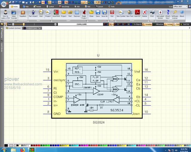

A little DEX experimentation, adding the internals of a switch mode power supply IC to the part, so that in the schematic my failing memory has a reminder to what is inside as block schematic. Sounded like a good idea but did not work yet, following up on the DEX forum hoping for positive outcome. Here is a picture of what I am doing:
Keep in mind, the schematic can be fanciful to degree, I can build a circuit around this as the pin outs are correct and block schema will make for easy reading, the printed circuit board in due time will not care about this presentation, the foot print will be right. Edited by plover 2018-06-19
