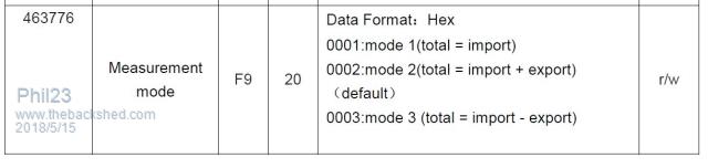

Any thoughts on how I write one of the Holding Registers in my Eastron meters?
I want to change a config setting that's not accessible via the device menus.
If I read it I can see it's currently Mode2, I want it in Mode1.
This is the requests & responses I get.
[Code]This is the read & response.
[RTU]>Tx > 06:45:26:297 - 01 03 F9 20 00 02 F5 5D
[RTU]>Rx > 06:45:26:329 - 01 03 04 00 02 00 00 5B F3
And the Write Attempt.
[RTU]>Tx > 06:45:36:359 - 01 10 F9 20 00 02 04 00 02 00 00 3E 23
[RTU]>Rx > 06:45:36:391 - 01 90 01 8D C0
Sys > 06:45:36:391 - Error : Illegal function[/code]
I was suspecting it's password protected, as the setup menu is.
No mention in the Modbus protocol document though.

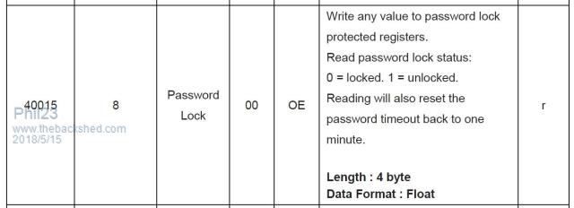

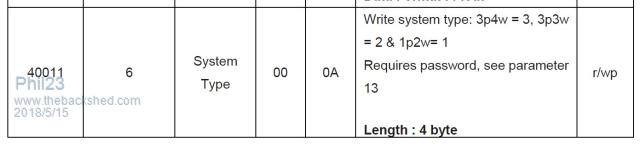

Found a few hints in the SDM630 3 phase manual though.
And also the parameters that I think allow it to operate as a 3 channel single phase meter.
They mention it requires a password, but I'd expect a lot of the other parameters would too.
Makes sense if the device's setup mode is P/W protected, so too should all the registers that related to configuration.
They then mention these two commands, but don't say what the data type is on the P/W that allows writes.
Have also had a look at the code in the Arduino Library for these meters, but I can't see anywhere that's using any of the password related registers.
