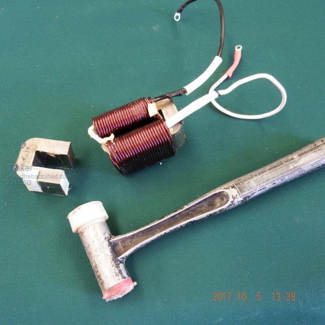

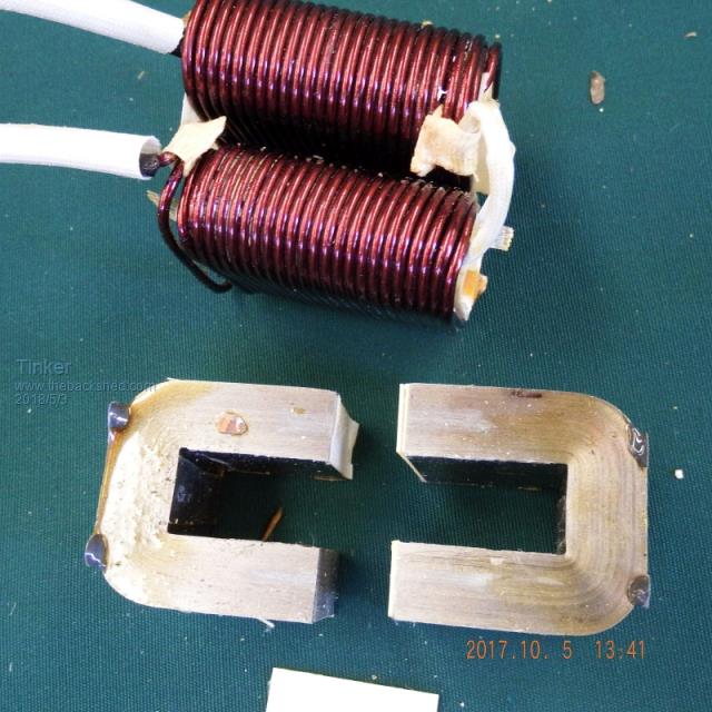

The Aerosharp inverter has two smaller and one larger C core non saturating choke in in which can be re wound for the higher currents our inverters run at.
I did convert both of these chokes but found two of the smaller ones assembled into an E core did make a very useful non saturating choke without becoming too big physically.
Using the two cores side by side allows for a bigger cross section coil which is much easier to wind.
First job is to remove the core halves undamaged from the original. The core material is quite fragile so great care is required.
I started by removing the stubborn screws bolting the endplates together. The nuts must be heated quite hot - I used a small blow torch - and then its easy to unscrew them.
Next, using a soft faced hammer and holding the choke in the hand tap one protruding core half side on. Repeat with other side and other core end until it is loose and can be pulled out of the winding. The cores have a 2.5mm plastic 'air gap' spacer so they separate relatively easily.
My cores had matching marks (faint white lines) on one side, these aid in re assembling them the same way. The mating surfaces need to be cleaned carefully, also the core part that sits inside the coil.

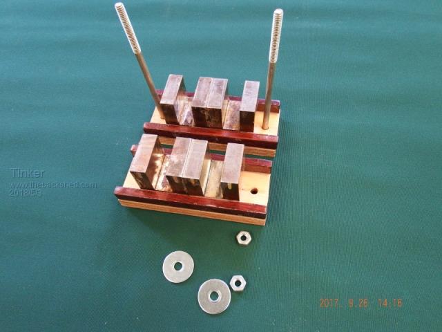

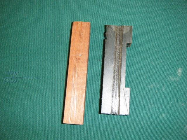

Then they were epoxied onto a plywood base with hardwood guide strips on each side.
Make sure the mating surfaces line up flat & clamp them lightly that way until the epoxy hardens. There should be 2 identical E cores with the matching lines aligning.

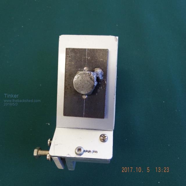

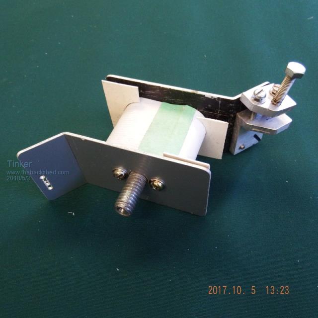

Now a winding jig needs to be made. I wound my coils 3 in hand simultaneously, this requires a sturdy jig. Most importantly, the wire end needs to be able to be clamped very well or they will pull out.
To stop the jig slipping in the lathe chuck I used a bolt head for the chuck jaws to clamp on.
To clamp the 3 wires with some friction in the tool post I used this:

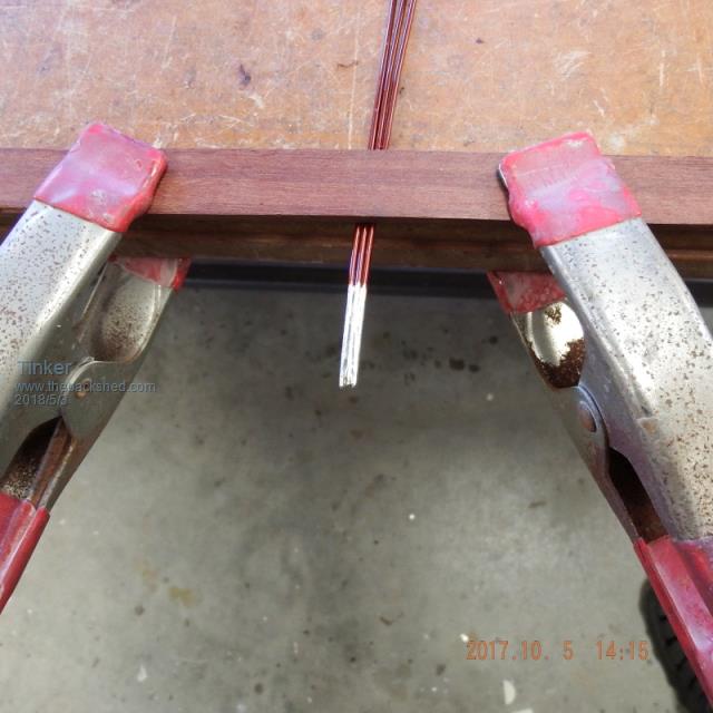

To start, the wire length for 9 turns plus the ends is calculated and three pieces prepared thus:
Soldering them together greatly improves the clamping in the jig. This also readies this coil end for the terminal.
Keep in mind that each successive layer requires the 3 wires to be slightly longer. Easily found out by how much after the second layer.

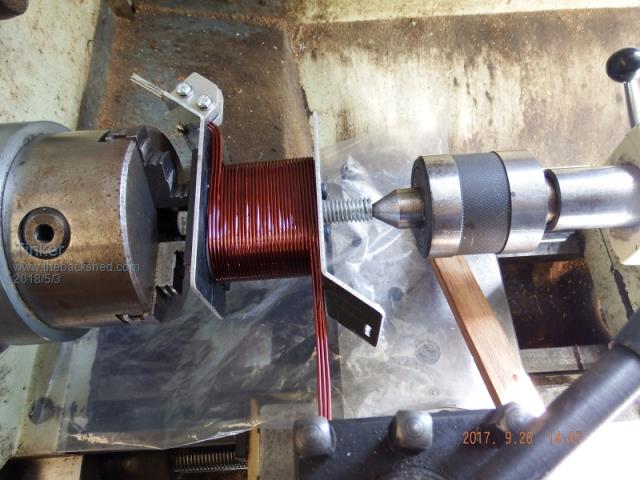

Winding is done by turning the chuck by hand and using the nearest pitch of the threading screw to advance the wire to the next turn.
The friction of the threading gears prevent the chuck from backlash so the wining can be stopped at any time without the wire unwinding.

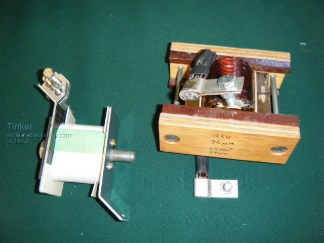

I managed to fit 9 turns (3 in hand) on one layer. These now need to be epoxied in place before trimming the toolpost clamped ends. Do place some plastic under the coil to prevent epoxy messing up the lathe bed .
Only one layer is done at a time, there is no way the wire ends can be held securely unless fixing them with epoxy, so its a one layer a day job.
Before the next layer is added there should be some wooden wedges placed at the beginning and end of the 3 in hand winding to close the gap between the outer wire and the jig cheek. If this is not done the next layer *will* slip off the top there and result in a messy layer, multiplied at each following layer. So, each layer is wound exactly on top of the one below - quite tricky unless the wedges are good.
Here is the finished product and the jig:
A few tips: take care that the lot is not epoxied to the jig! It should slide out without using force. For that the jig was waxed very well and a plastic film layer placed under the first turn. The windings end up quite tight - so they should be - and getting them off the jig core can be tricky. Patience and well hardened epoxy is the ticket here.
To assemble I cut 2mm thick 'air gap' spacers from some acrylic I had. These when tested with my core saturation rig and a 150 turn test coil (to keep the current low) showed this core would saturate above a 12 KW load, giving a generous marging for normal operation.

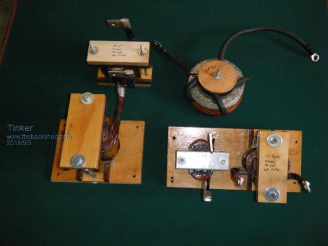

Lastly a picture of the various chokes I made & tried. The ones in the lower right corner are the ones used.
