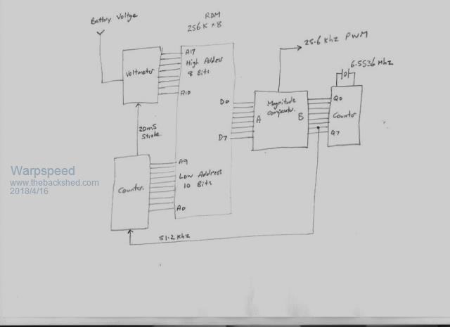

Posted: 11:51pm 15 Apr 2018
Here is my most recent idea for the simplest possible hardware only pure sinewave PWM generator.
The idea here is that we use a very large ROM to store multiple 1K lookup tables.
Each lookup table cycles through 1K fifty times per second using a 51.2 Khz clock.
The data output of the ROM is compared to a high frequency counter to produce 25.4 Khz PWM with an 0-100% duty cycle.
A digital voltmeter reads the dc battery voltage coming into the inverter, and selects a suitable lookup table to keep the amplitude of the PWM going into the transformer primary constant, regardless of any changes in battery voltage.
Just as an example, we could easily cover a 2:1 input voltage by only using the upper half of the ROM addresses (giving 128 different lookup tables). The voltmeter would measure the incoming dc voltage once only at each zero crossing to select an appropriate lookup table for the next mains cycle.
This has both advantages and disadvantages. The advantages are extreme speed of response, with total stability.
Under very heavy loads the transformer output voltage is going to fall slightly, but hopefully not by enough to be a problem. The main challenge an inverter faces are large voltage changes at the dc input created at the battery.
Many improvements are possible such as adding slow integral output voltage correction, or using more of the available ROM. But the aim here was to come up with something really simple using the fewest possible parts.

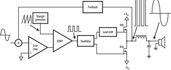

  noneyabussiness said   Warp, what about a micro " creating " the spwm and a analog device ( external ) to adjust the peak/average of the waveform for voltage regulation? ? Sort of what you do with a square wave fed into a comparator and adjust the trigger point voltage ( feedback )
What you are suggesting sounds very much like a high power class D switching amplifier.
That is also a very interesting approach.
Its basically a multi kilowatt PWM audio switching amplifier running with a 50Hz tone.
The waveform purity would be excellent, and so would the output voltage regulation.

Posted: 09:02am 16 Apr 2018
Exactly what I was thinking. .. d class amps are common and filtering etc. Is well established and well documented. Its just the unknown load, whereas speakers you can calculate easily (ish).

noneyabussiness
Joined: 31/07/2017
Posts: 527
Posted: 09:16am 16 Apr 2018
Class D avr
Something along these lines, fed a 50hz sine wave
I think it works !!

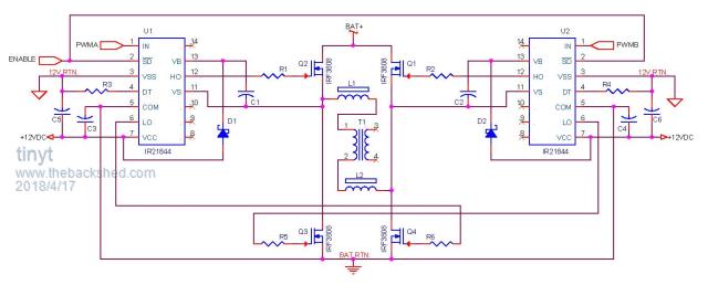

This might be fun.
I have a prototype inverter designed to permit examination of the effects
of a few variables such as 1/2 bridge gate drive dead time, PWM frequency, closed loop control methods and such.
I have posted results here in the past.
I have a basic inverter board built with 4 x IRF3808 which runs using either
my prototype controller board or a EG002. I can swap either in 10 seconds and examine the results of the test.
The system I have is using an Atmel Atmega 328 microcontroller (Arduidno Uno to be precise) feeding two gate drive signals and one output enable signal into 2 x IR21844 1/2 bridge gate driver ICs. I use an isolated 12V supply for the IR21844s.
The IR 21844 takes a single input and generates the two complimentary gate drives for a 1/2 bridge. They also, via a resistor, let you set the dead time. They have an output enable pin which I use to important effect.
I want to share the current code I am running.
setup() is run once and initialises the sine wave table, variables and sets up the two timers that periodically run their particular code blocks.
loop() is run repeatedly ad infinitum.

  poida said  ...The system I have is using an Atmel Atmega 328 microcontroller (Arduidno Uno to be precise) feeding two gate drive signals and one output enable signal into 2 x IR21844 1/2 bridge gate driver ICs. I use an isolated 12V supply for the IR21844s.
I am guessing the basic circuit looks like this?
It is just a re-draw of what is in the datasheet plus my interpretation of your description. Had to interpret from English to my native language and then to drawing. So, it could be completely wrong.
Posted: 04:04am 17 Apr 2018
That looks like it will work, but you need to ensure PWMA and PWMB have sufficient dead time.
There must be a slight pause between when one goes off and the other turns on.
That can either be in software, or hardware, but it must be there.

Posted: 04:50am 17 Apr 2018
tinyt:
no, not like that.
For this to work:
U1 will drive switches Q2 and Q3
with U1 pin 6 connected to Q3 (LOW side)
and U1 pin 12 connected to Q2 (HIGH side) of the bridge.
U2 will drive switches Q1 and Q4
Already you have correct pin12 going to Q1
You need U2 pin 6 going to Q4
It does not matter if you have U1 taking the 50Hz signal or U2.
All else in the drawing seems OK.

Tinyt,
dead time will be taken care of automatically due to the design of
the IR21844 chip. With zero resistance of dead time setting pin 4 that is
connected to ground (pin 3) the dead time will be about 400nS
200K ohms will give about 5uS.
I set it at about 1uS in my current design.
As a first approximation, just ground pin 4 to set DT to 400nS and see what happens.
Again, the value of having a modern DSO is clear because you can hook up both LO and HO outputs to the scope and see the complimentary outputs and dead time.
Posted: 05:10am 17 Apr 2018
I confused the IR21844 with the IR2184.
The 44 has built in adjustable dead time, the 4 does not.
