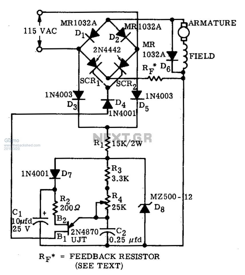

I did have to replace a SCR in the motor controller for my little lathe a couple of months ago, and I thought the circuit was clever. It use 2 diodes and 2 SCR's wired as a bridge rectifier. Control was smooth and linear.
I guess PWM would be the best option thought for a DC motor.

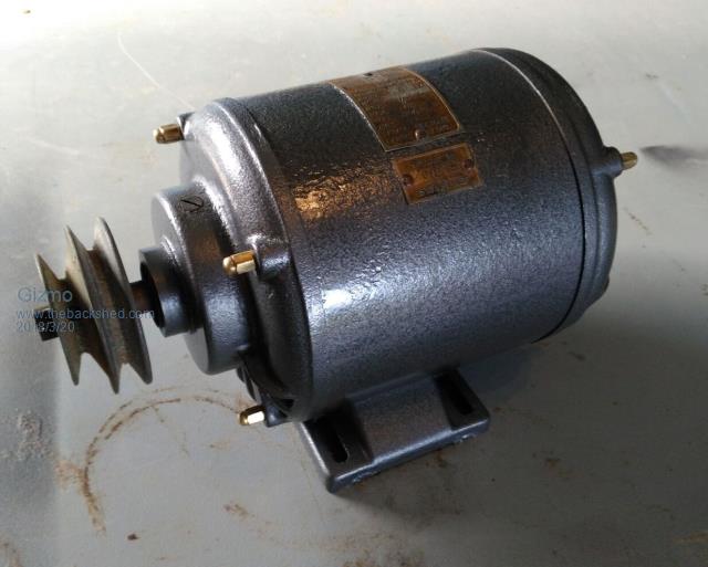

This is the old induction motor.
It's a Crompton Pankinson, Australia made ( back when we made stuff ), 1/2hp 1435rpm motor. This is probably the easiest, most reliable and better looking option for the band saw.

I found this circuit, looks similar to the circuit used to control my lathe DC motor.

Check if that motor has a centrifugal start switch or is it capacitor start?
Had one of those motors on the cement mixer and the centrifugal start switch failed at times and would stall the generator, could be a pain.
