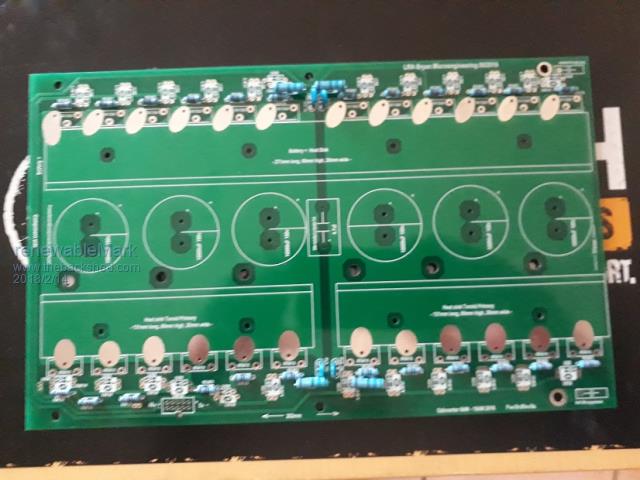

I wasn't aware of a OZ design that only used 4 caps, the boards I got from Clockman (recently) have 6 caps.
You can buy the boards here
Cheers Caveman Mark

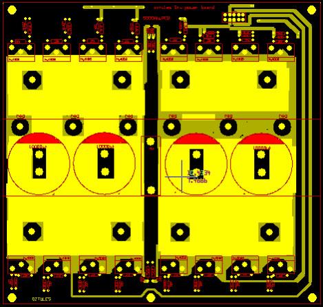

Here is a GerbTool screen capture of the top silkscreen and top copper gerbers that I traced to make the schematic.
