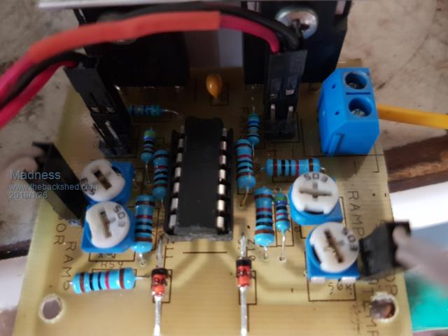

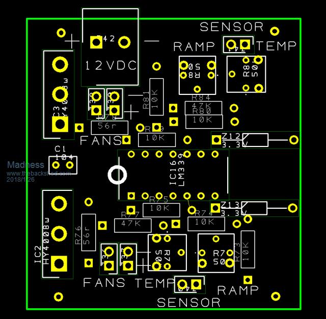

Just finished doing an upgrade to Oztules 12V fan controller originally designed for the Ozinverter but could be used for anything needing automatic fan control.
The original version only had one output, I have used one of the spare channels of the LM339 Comparator so that there are 2 separate inputs and 2 outputs. In my inverter I use one side for the Heatsinks and the other for the transformer. It all fits on a 50mm square PCB. Sensors are 10K Thermistors .
2018-01-26_105714_TempFan2_Silkscreen.pdf 2018-01-26_105740_TempFan2Copper.pdf

Posted: 09:25am 29 Jan 2018
Nice to see you got that controller actually working.
I dabbled with it a long time ago when Oztules first mentioned it (back in the PJ conversion days) but never got it running satisfactorily.
My fan growled fearfully at low speed and was very iffy as to when to start up at all.
The upshot of this was I gave up with this idea altogether.

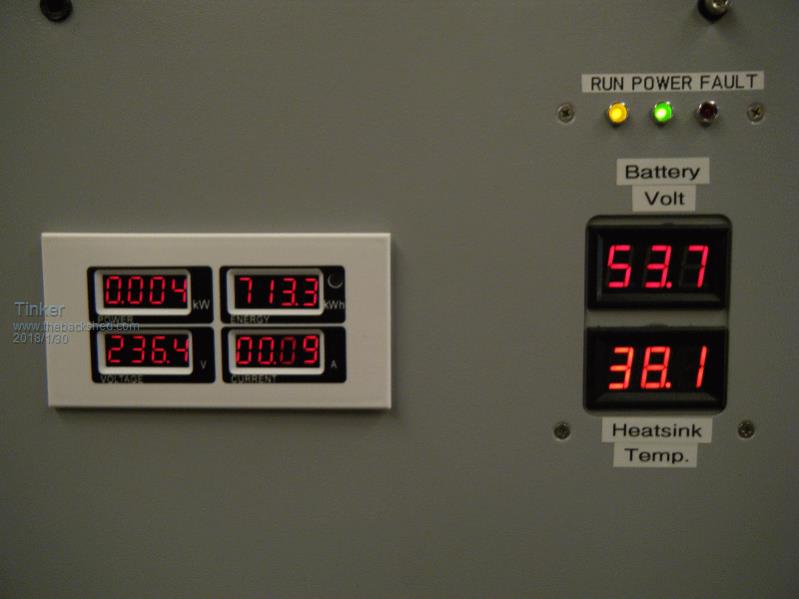

Here is a case in point; the picture below shows the panel of my converter PJ inverter. This has a 8KW (Chinese) power module and a rewound 3KW toroid which, BTW, has a very generous copper section primary and secondary winding.
But, unfortunately, I did squeeze the lot in an recycled Aerosharp enclosure.
Note that there is virtually no load on, this inverter only powers the lights in my house. Yet, its 4 x 80mm fans (2 in, 2 out) have to cycle on constantly to maintain the shown temperature on this, relatively cool, 30 degree Perth summer day.
And we do have our share of 40+ days here as well Madness, the fans will just about run non stop then.

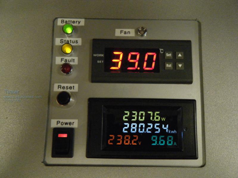

Next a picture of my new, own design, double stack inverter.
Note that this one *does* have a reasonable load on, yet its fans took 15 min or so to come on and then have long off times with that load. With no load the fan never runs at all unless the ambient gets very close to the 40 degree fan trigger temperature.
I am not worried at all about the expensive capacitors getting too warm, they are located on the cool side of the PCB and do not see more than 42 degrees or so on a very hot day.

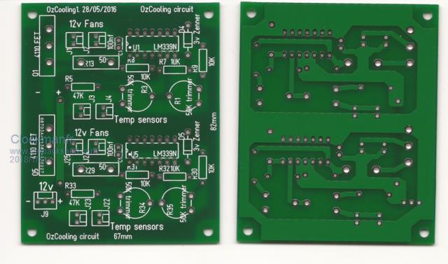

OzCooling board.
2 Fans and 2 temp sensors for the toroid, ..... and 2 fans and 2 temp sensors for the PCB's

What I did is make better use of the IC, it has 4 channels but that circuit only uses one, my modification just eliminates the 2nd LM339. I find it works fine with single thermistors.
