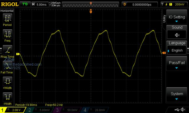

I am attempting to clean up the waveform of my SPWM inverter. Its fine when its supplying a resistive load like a light bulb, but when it drives a switch mode power supply its cutting the tops / bottoms off the wave form. I am using a traditional H-Bridge unipolar arrangement to a 150VA, EI 6V:240V transformer. The attached picture of the wave for clipping is with a single 18W compact fluorescent bulb. Data was captured on the 240V output via a 3VA isolation transformer. So far I have made the following changes / checks to no avail.

Do you need some extra turns on the primary or more capacitance? I get a similar effect if I run a board to test it with no capacitors.
Inductors and different dead band time effect the waveform at 0 crossing in my experience, your issue is at the peak.Edited by Madness 2018-01-26

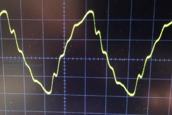

I know compact fluros can cause very bad distortion on a small inverter. Sorry I missed that part of your first post, so it may not be your inverter that is at fault. Someone sent me the image below recently, this was caused by compact fluro lights on a small inverter with just 4 MOSFETs. Without the CF's it gives a perfect waveform.

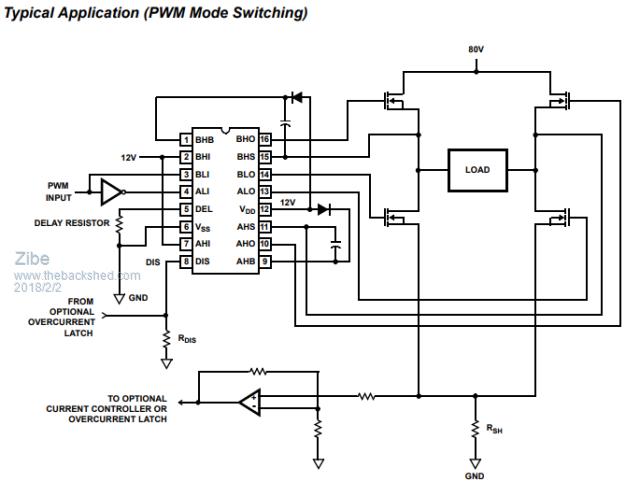

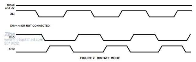

I am using the HIP4082 H-bridge driver, it’s a pretty handy IC and has built in deadband control and shoot through control. I am using only two of the control pins for the low side control (in this configurations the high sides output is a negation of the low side) as per the following example from the datasheet and timing diagram.
So either the low or the high mosfet of one side of the H-Bridge is on/off at any one time, never floating unless during the dead time. So during the on part of the PWM, everything is normal but when off it is suddenly reversed polarity (rather than floating). Both sides of the transformer would be held to the positive rails for example.
Really I just need to double check my understanding is correct.

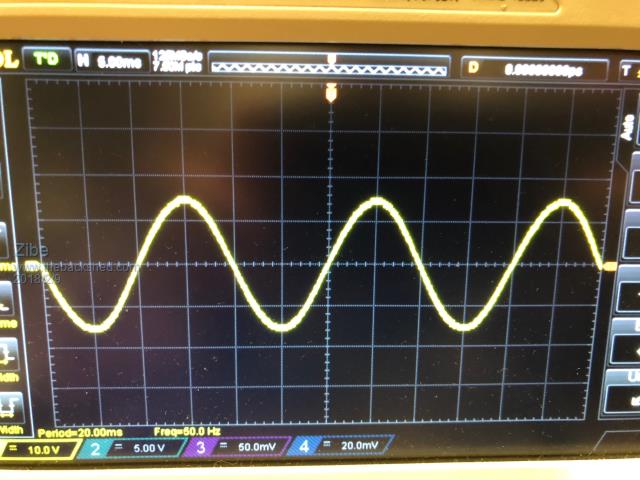

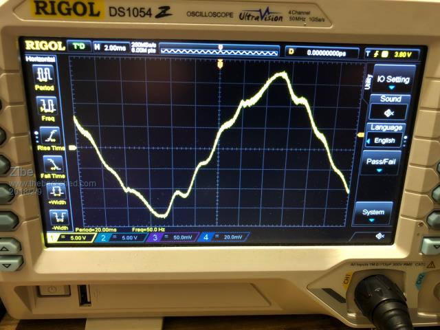

As an update and for anyone who comes across this issue. I tested another inverter I made that uses a Latronics PVE1200 transformer. It too was experiencing the significantly distorted wave form. I found that using the inductor in series with the transformer was creating the issue (I think it was around 1.1mH from memory). When I removed it from the circuit there isn't any viable distortion to the waveform when switching on multiple Compact Fluorescent Lights.
My thoughts are the inductor was preventing sufficient current to the transformer directly affecting voltage stability. The inductance being too large for this application.
Likewise my 150VA EI transformer might be too lossy (sag) to adequately drive switch mode supplies as I do not use an inductor but experience a distorted voltage wave form especially where current is drawn at the voltage peaks.
With Inductor (used a current limited & rampped voltage supply to soft start).
Without Inductor.
