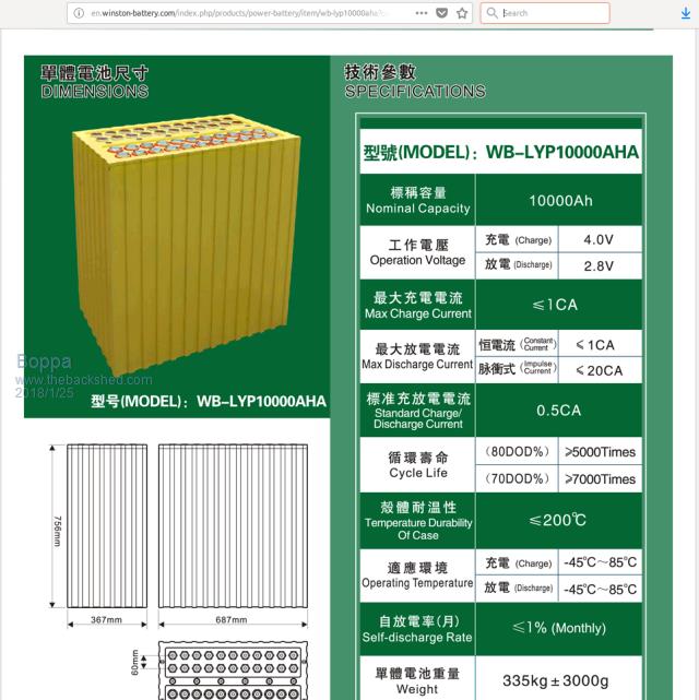

  Tinker said
The 10KW lithium battery bank was fully charged.
Time to upgrade...
Drools.......
Posted: 01:11pm 25 Jan 2018
I imagine 16 of those 335kg cells would beat Mad's forklift pack hands down by weight .
I also think at that size they get a wee bit impractical but just imagine, you'd need to charge these monsters only every two weeks at my place.

Posted: 03:10pm 25 Jan 2018
I cant see Trev using a pack of these in his hilux-he has how many in it 120???
maybe an electric semi-trailer??? lol
Posted: 09:14pm 25 Jan 2018
What is the price of those? Going rate for Lithium is around $1 per WH which at that rate would put 16 of those at $500,000 AUD.

Posted: 03:51am 26 Jan 2018
  Madness said   What is the price of those? Going rate for Lithium is around $1 per WH which at that rate would put 16 of those at $500,000 AUD.
You better get a new supplier cos you are getting stiffed by about the price of a new cheap ferrari unless there is a free hat and keyring in the deal....or if Im getting a kickback.
Posted: 04:43am 26 Jan 2018
Well that was the price I was quoted by several suppliers when I was looking recently at buying batteries. Some were even double that, FLA was pretty high also. I did ask on here but no one volunteered any better prices. So the best deal I found was $3,600 for a 775AH 48V refurbished forklift battery with 2 year warranty.
If you can get better prices why not volunteer some information?????
PS,
I did find this WB-LYP1000AHC, 3.2V, 1000AH, 560×360×130, 35kg $2000
So 13 times that is $26,000 USD a lot more than FLA and a 10,000 AH version is going to be in region of $260,000 USD, that's $353,000 AUD with GST Plus freight etc.
So was my estimate of $500,000 AUD that far-fetched? Maybe 20% over.Edited by Madness 2018-01-27
