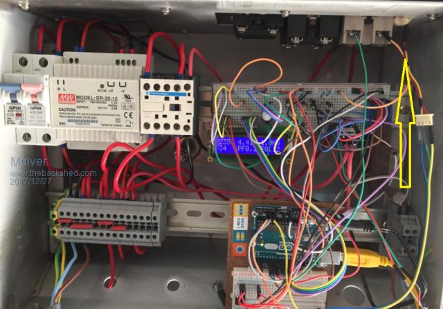

I have been testing my Solar Diverter which will live inside an old 1.5kw AeroSharp GTI.
So far it works well I just need more panels, which i hope to add in the next month or so.
I would like to use the temp sensor that is on the original heat sink!
Is there any tricks to figuring out what it is or how to use it? (see arrow)
I've tried using it like a TMP36 but it does not appear to respond or change value.

Have you checked the resistance? I would not get too bogged down with it though temperature sensors are quite cheap.Edited by Madness 2017-12-28

Thanks Madness Im pretty new to the electronic side of things....
I measured the sensor, sensor wires are Red, Blue and Yellow.
Red to Blue is 1880k and goes down when the heatsink is heated.
Blue to Yellow is a static 40k
Red to Yellow no continuity.
With that in mind i found this
http://www.circuitbasics.com/arduino-ohm-meter/
So i think i should be able to sort that out!

If you go ebay, I buy these by the hundred.
http://www.ebay.com.au/itm/Good-Use-10PCS-Thermistor-Temperature-Sensor-NTC-MF52-103-3435-10K-ohm-5-DIY/122032518042?epi d=1475639255&hash=item1c69b4739a:g:TaQAAOSwjvJZWwnp
They are 10k@25c which seems to be the normal range type on a lot of devices I have come into contact with. I use two of these in the inverters to sense heat sink temp for the fan control and the 8010 TFB directly.
It is just a variable resistor but NTC ie the resistance drops as the temp moves up. If you make a voltage divider with the 5v from the arduino, with one of these in the leg, you have a temp sense voltage to play with.
........oztulesEdited by oztules 2017-12-29

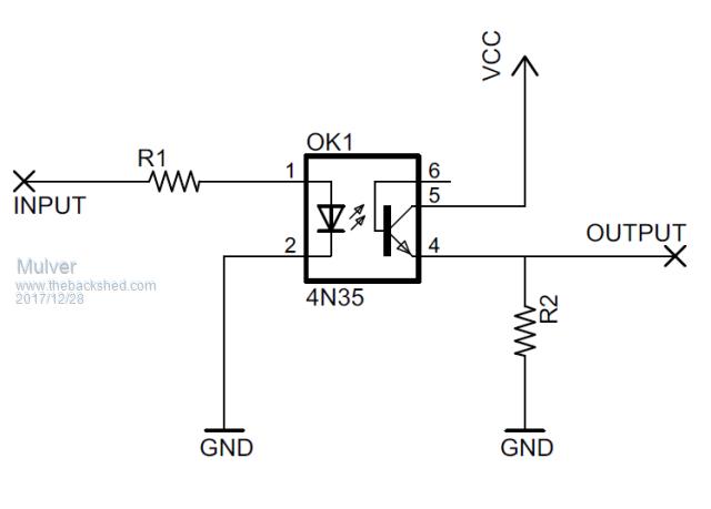

Im currently triggering the SSR directly from the arduino output, which is working fine, but would it be good practice to use an optocoupler like a 4N35? to drive the SSR with a 12v signal from the main supply?
In this setup?
With the input as the Arduino output.
The VCC being the 12v

Thanks Oztules. Was just trying to use the the one already stuck to the heat sink. If it fails ill buy those for $1.00

The SSR is an opto couple anyway, the ones I use say 3 - 32V 7.5ma input, it is only an LED so not much current is drawn.

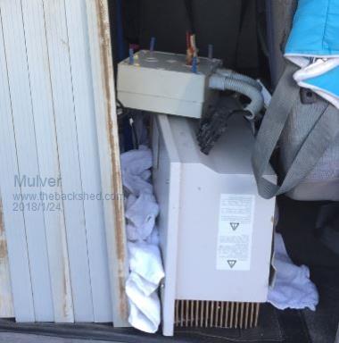

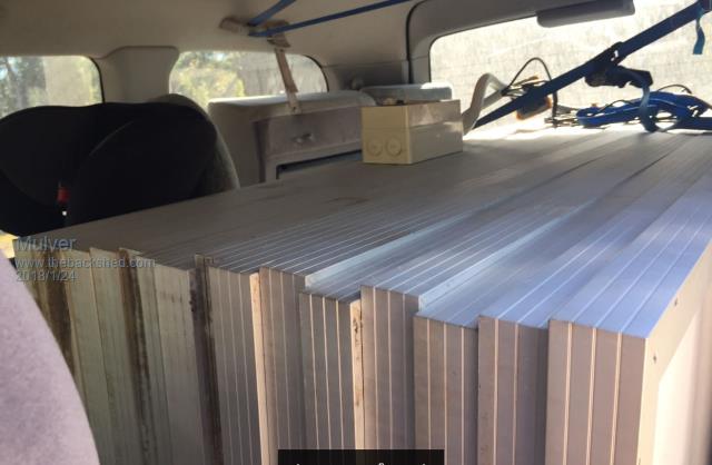

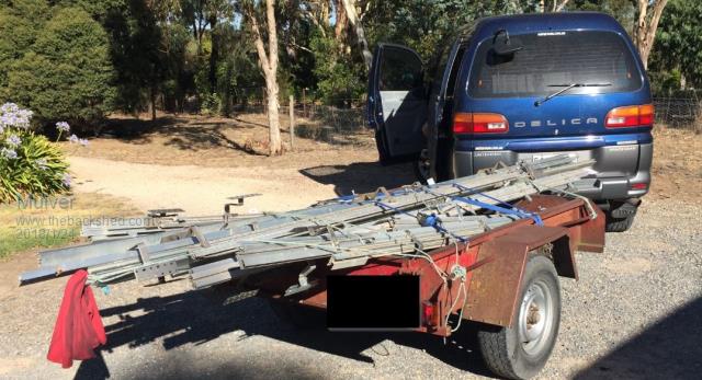

Went shopping today! Came home with....
16 x 190 watt panels
A heap of rails! few different types i just took it all.
Another 3kw Aerosharp inverter, OMG i forgot how heavy they are !!! that makes 3 spare in the shed for future Ozinverters.

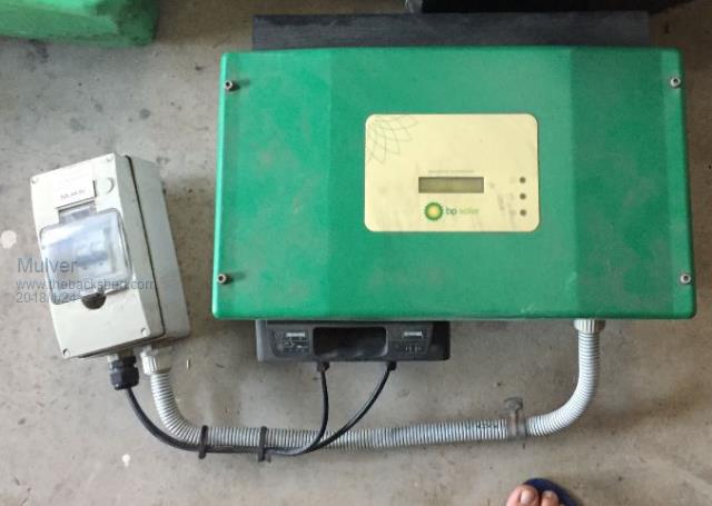

A BP badged Sunny Boy 1.5kw inverter, pretty sure its a transformer model as it was pretty weighty!
Also still to pick up the 8 x 190 watt BP panels that went with the small inverter. Car was to full to take all at once.

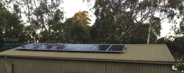

So now the first step is to fit 22 to my shed roof. Currently 8 up there but they need to move.

Posted: 11:22am 24 Jan 2018
Don't see many Aerosharps advertised, they are getting to be like rocking horse sh*t.
