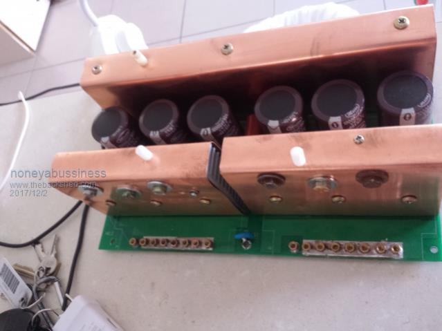

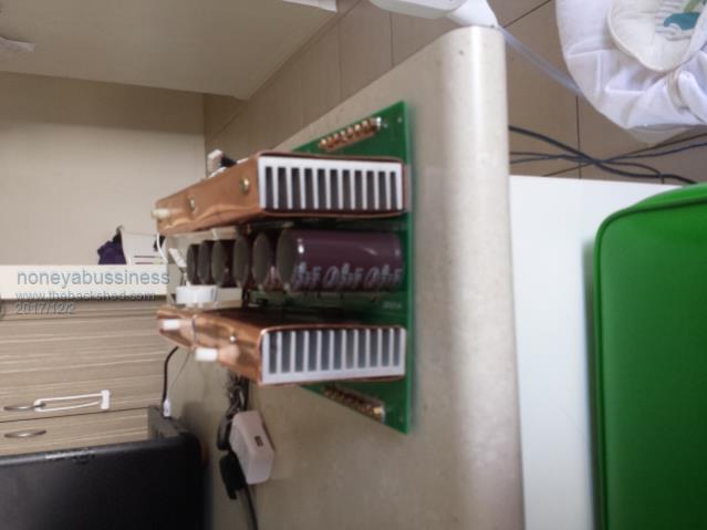

Posted: 10:19pm 01 Dec 2017
https://rover.ebay.com/rover/0/0/0?mpre=https%3A%2F%2Fwww.ebay.com.au%2Fulk%2Fitm%2F142469454110
I have used these in the past.. handy for pushing a bit more heat through. .. early PJ board for the big 10kw one, i overlaid copper sheet on the original heat sinks... combination of copper and ally was extremely effective. ..
I think it works !!
noneyabussiness
Joined: 31/07/2017
Posts: 527
Posted: 10:27pm 01 Dec 2017
Couple of pics of what I mean
I think it works !!
