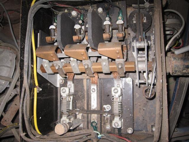

Thanks Gentlemen for these suggestions I also am not a fan of 240 v incandescent bulbs as work lights, Should the glass get broken there is only the remains of the filament support to hold on to in order to unplug the deceased bulb! Hopefully it is switched off and the switch is in the active wire. Below is picture of inside my main switch (cover removed for photograph) ![]() Not a transformer anywhere. However primed with your combined suggestions I found this Transformer Multi voltage 6.3V 24V 36V 110V or this one multi voltages 6.3 12 24 and 36 v My next question : Will either of these be happy on my 415 volts ? Always Thinking |

That picture of the switch. I would bet that is a Star Delta Starter BY A.I.E. Engineering. 20Hp? Nice to see some old gear still in use. Cheers Aaron Cheers Aaron Off The Grid |

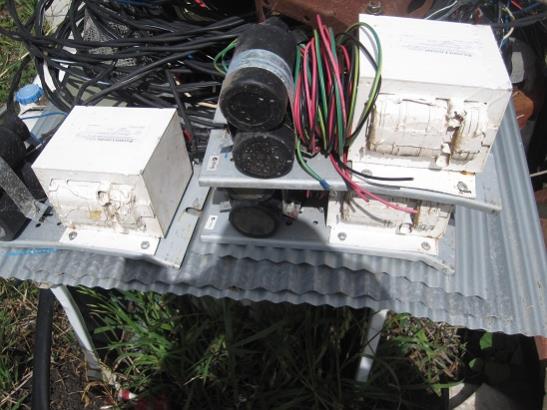

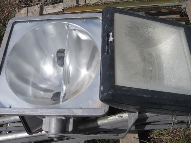

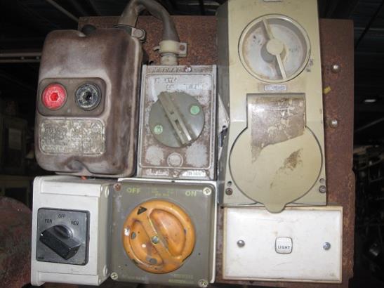

Thanks all, The switch has been upgraded to more modern with reverse ![]() A friend brought me some lights and voltage doublers along with 2 cartons of spare bulbs. The lights are around 400mm square. He said these will light up your lathe! ![]() The doubler ballast transformers - each are seriously heavy Sylvania Lighting Constant wattage ballast 1500w 500v 3.3a MHL1500/240 ![]() These output 500 v at 1500 watts, so one was wired up in reverse. Holy shades batman - a 60 watt bulb was a bit bright So a voltage was taken to find 320 v Maybe a single smaller capacitor is required In the meantime a transformer with a 50 w down light has been set up Always Thinking |
