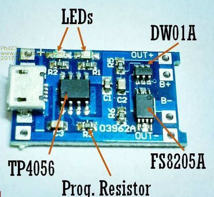

Hi All,
After thoughts on a better solution.
Wanting to run a 2V 100mA fan 24 hours.
At this point I have cobbled together the following.
TP 4056 charger module; fed by a 4.5W 6V solar panel.
It charges & protects a 3400mAh 18650, (A real one, Sanyo).
The battery then connects to a board robbed from a "Juice Bank",
18650 in, 5V out.
The 5V out goes to an LM2596 buck converter to be regulated to the 2V to run the fan.
Very inefficient, with lots of losses I know.....
BUT, what I discovered today is that one the batteries reach full charge, the solar input is disconnected, and the fan is then drawing on the batteries.
Occurred at 3pm today, when theoretically the fan could have still have been on solar power.
The panel seems capable of delivering 450mA of charge to the cells between 9:30am & 2:30pm, so recovery seems to be Ok, but it would be better if the fan wasn't draining battery power until solar was on longer available.
It seems like the TP4056 does not reconnect until the battery voltage drops below 4.0V & Testing with the 3400mAh 18650 that seem to be about 3 hours.
It did cross my mind to parallel the original 2V solar panel in the weather station across the output of the LM2596 module, but I don't know if it becomes a load on the output once the sun is gone.
Thoughts?

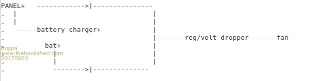

Boppa
Joined: 08/11/2016
Posts: 816
Posted: 08:45pm 19 Sep 2017
Seriously, I'd try that two diode trick
panel (+) connects to battery charger (+), from bat (+)(diode K), diode A to your voltage drop/reg (+)
panel (+) also goes to other diode K, other diode A goes to voltage drop/reg (+)
AFAIK that will keep the voltage reg/dropper to the fan fed from the panel whilever the panel voltage exceeds that of the battery, once the panel voltage drops under the battery voltage, it will start feeding from the battery instead
worth a try at only two diodes....
Phil23
Joined: 27/03/2016
Posts: 1667
Posted: 02:18pm 20 Sep 2017
Thanks @Boppa,
Will give that a try.

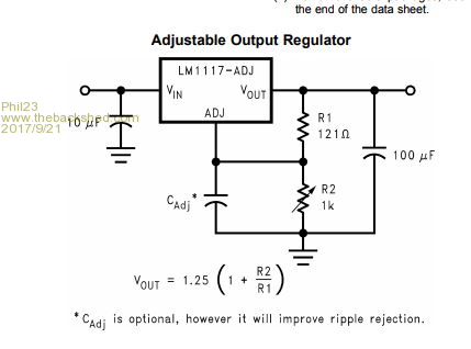

Want to knock up the output reg first, for the 2.0V output.
Based on this, if I'm starting with 4.2V from the 18650's, & maybe around 6 from the panel with the bypass diodes, do I just stick with these suggestions, 121 for R1 & the 1k pot, or am I better off to up R1 a bit? Or drop the pot value?
I'm not that up on design requirements / best practices.

  Phil23 said   do I just stick with these suggestions, 121 for R1 & the 1k pot, or am I better off to up R1 a bit? Or drop the pot value?
the equation is saying the ratio of r2/r1 sets the voltage out. Those two resistors should give a Vout of 11.6 volts according to my feeble braincells.
2.0 = 1.25( 1+ 1000/1666)
or
2.0 = 1.25 (1+ 72/121)
something like that, as long as the ratio is right
Phil23
Joined: 27/03/2016
Posts: 1667
Posted: 06:57pm 20 Sep 2017
Thank's Yahoo,
I Understood the formula, & got the same 72 ohm, but was wondering if I could up the 121 ohm resistor, considering I probably can only get 1k pots locally.
Don't know if the current that resistor supply's is important or not.
Phil.
yahoo2
Joined: 05/04/2011
Posts: 1166
Posted: 06:19pm 21 Sep 2017
I think you could raise the value of R1 quite a lot I have seen plenty of circuits that use a 240 ohm resistor for R1 with a lm117. The lm317 is not as forgiving.
Vadj is going to be a few microamps and the flow through both resistors will be a few milliamps.
in theory the voltage regulation gets unstable with higher resistor values and higher load impedance on Vout. I would be tempted to temporarily fit two 10k linear pots and have a play.
Phil23
Joined: 27/03/2016
Posts: 1667
Posted: 06:28pm 30 Sep 2017
  yahoo2 said   I think you could raise the value of R1 quite a lot I have seen plenty of circuits that use a 240 ohm resistor for R1 with a lm117. The lm317 is not as forgiving.
That's what I'm hoping would work.
Higher would have it's advantages.
72/121 would have a 10.3mA load on the 2V output.
So consume almost 250mAh in a 24 hour period of bad weather.
