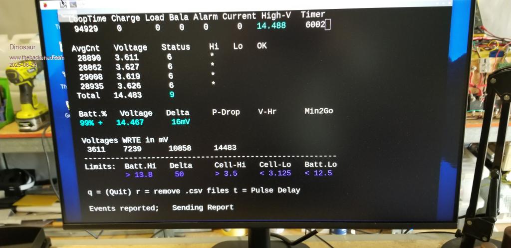

Just a progress report.
Ended up buying DDR-15L-3.3 (spec's attached)
So, simply connecting my battary into 3p(2p) x 4s I ended up with 12v 300+ A/H of two different cell types.
I have 100AH cells and 200AH cells, so some are 2p whilst others are 3p x 100ah.
When charging the battery as a whole some cells are going to reach 3.5+ v before others.
That's when I stop the Battery charging and switch to Cell charging.
The DDR-15's are adjusted to 3.6v and will put out 4.5A or more depending on how far down the cell is.
If the cell is to far down the current limit is exceeded and the DDR-15 goes into "hiccup" mode. (their terminology)
The current tapers off when the cell gets closer to 3.6v.
The end result is that the DDR-15 will pump out 4.5A from about 3.25v resulting in the cell voltage climbing
about 3mV every 15 sec's.(If no load on battery)
The overall performance is a bit hard to read, as when I tested it,the cells at the 12v end were higher by about 200mV to start with.
This results in some settling to the next lot of cells.
Either way once they got to 3.61 approx, current dropped to zero and as you can see from the enclosed picture
the delta was 16mV. (ignore the 99%)
This is mainly due to NOT being unable to set the voltage accurately with the trim pot.
