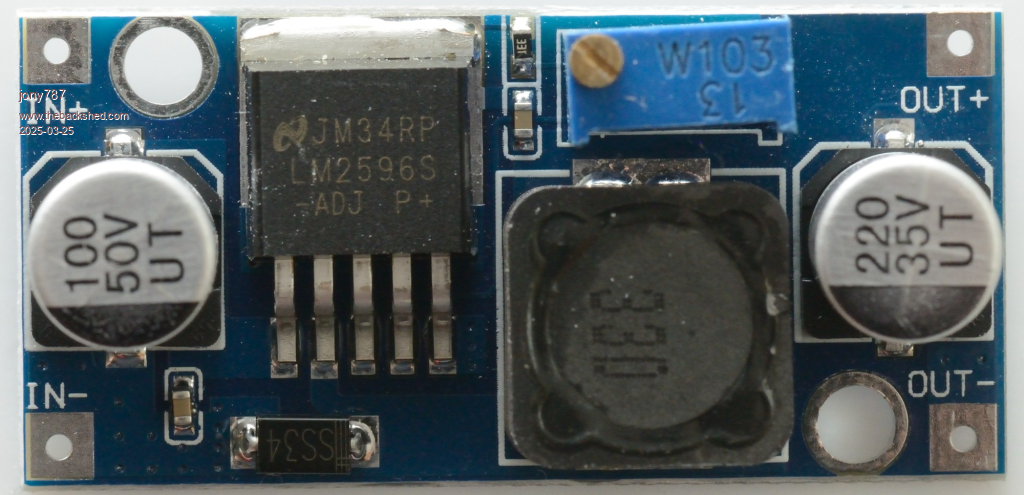

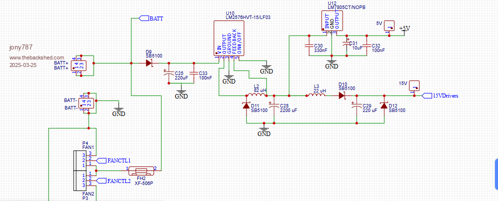

5V line originally from LM7805, now from LM2596 buck converter

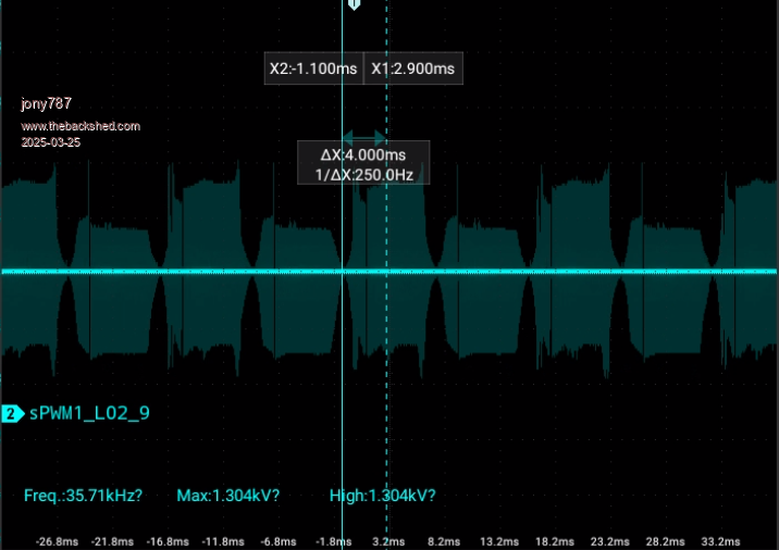

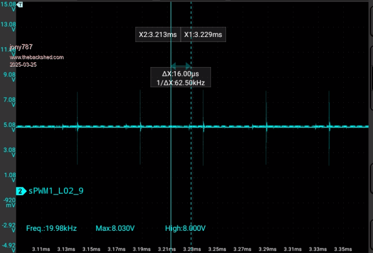

Scoped noise is ~20 kHz ripple/spikes riding both VCC and GND

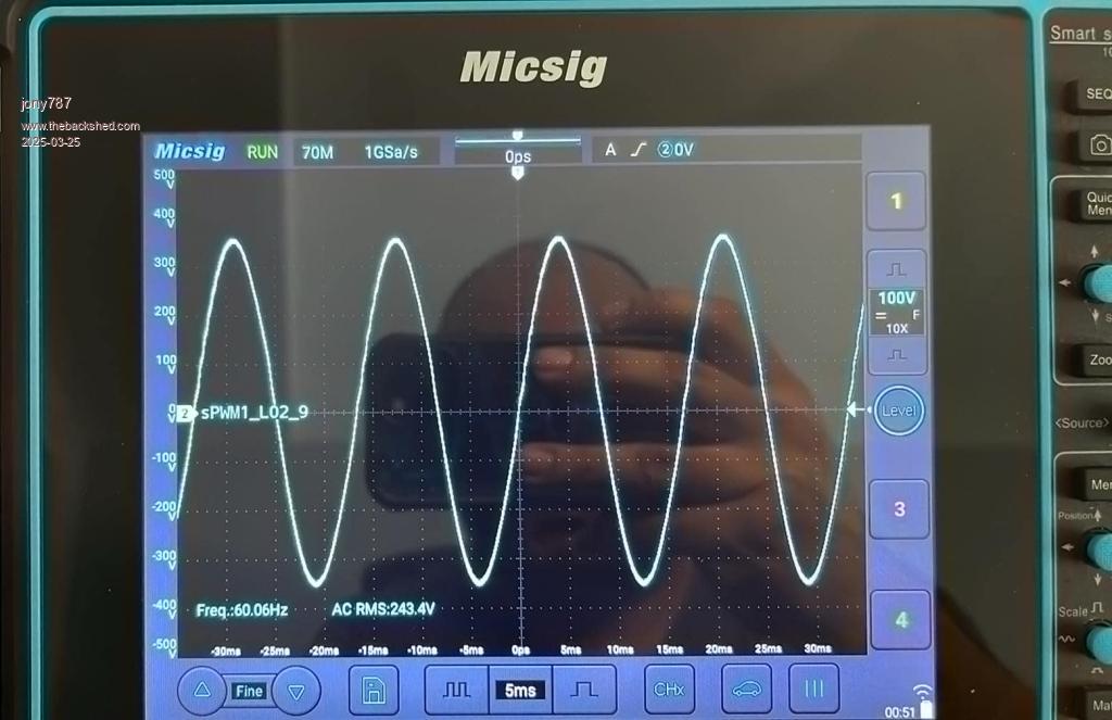

The sinewave looks good overall with minimal wobble at zero-volt crossover.
Thanks to Warpspeed for guidance on transformer tuning—I tuned the secondary close to 90 Hz with a 2.5 µF capacitor.
Right now, I'm powering the inverter from a DC bench supply during testing. The sine amplitude scales with DC input. The inverter is functionally working, but I must fix the noise to get reliable AC voltage/current readings.

I started the project with an Arduino Nano 328p and had a lot of display issues like you mentioned. Using the Arduino Nano Every ATmega4809 have solve almost all my previous display issues. I see your point in terms of the lowering the voltage, I actually go from the battery voltage to 15v via an LM2576HVT-15. before the 5v power stage. I had a LM7805 and the 20khz noise still present. I will look into shielding what I can and will also need to test the inverter connected to the batteries. Ill have to revise the PCB and will look into improving the  grounding across the board. Thanks for your feedback.

I had a quick glance at the DSO captures you posted and did not notice anything unusual with respect to Inverter noise.

Whilst intuitively the noise may appear to be the issue do treat everything else as suspect too - until proven innocent.  I agree with KeepIS the waveforms looked typical to me, I was going to ask how you got it so quiet
