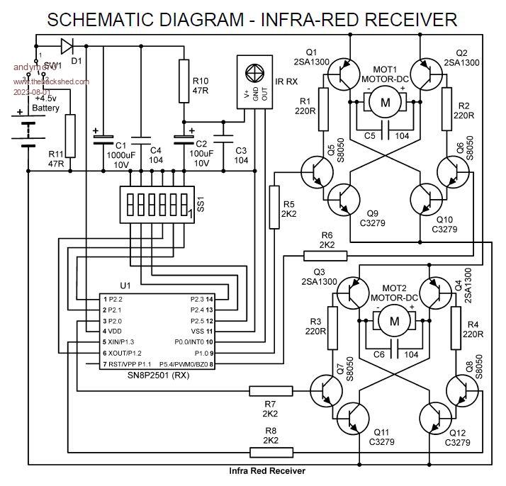

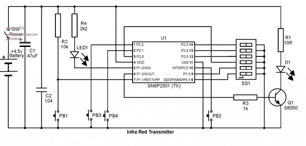

I am trying to change an IR remote control vehicle kit that I can purchase. The issue is that the kits are for students at the college I teach at and the PCB in the kits is terrible (very cheap) and difficult for the students to solder. Also, I want to move away from the kit as student break parts and I have to then use a kit as a Xmas tree. I basically want to remake a new PCB and then be able to purchase individual components.
I understand most of the circuit except for IC chip not sure how that works or how you can have 6 different vehicles working at the same time, I understand the dip switch allows this but not sure how it does it.
I would really like to move to nano to do the same task but I am unsure if changing the frequency slightly would work.

The serial data packets start with an address code (set by the DIP switches) followed by the control code. The decoder only responds if it has the same the address set.

  phil99 said  The serial data packets start with an address code (set by the DIP switches) followed by the control code. The decoder only responds if it has the same address set.
Thanks, Phil, I think with what you have written I have a much better understanding and  I may have worked out a solution. Just have to try and write the code.
I going to look at the Attiny84 and put the code on them for the students.
