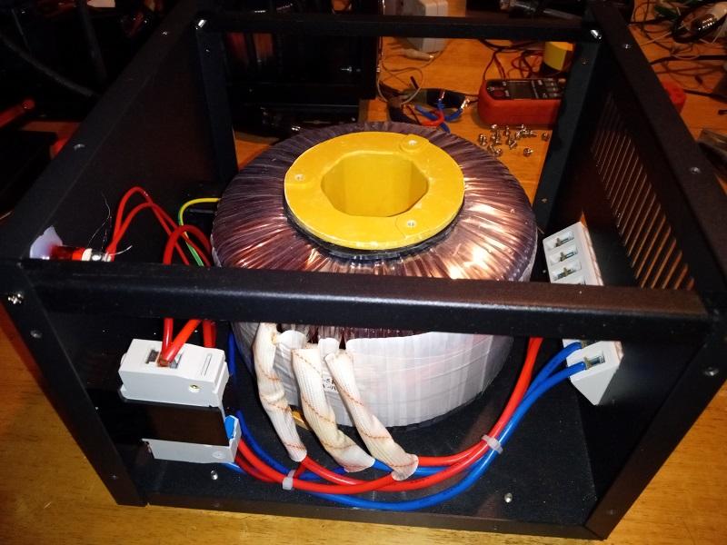

after searching high and low for affordable toroidal trans in the USA, i found potential source on ebay.. search for "voltage converter." you will find a few different variations of basically an autotransformer box for under $100, some are supposedly rated for 5000w and have a toroidal trans inside with two 115V windings in series. i ended up purchasing this one:
https://www.ebay.com/itm/124889104671
its not potted, all you have to do is add your secondary winding. this trans is roughly 180mm width x 100mm height. the windings measure 0.6 ohms in series, so the 5kw rating seems to be fairly accurate

I think it is an autotransformer, so for an isolation transformer application like in an inverter it will probably have to be rated at 2500 watts.
You will probably need to add more turns to the 110/220v windings to lower flux density and no load power draw.
If you add the mosfet drive winding, using multiple strands of small dia. magnet wires, one strand at a time will allow you to make the most use of available toroid hole space.

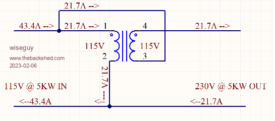

  Quote  I think it is an autotransformer, so for an isolation transformer application like in an inverter it will probably have to be rated at 2500 watts.
Exactly. For a 2:1 autotransformer only half the output VA is provided by the core, the rest comes from the input.

TinyT is right the auto-transformer only needs to be capable of 2.5kW.
For 5kW of 230 the current required is 21.7A but at 115V it is 43.4A.
The input current has two 21.7A components one for the transformer primary and the other is added to the 21.7A 115V secondary so it adds to the input voltage to equal 230V (@21.7A).
The input supplies the whole 5KW the transformer transforms 115V @ 2.5kW.
I decided to sketch it to aid with the understanding, sorry but the graphics let me down the currents do not show the dash of the A and look more like an upside down V. The transformer is drawn like a conventional tranny but the result is the same as a centre tapped auto style winding.
