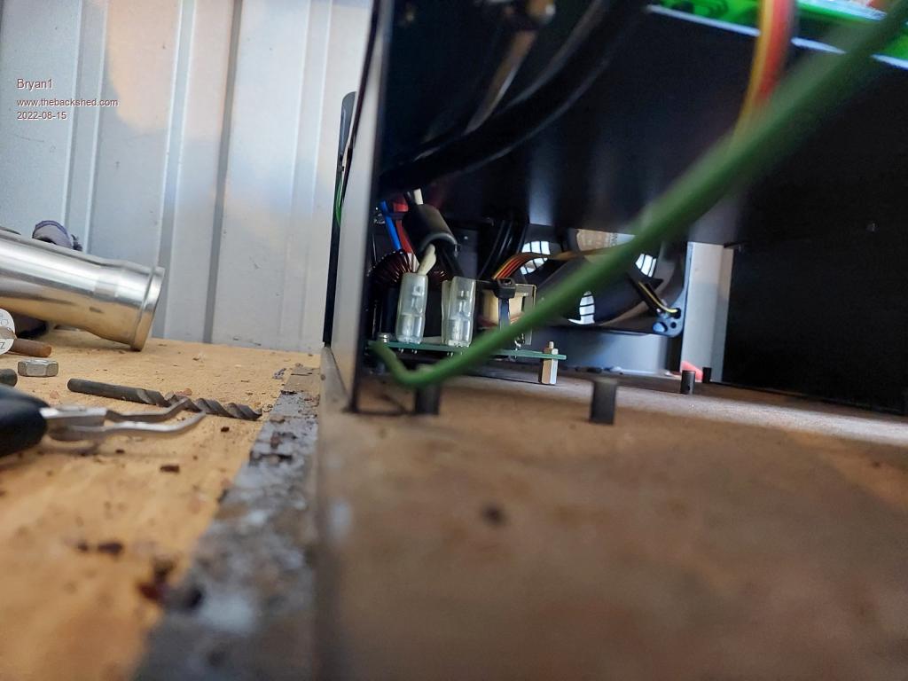

           Over the last few days when I turn on this inverter it has gone into fault mode saying over current and no green power then it comes good. It did it again this morning so I took the cover off to find that relay that was going ratta tat tat when the fault mode was going.
sure enough there is a relay behind the transformer on that board but in order to get that board out means a strip down.

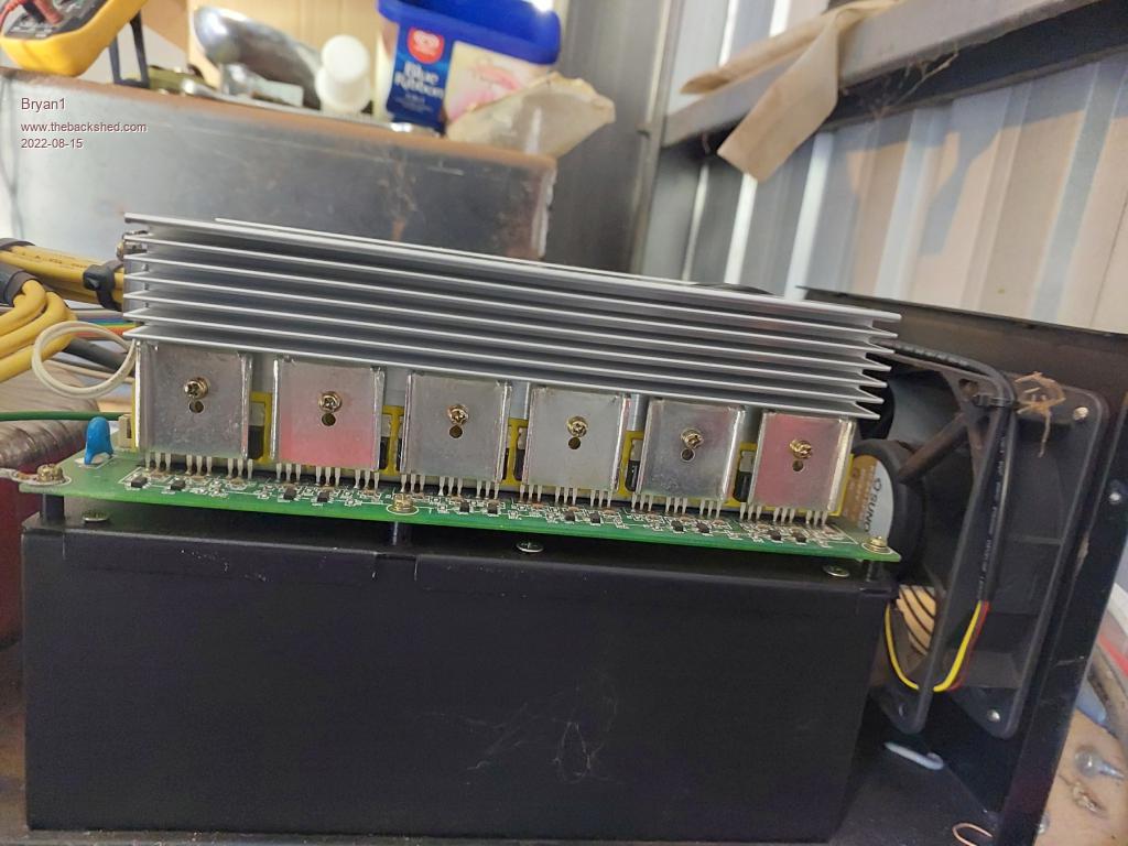

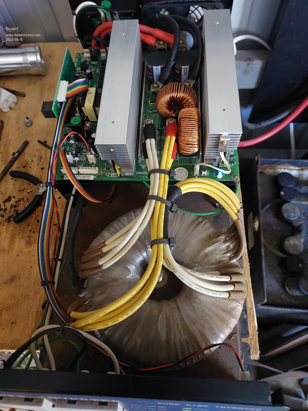

Here is a pic of the inverter
As we can see the windings are 4 inhand and 2 chokes are on the input where only 2 off 32 volt 15,000Uf caps are present.
There are 2 bank of mosfets
In this pic we can see the control card
I am hoping someone from the brains trust can explain the design of this inverter and maybe a close to 20 year old design could be a different way to make an inverter.

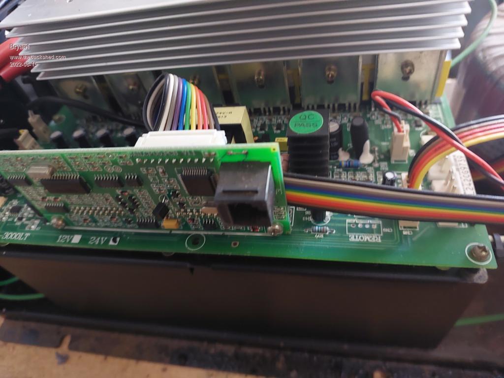

Found this one on ali
24V 2Kw
Now it is very close to that pcb I have here and the link does explain all the details so I can use it as a reference.
Cheers Bryan

Hi Pete, I do have those 360 amp fets here and they should get the most out of that 3Kw aerosharp toriod I have here and as I already have that board here todays job is tracing all the tracks as I did print out that schematic Poida put up for me a while ago.
I got onto ali and grabbed a couple of EGS002 boards the ones that have the lcd readout.
Cheers Bryan
