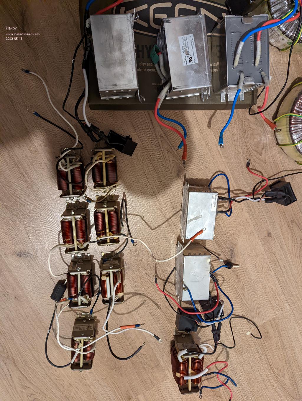

Ok I've been very busy harvesting aerosharp chokes from the carcasses of my ever growing junk pile.....
According to the STICKER on the inductors, I have the following:
7 pieces of 10A 2.67mH (all unpotted)
3 pieces of 15A 4mH (2 of which are potted with silicone)
3 pieces of 20A 3mH (all 3 potted in silicone)
ALL of them have access to the centre winding, so I can halve the inductance easily. And I assume I can parallel the two sides to halve the inductance and double the current????
Now I'm building a 200V DC 3 phase inverter based on the EG8030 so I need 200uH X 3 right?
What will happen if I use all 3 of the largest 20A 3mH inductors, cut the centre link in each and re wire in parallel for 1500uH.
That's about 7x the inductance that I need. Will that be a problem?
What happens when you have too much inductance? Will it all have more of a propensity to resonate in tandem with the transformer?

Not sure if you follow or if I have missed something basic:
they are already in the milliHenries according to the stickers. Say I use half of the big chokes. That's 1500 microhenries (Too big)
I need 200 microhenries.
So what will happen if I have too much inductance?

  Revlac said
  Quote  ALL of them have access to the centre winding, so I can halve the inductance easily. And I assume I can parallel the two sides to halve the inductance and double the current????
I have cut one of those large chokes in half (or was it quarter) and measured about 400uh not sure if that measurement is exact, but it was an el cheapo meter to test with.
Have posted it somewhere, that grey potting is not too difficult to remove.
That's promising. What effect will having 2x the required inductance be?

Posted: 10:44am 18 May 2022
So far, twice the inductance hasn't been an issue that I am aware of, for our 48v inverter builds.
Many more times the inductance (I had up to 685uH) created a bad sign wave and high idle current, enough to scare me, there was probably some saturation as well.
So twice the inductance may not be a problem for you.

Something dawned on me just now. The current rating stamped on the chokes I have is just based on the thickness of the copper wire. The stamped figure won't have anything to do with the magnetic saturation characteristics of the core. So despite being rated for 20A, I think it's going to saturate well before 20A if I don't increase the air gap.... Hmmmm
