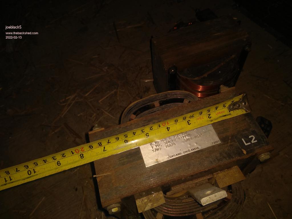

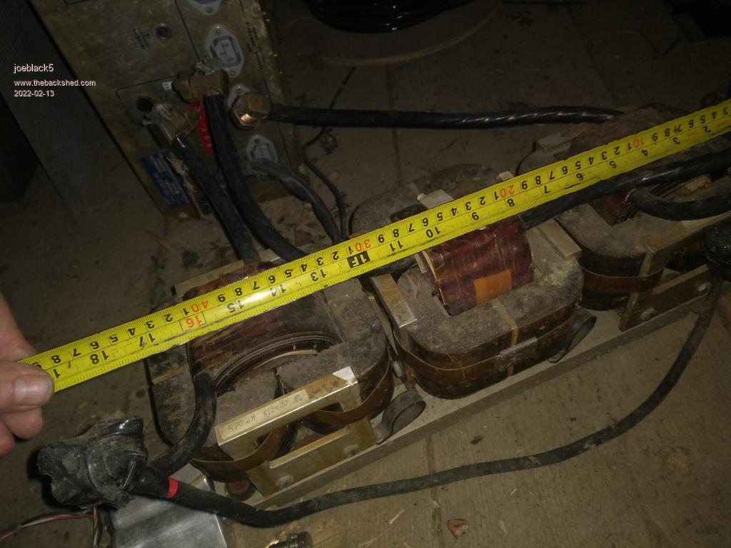

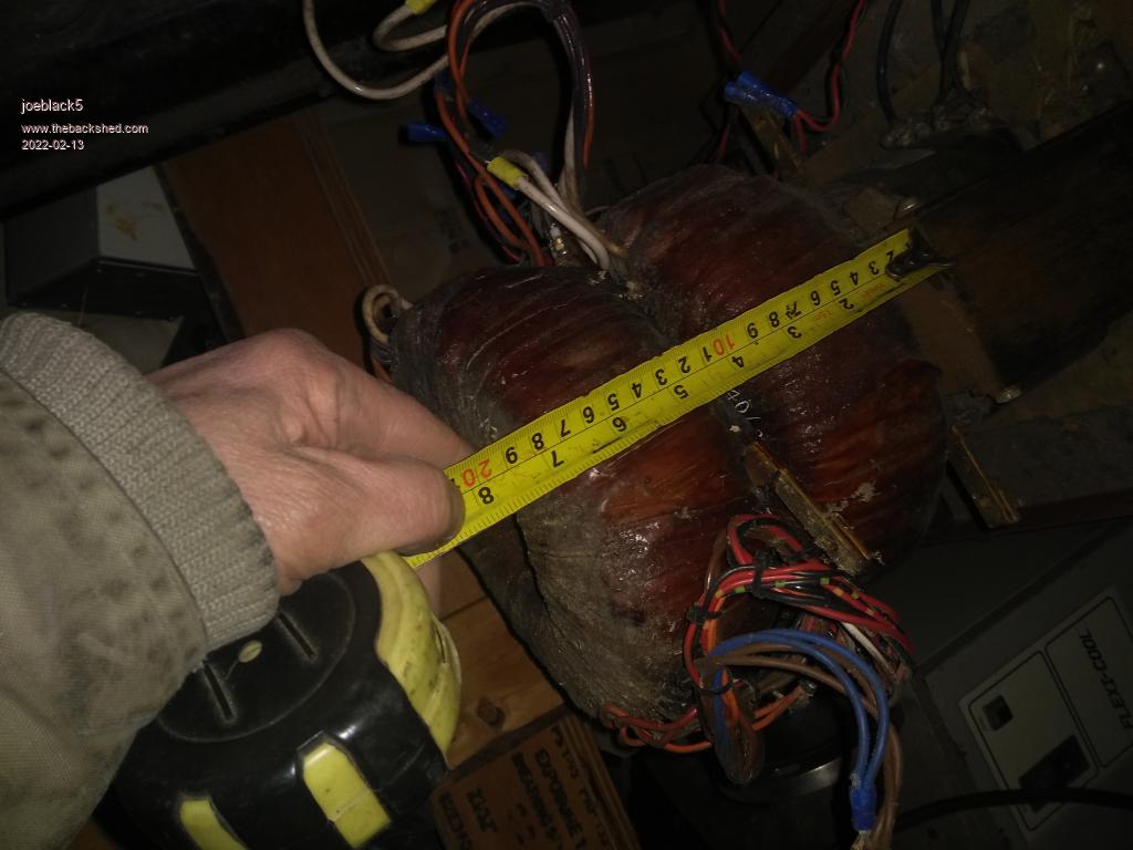

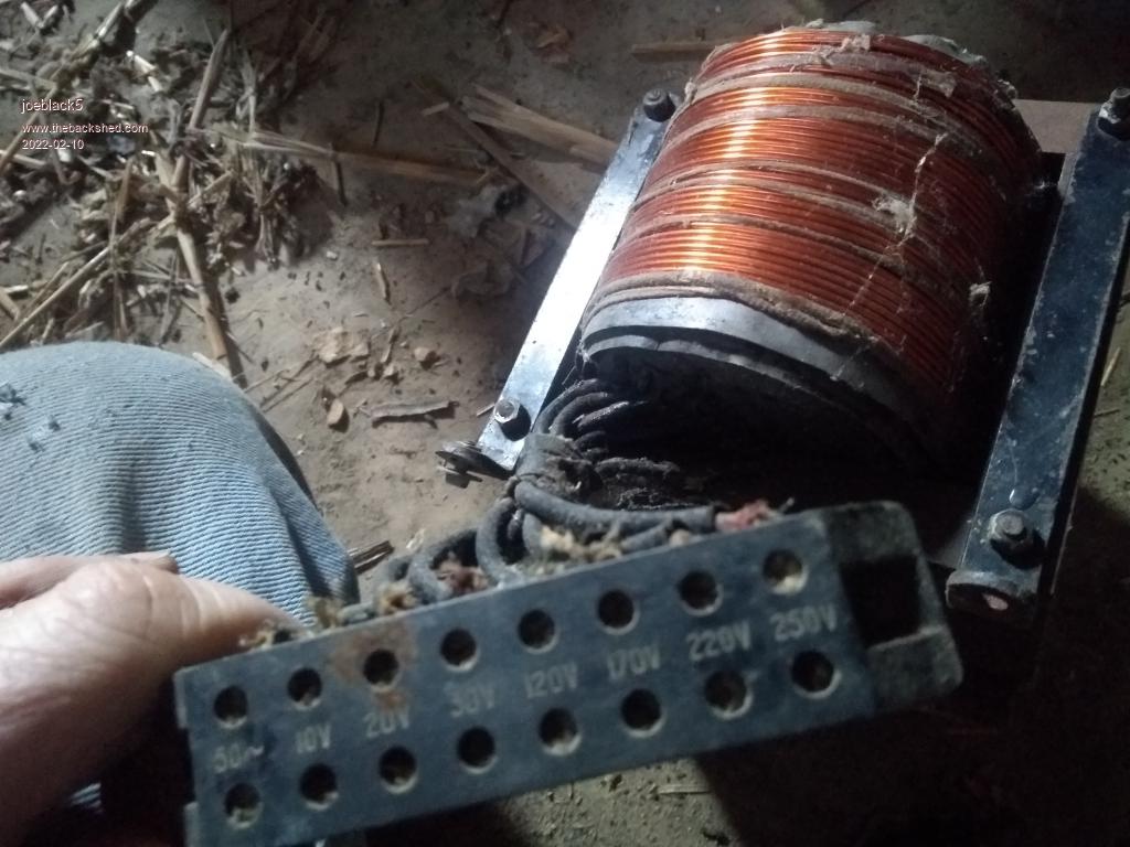

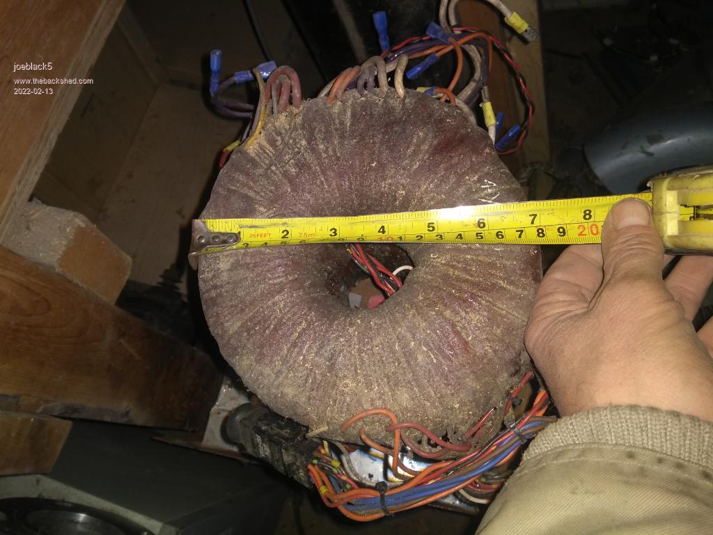

Thank you, I can follow that but sething is missing...if it is not saturation then what and why would I not use a tiny tiny 1" by 1" transformer core with a wide space for all the windings and load that with 5 kva??
Here some pics from inductees I had laying around.
To far out in the boonies.. no upload.
Johan
Posted: 03:07am 12 Feb 2022
You could certainly design a transformer like that, ultra skinny core, and a huge massive great hole for the winding.
But... that skinny core needs a LOT more turns on it to keep the flux level low enough with only one square inch of cross section. Its flux DENSITY that leads to saturation, and a skinny core only allows a small amount of flux to flow in such a restricted core cross sectional area. Turns per volt requirement will end up being very high.
All those extra needed turns are going to fill up your big hole rather quickly, and there will still be a need for wire heavy enough to carry the current to support 5Kva.
All those extra turns will add considerable series resistance which is not a good thing for either voltage regulation, or for temperature rise.
All those extra turns of heavy copper wire will cost you a lot more dollars than adding more steel to the core and using less turns.
So what you end up with is a very low cost steel core, and a very expensive large copper winding that has a very high copper loss, and very poor voltage regulation.
If you go the opposite way, an enormous core with only one turn, you can run a massively high total flux level, maybe even 120 volts per turn
Flux density will be low because the core cross section is so very high. It will have superb voltage regulation, and minimal copper loss and minimal heating at full load.
The big down side is core loss (measured in watts per pound) due to hysteresis and eddy current loss in the steel will be excessive.
A core with ten times the mass may have an idling current ten times as high at a given flux density. The large core is probably going to hum and get hot and draw a lot of idling power even with zero load.
Probably not ideal either.
So we end up with the core manufacturers producing core dimensions over a useful range of proportions that offer a good compromise. And you always have the option to stack cores or go thin if that offers you some particular advantage for an unusual application.
Then its an iterative process, the first core might be too big, the winding fits easily with a lot of extra space left. So your next guess is to try a smaller less costly core.
That might be too tight to fit sufficiently heavy wire or enough turns.  So rinse and repeat.
You may find idling power or copper losses higher than you would like, so you make another attempt.  There is no one shot formula to design a transformer from first principles all in one go.
Decide what is most important for your application, and optimize that, and compromise on some other less critical factors.  That is how its done.

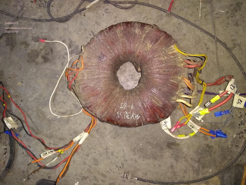

I found two toroid transformers from old surplus military equipment.
Outer diameter 7.5" and height is 3-1/4" ... including windings and insulation.
I ohmed some winding and found what I assume is the original primary.  0 to 110-120-130
Applied with a Variac voltage to the 0-120 winding and measured the current.
70 VAC...35 mAmp  This is measured at 60 HZ.. My application is 50 Hz
80       40
90       44
100      51
110      59
120      70
130      89
140     116
At 110 Volt the curve gets steeper and at 130 Volt it goes up fast.
There are two identical primary winding sets so I can use this for 240 Volt.
When 120 VAc is applied at the 120 Volt primary the I get 24VAC and 13 VAC at the secundary. The secundary windings look like 10AWG.
transformer weight 20.5 LBS.
Another toroid transformer i have has the same dimension , same weight and states 2500VA.
I guess the 24 and 13 v secundaries in series are a bit much for an 48V sine inverter.
It gets a bit better when I would use the 130V primaries.
No by chance I have two the same surplus transformers.
How bad would it be to parallel two transformers together? Not sure i need that for only 1KVA load from the stirling generator.
Johan
