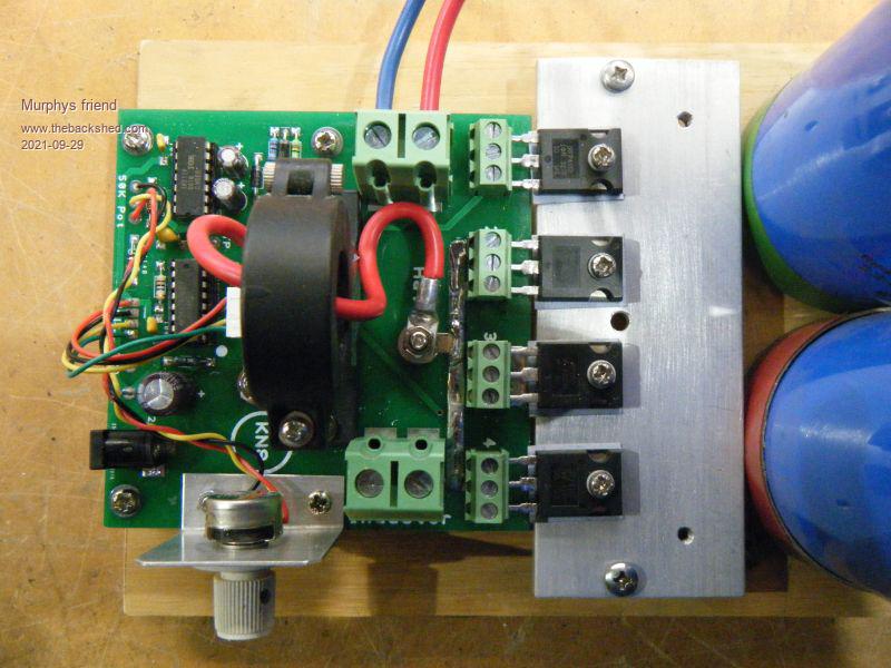

Quite some time ago warpspeed published a very clever saturation tester here which I built. It worked very well but it was cobbled together from some home etched PCB's and bits & pieces, not the easdiest kit to use.

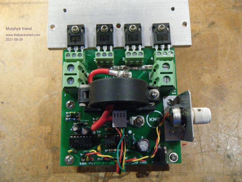

So, having time on my hands I re did the PCB to fit the cheap 100x100mm Chinese boards.
this is what it looks like:

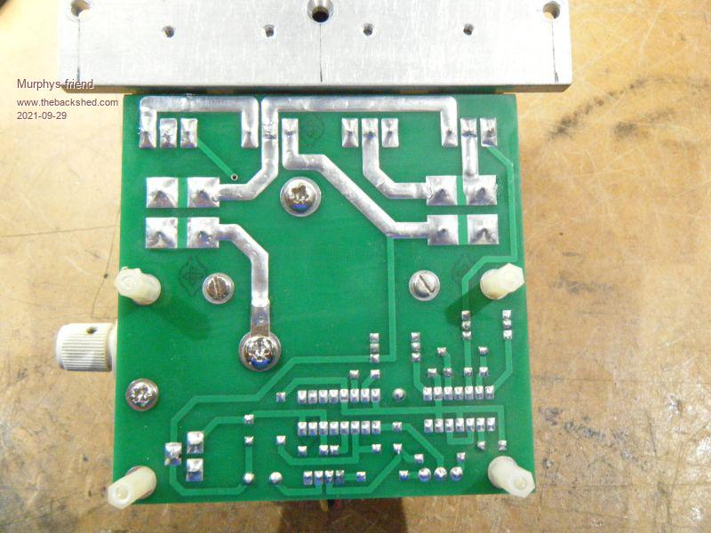

As this is only a 1 oz PCB I made provision to boost the power tracks with solder:

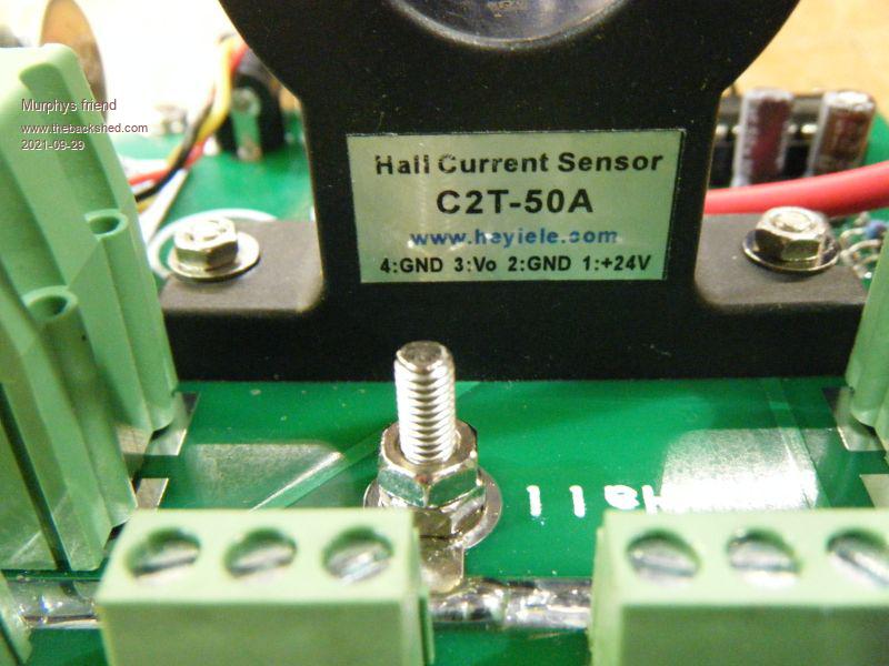

A HAll sensor is required, I used this one:

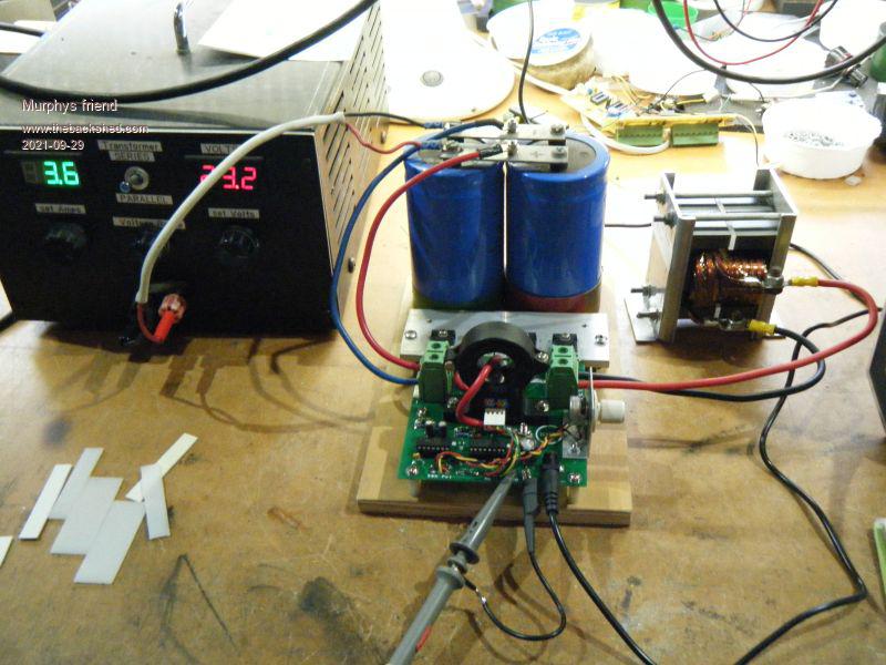

Here I am testing a choke for my (not yey finished) MPPT project:

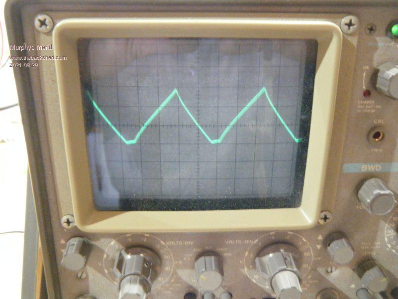

The wave form just before saturation (hand held camera ):

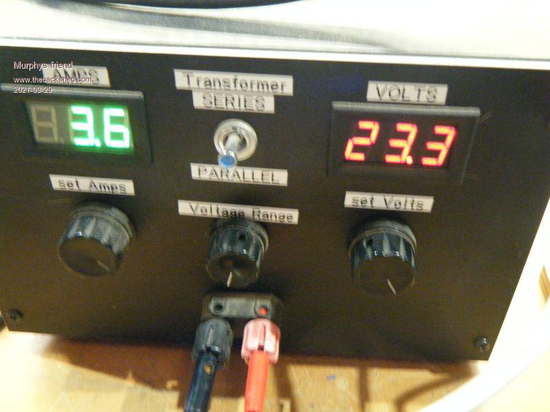

The power drawn from my power supply to get this wave form:

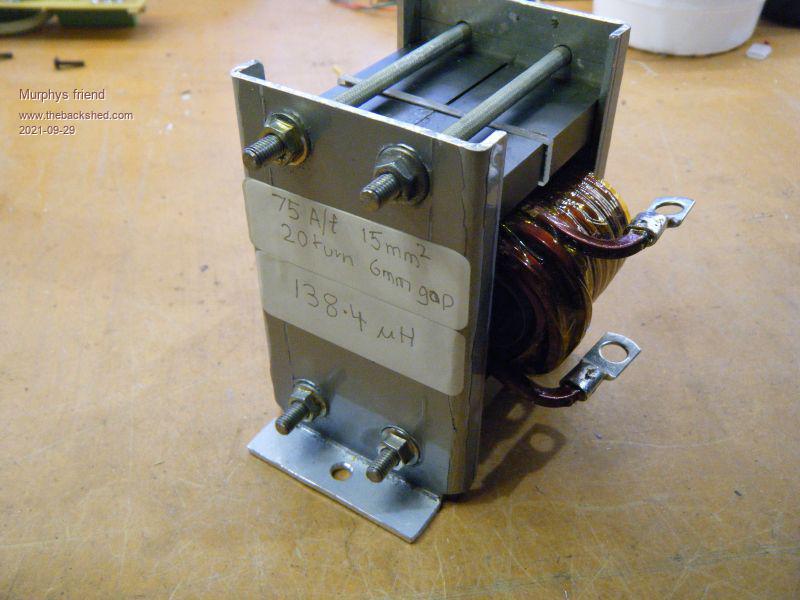

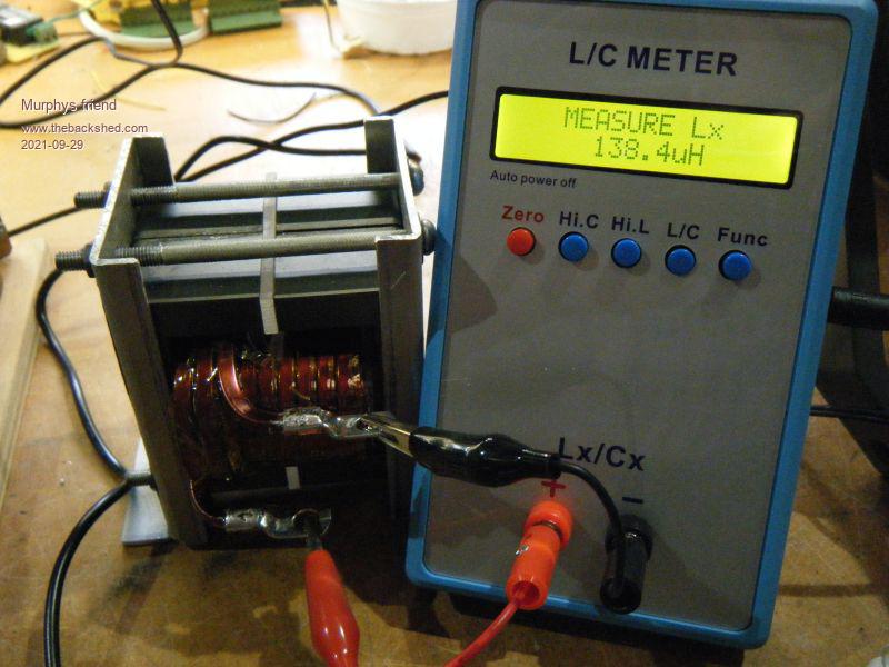

Details of the choke:

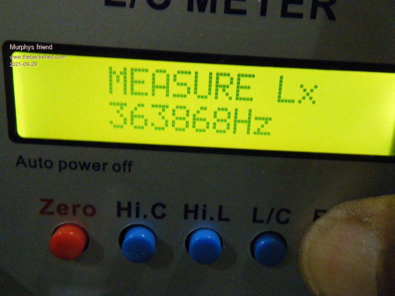

Measured at that frequency (not sure about that):
A close up of my  choke. Its a dual E65 core with a 6mm gap. I gapped all 3 legs with 3mm perspex, doing it that way is a lot easier than grinding of the center leg. Its also much easier to change the gap to get the saturation point just right.
Lastly, another pic of the tester:
I have two spare PCB's here, if anybody wants them they can be yours for the price of postage (Australia only).

What is the timebase setting in the CRO image?
It appears the voltage applied to the inductor is 23.3V
Also, what is the volts/div and current sensor gain (Amps/Volt)
From those answers we can determine the choke's inductance via
Inductance = (Volts x Rise time )/ (Amps change during rise time)
You measured about 140uH
so 140 uH = 23.3 x (rise time)/Amps
Let's say Amps was (75/20) (from the label you put on the choke)
or 3.75 Amps
then I estimate the rise time of the current trace to be
23 uS
And the vertical gain to be 1 Amp/div
And the CRO time base to be 10uS/div

In a way, a solar MPPT controller becomes its own choke tester, just monitor the current waveform with a Hall sensor and that will give a very good idea of what is happening.
Not really possible to do the same thing with an inverter though, as the choke current waveform is changing continuously throughout the 50 Hz sine wave. So the choke tester becomes a pretty important part of testing a suitable prospective choke for an inverter.

Thanks Poida and yes, it was fun to build.
I can't remember looking at the CRO time base, I just adjust it to show a suitable number of peaks on the screen. Remember, the testers frequency can also be adjusted with that little pot on the right side.
That Hall sensor returns 40mv/Amp.

I find it easier to use an inductance meter . I have that little one many others on this forum use as well but it refuses to switch from C to L now. That blue one shown above is a little more expensive but can measure much bigger L & C values.
