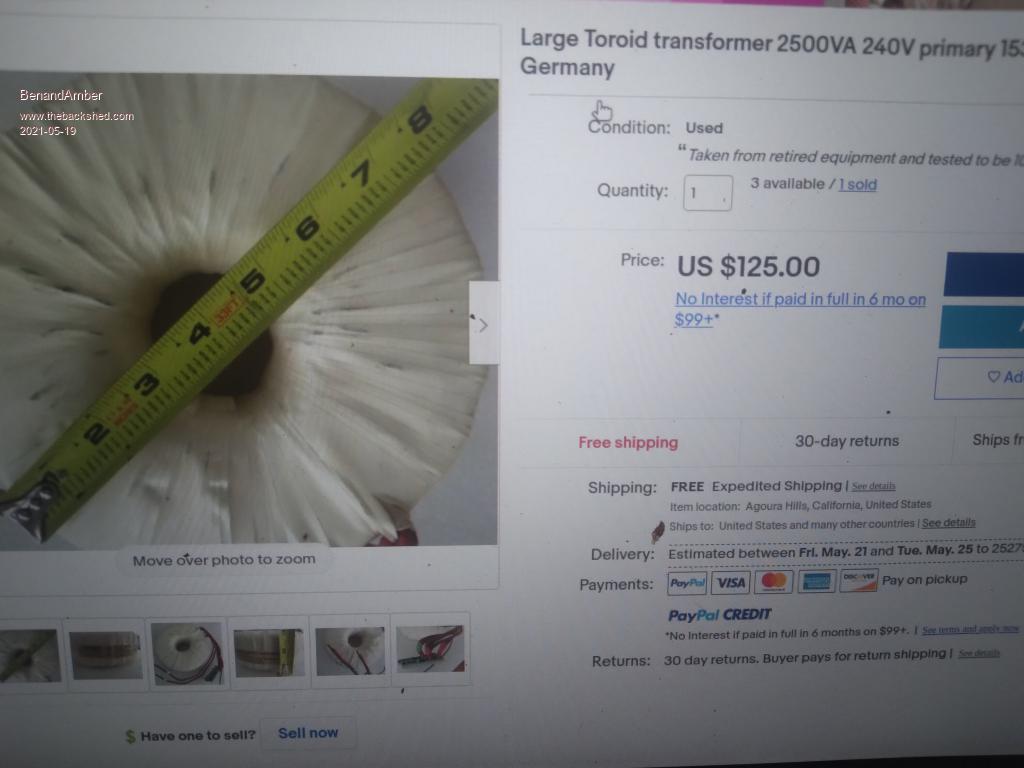

There is 2500 watt toridal trannys on ebay for was 99 now 120 including shipping
I have been told that these Transformers will do 4 or 5,000 watts when more copper is added
Two of those stacked up and wound as one would make a Transformer that would do some pretty crazy high-wattage
And I bet the guy would take $100 a piece like he was asking before for them if you bought two that's
including  shipping
The wire already on them could be reused both the low and high side for the new high side
Then add a new low side using battery cable wire or welding lead wire
For under 300 bucks and a little hard work you will have WELL OVER a thousand dollar Transformer
Let me know if you need the Ebay link

I talked to this guy a few months ago maybe it's been longer than that now but he's got a bunch of these Transformers
Very reasonable guy and he sold a lot of them for $99 including shipping
He knows how to rewire Transformers and he said that these would do 4 or 5000 Watts when rewired
