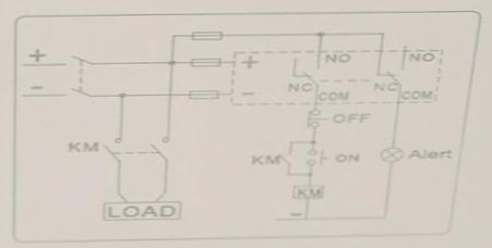

All the info you need is on the schematic above, identify the terminal numbers from the pictures at the website.
yYu need one external relay (KM) which has 3 x N/O contacts and wire it to the over/under relay as shown in your diagram. The contacts must be able to handle your load amperage.

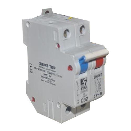

KM could also be a double pole dc circuit breaker fitted with a shunt trip coil.
That will then give you over and under voltage protection, over current protection, plus a convenient means of manual battery isolation.

Why is the contact rating given as 6A 230V?  I assume that is referring to the double pole switch on the left-hand side of the schematic.
If that switch is internal to the device doesn't it have to handle load current as well as on break as well?

My interpretation was the two off two-way-relays were each rated at 6A 230V.
I am not sure what KM stands for, anyone?
