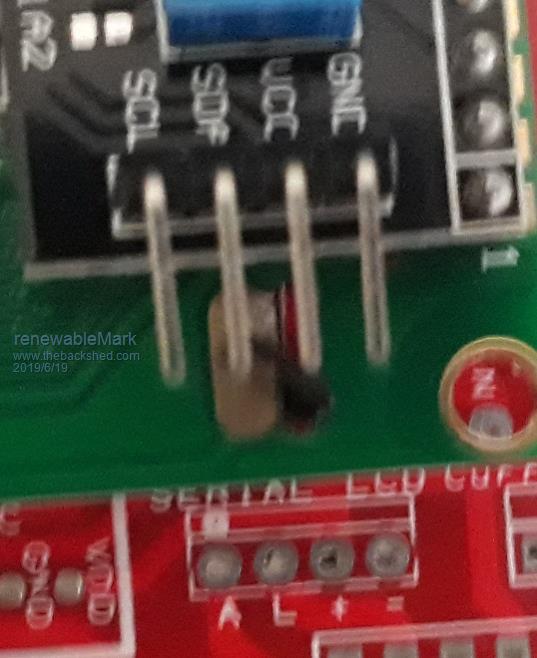

Mad, built one of your regulators and not seeing anything on the screen just wondering
if I'm missing something, I programed the nano with your program and all I see are square blocks on the screen..

Try adjusting the contrast on the back of the screen, that should fix that. Usually a blue trim pot with a white screw.
If the screen is blank go to this line in the code
"LiquidCrystal_I2C lcd(0x27, 21, 4); // Set the LCD I2C address 0x3F or 0x27"
and change it to this
""LiquidCrystal_I2C lcd(0x3F, 21, 4); // Set the LCD I2C address 0x3F or 0x27"
Or vice versa as depending on the supplier of the I2C LCD converter they use different addresses.

I changed the code and still nothing, maybe I have the wrong screen type.. I'll upload a photo

Did you adjust the contrast? You said you are getting square blocks on the screen not nothing.

Connections are not pin for pin, SDA and SCL, are flipped around.
Edit, 6th post down on P41 of this thread shows it.Edited by renewableMark 2019-06-20

Thanks, yeah finally figured that out lol,
thanks alot for the help Gary and Mark
