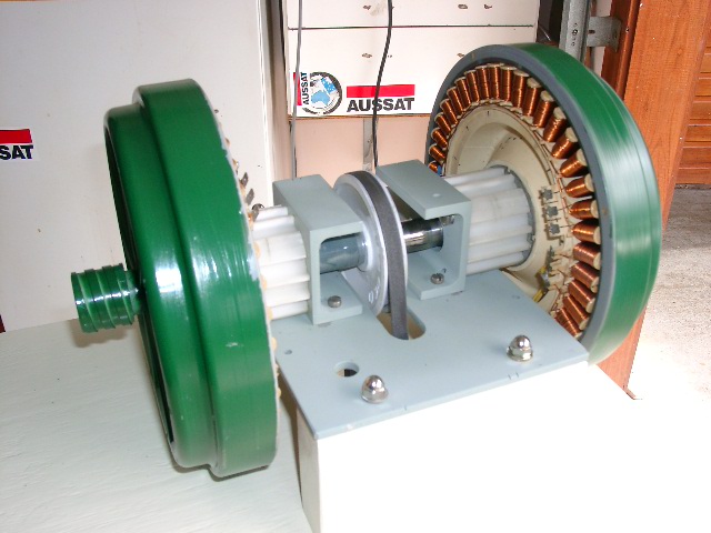

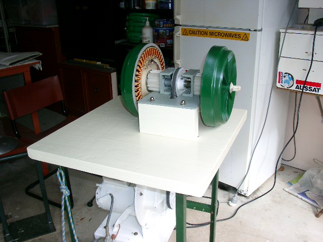

Hi Crew,, I've finally finished making a test bed for testing different re-wires of Stators and running up Neo Rotors .. I'll make an adaptor to fit the Seeley motor also -- With the gearbox (old floor polished) and 1.5 hp motor ,I get 400 rpm ..This can be changed by different pulleys .. Runs smooth ,just the normal gearbox noise..

Well done Bruce, very neat.
Do you have any way of measuring your drive motor current and F&P RPM? With those figures you can make some very accurate measurements.
Your workshop looks too clean!

where did you get the gears/pulleys? Where did you get the braces to hold the white plastic to your table?
How are you holding the gear to the shaft? It looks like you have screw. Did you drill a screw hole into the shaft?Edited by imsmooth 2008-04-12

IM,, the white plastic bearing holders were cut from the bowl of the F&P ,,drilled and tapped ,mounted onto Aluminium channel which is drilled and bolted to the Aluminium plate on the top of those 2 blocks of wood to give some clearence..
The pulley is bored on my lathe to tightly fit the shaft and a small seating hole was bored to accept the grub screw in the pulley.
Lots of lathe work and scavenging of parts ... the gearbox was an industrial floor scrubber ,found discarded at the local tip..
The actual frame was an old saw table complete with rise and fall mechanism and a 1 HP 240v motor .. local tip shop ,,$20.
Glenn,, could use a clamp meter and digital hand held rpm meter to do the above,,but Gordon has different ideas,,which I'll try to implement,as I get organized...
Yeah,,workshop is still nice and clean,,,,and all my gear is cleaned and oiled after use..
