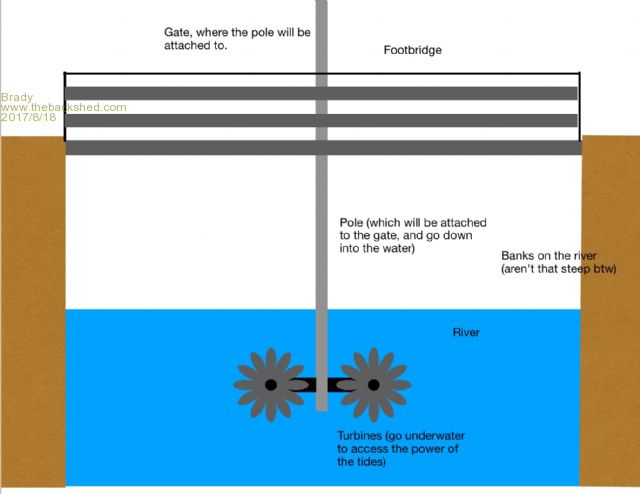

Let me describe the river before I get into the design of our system. To get across to the other side of the river there is a small footbridge. In the middle of the footbridge is a gate, which only the teachers can unlock. The river itself is relatively wide, but the banks are very difficult to access due to a lot of bush and mud. The most powerful part of the river is in the middle of it, which is hard to access from the banks. Conveniently, the gate of the footbridge is just over the middle of the river. Remember that, because it becomes important to our design later on.

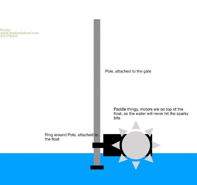

Here's a picture of the design we are aiming for
The pole will be attached to the gate, and it will go down under the water. Under the water, on the pole, will be two turbines. Both will be powered by the tides, and we hope to be able to charge a battery. Keep in mind, the is only a school project, it's not going to be titanic in size. The proportions in the image are VERY wrong, and it was only made to give you an idea of what we wanted to do.
Our knowledge of motors and turbines are very basic. From my knowledge, the turbine is connected to a large gear, the large gear is connected to a smaller one, to get to a higher rpm, which powers the motor. We are going to make these parts using a 3D printed That's all we've come to understand. Which is where I want your help. We want someone to explain to us, as simply as possible, how this all works. From the turbine design, to the gearbox, to motor and how they are all connected. Also, how would we water proof it? Could last overnight without breaking?
We would greatly appreciate a response, Thanks a lot for reading it all.

Before you even start, you need to find out two things.
1/ how much electrical power you need.
2/ how fast the water flows.
You need to find out how much capacity your phone battery has, and how fast you need to recharge it. Big difference between the amount of power needed to recharge it in one hour, and the amount of power to recharge it over several days or weeks.
The other thing is how fast the water flows. Is it barely moving, or is it like foaming white water rapids ?
When you know how much power you need, and how powerful the water flow is, only then you can begin to size the turbine.
Suppose it turns out that it needs to be very large, much larger than the depth of the water ? Or larger than you feel comfortable in building ?
So first we need to see if this is even practical.

You really need to find the flow as that will determine the power you will extract from the turbines
easiest way is to throw a stick (or anything else that floats) into the center, after having measured out a set distance downstream (say 100m) and time it from launch until it floats past the set marker position
Then you will need to find out the efficiency of your turbine prop and that will determine the size turbine you will need (flow rate will give your energy m^2)
The other issue is on a river speed of the flow will likely be fairly low most of the time, but alternators/gennies (unless custom built) will likely need fairly high speeds, requiring gearing- which makes it harder for the water to spin the turbine (it's more likely to stall the water directly in front and send most of the flow around the turbine- thats why they use dams as it forces the water to go through the blades)
You will almost certainly need to build a small scale prototype and use it to get base figures for your individual setup
I have seen plenty of people want to make something like this (I did when I lived on a local riverbank) but not many end up going ahead
Remember too that unless it is very small, considerable forces will be acting on your pole mount, so you will have to ensure the bridge itself can handle the load

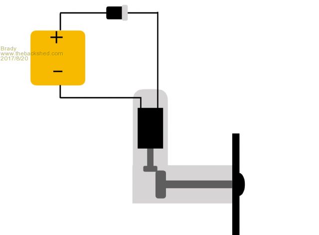

If using a DC motor in this fashion ie a generator; to wire it up you will need a 'anti motoring diode' otherwise when the flow rate is too low; the battery will make the motor turned into a genny back into a motor again and it will discharge the battery trying to push the river along faster!
To wire it up the motor/genny will have a + and a - connection; you will have to wire the motor - to the battery -, and in the + wire you will have to put a diode IN4004 will be fine for a small motor like the one mentioned before.
The diode is black and has a white stripe at one end- that end with the stripe is connected to the battery +, the other end without the stripe goes to the motor/genny + terminal
This stops the battery backfeeding or 'motoring' the generator when the flow is too low

As Boppa says, a diode will be required between the generator and the battery, but other than that, its about all you might really need.

Ooh, and diode and weird bezel gear things. Like this?

yep diode in the positive lead. And maybe look at a small charge controller to stop your battery from being cooked....not sure if they make them that small, or you could just go with small generator and charge controller and small 12 volt battery with small inverter to plug your phone charger into ha! unfortunatley it cost money , and would that be cheating?

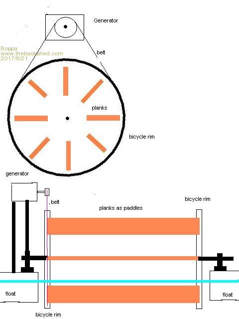

The paddlewheel is definitely a good solution and if you use a bicycle rim (a pair actually- one for each end of the paddlewheel) you could further distance your genny from the water, plus gear up to the speed required for the genny from the very likely lethargic paddlewheel speed by using the rim itself as part of the gearing- a rubber belt around the rim, and at the top it goes over the genny pulley, and you could attach the planks/blades to the spokes

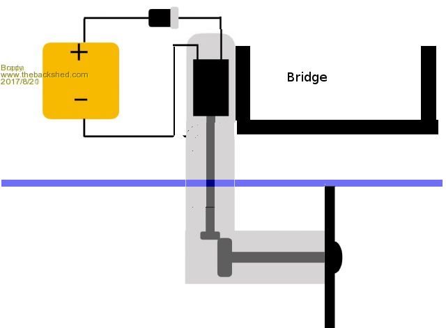

re the first diagram
The motor would be at the top actually at the deck level of the bridge so easy to access, the axle and pole/axle tube would extend right down to the water and below

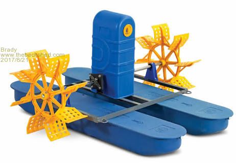

I found this thing,
I was thinking of something like that, but larger, and use those Water dispenser containers you find in offices.
I would place the motor in the middle of the two containers. I'm sorta confused by that belt system... But I found this video showing me how gears work and stuff, http://www.askaprepper.com/homemade-water-wheel-electric-generator/
Its the second video down. Do you think I could do something similar as that old man?
Connected through the motor would be the axle shaft, on either end, over the containers, would be the paddles (I really like the idea of using drums or bicycle rims as the paddle wheel, I'llsee what I've got access to.)
I'm going to talk with my team tomorrow about the floating paddle wheel idea, it sounds simpler to make.

And a suitable slim and very flexible multi groove rubber drive belt and pulley that should not slip, (even when wet) might be found in a discarded tumble dryer.
The drum in a tumble dryer is typically about 20 to 22 inches diameter, and the matching multi groove motor pulley maybe an inch diameter.
I believe BMX bikes typically run 20 inch diameter rims.Edited by Warpspeed 2017-08-22

I was thinking more along the lines of a sternwheeler lol
but the twin paddles would work too
paddles could be attached to bicycle spokes via nuts/bolts with large washers, or even with cableties....

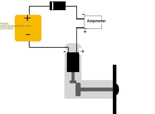

One thing you could do is measure the water speed, and if you put an ammeter in the lead to the battery (many schools still have them in the science labs I believe) if not a cheap multimeter with a 10A setting would work as well
Then you could chart various water flow rates with the current you get out of it
ETA
I just noticed- you have your diode backwards in the diagrams above- the silver/white banded end should be closest to the battery +, the unbanded black end would be connected to the motor +
