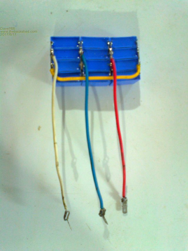

Here's a photo of version 1 power factor correction capacitors used for testing.
When using a capacitor doubler setup, found that the required torque was much greater with more power in for a given output. Max output with the drill was 700 W.
Just completed another test and got 870 W @ 488 RPM so this is now the gift that keeps giving!! Haven't even optimized it yet, so expect that number to keep going up. But a jump of 170 W over a capacitor doubler using the same drive system is a very big change!!

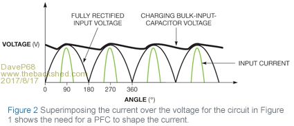

It works by removing the peak current pulses that occur due their "narrow conduction angle" through the 3 phase rectifier.
Here's an illustration of "NO" power factor correction on a single phase rectifier.

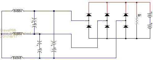

Here is a 3 phase power factor correction capacitor circuit (Delta).
