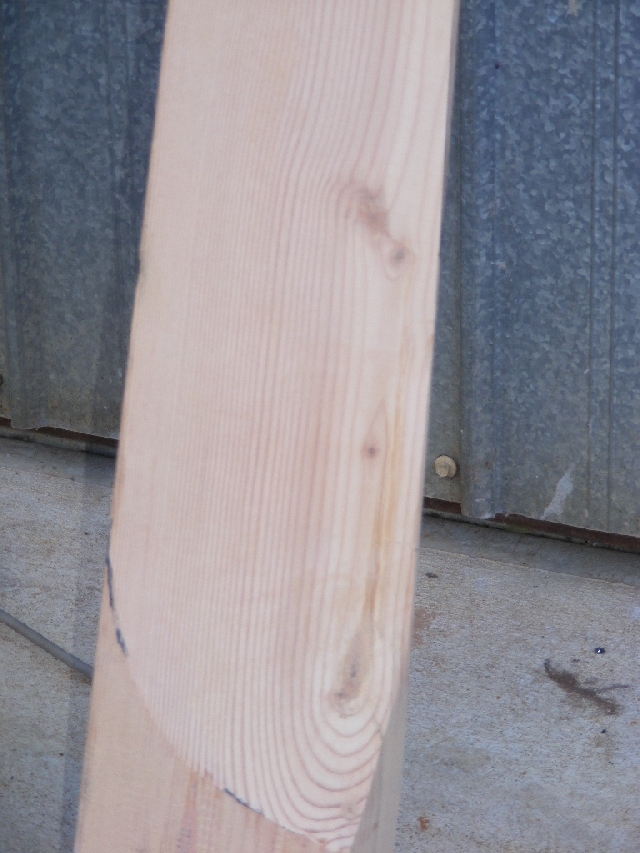

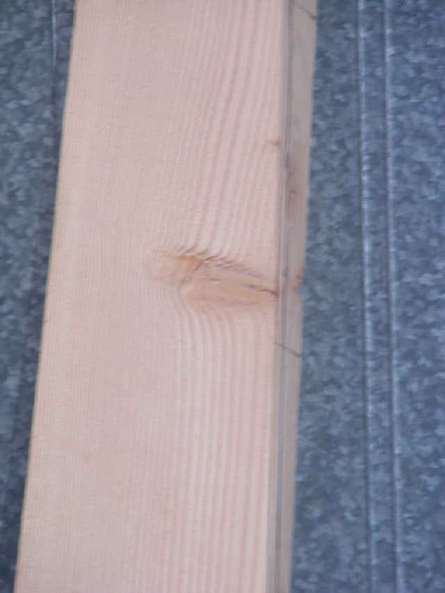

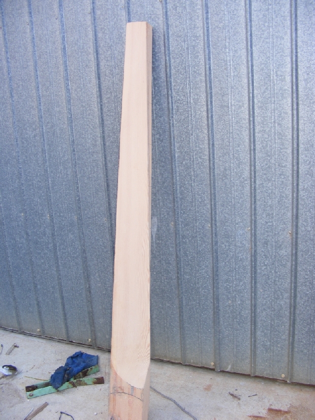

Well doing a Bruce and becoming a steptoe for a day we headed upto to the salvage yard where I got 3 decent oregon planks for some blades. Well Murphy is always around and it turned out on of the planks had a heap of knots so 3 hours of hand carving have gone to waste but better to be carefull I reckon. The pic's are of the the top side as I want to get all the angles true to Alton's Calc results then I'll carve the rear side once I'm happy all the angles are correct.
this is a pic of the good blade straight grain no knots
this was the first knot I found on the second blade
this pic is of the knots in the root of the blade
To be sure to be sure it aint worth risking this second blade so it will become firewood as for the amount of work hand carving turbine blades it aint worth taking the risk.
Anyway when I get further on the blades i'll throw more pic's up if you blokes want.
Cheers Bryan

The blades appear to be of a high aspect ratio. What sort of final rotor dia are you looking at? I hope all of the angles work out. It looks like yours will spin the opposite way to mine

Bryan, dont dismiss the knotted wood yet, you can use it if you have a circular saw and slice the piece into long staves. Select the staves that are knot free and epoxy laminate them together (alternating the grain run as observed at the ends)to form your blank. Proceed to carve your blades, they will now be a lot stronger than if carved out of a single homogenous piece.
I have built centreboards and rudder blades for my boats that way and they have *lots* more load on them than a windmill blade will ever see.

Hi Brian,, don't throw that knotty one out ,,the two top knots look to be fine,the bottom one ,I've had worse than that.
Looks like you are carving these blades to go anti-clockwise,,or am I seeing wrong?

Well I might aswell finish that knotty blade off and see how it turns out. Anyway the blades will be 3 metres diameter and yes the blades will be spinning anti clockwise. Basically when I marked them out for clockwise I couldnt get a decent leading edge but the other way worked out good. O'well I dont call myself ruddycrazy in fieldlines for nuffin and it wont matter which way the blades spin.

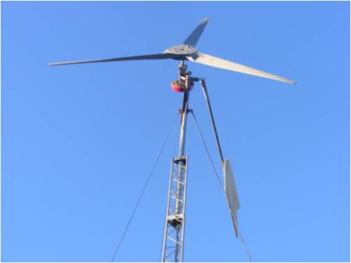

Well after I finally got some shed time I got my new mill all finished and up and flying.
As you can see it's the opposite to Glenn's design as it will go anticlockwise and furl from right to left.
Well if you look closely at Tru energy add with the blonde she does show their mills going anticlockwise. So I must be doing it right.
Cheers Bryan

Good work Bryan, those blades look real nice.

Good on ya Mate,, nice to see you are "up and running" ..
When the wind comes in ,,keep an eye on the meters and let us know the wattage ,,,,I suspect 220--300 ,,,

Well guys the first performance figures are in It was blowing a gale when I got home from work and my wife well looks like your new genny wont self destruct like the last one's. Anyway I shorted the mill out and put my cheap $10 dmm on set to 10 amp. I turned the short switch off and soon saw 2,4,7,9,11,14 amps then nothing as the fuse blew. As the batteries were on 26.5 volts I worked out 371 watts. Now it was cloudy all day here on the farm and my 700ah array was sitting on 24.5 volts last night so today the genny has proven to me it works a treat. I know it's going to blow a gale here tonight so this is the first real test on the genny. But as far as looking at the blades they speed up nicely with no hint of inbalance so hopefully I got this new genny right.
