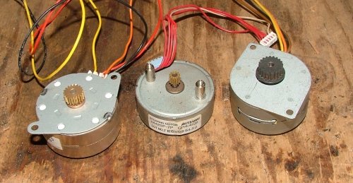

The motor shown on the web site was from a 5" floppy drive, but these are getting hard to come by, and almost collectable. The best source of litle stepper motors today would be inkjet printers. People throw these out as soon as they realise the ink cost more than the printer, but as a source of parts they are great. These motors were from ink jets....
You just need to think of a way to attach the turbine.
