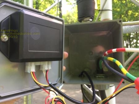

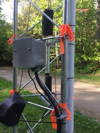

I thought folks might be interested to see our latest turbine addition. I added a linear actuator (well hidden behind all the weatherization efforts) which operates off the CC to furl the tail. This is not for normal running mode operation, but is set up to (softly) shutdown the system when the input voltage to the controller goes over a preset voltage, currently about 125V. So if a windy overcast day turns sunny, and we no longer need the power.
It has a built-in potentiometer so the presets can be set, and triggered with one contact closure using one of the auxiliary relays.
So far working pretty well. We'll see if it holds up thru all the different weather expectations.

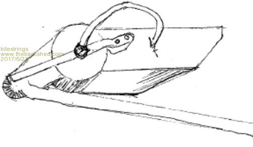

We actually dabbled with the idea of a ratchet on the yaw hinge that could be engaged from the ground. I had a handful of early sketches:
In the end I like the approach we have. I had been closing it down with a small hand winch. This just allows me to do it from the house, or PC. For a total shutdown, I furl the turbine and then connect the load bank. This brings it to a minimal rotational speed - less than 20 rpm I'd guess.

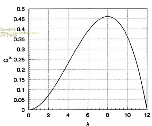

That's a big drop from a peak of 1800 W down to 200 W and with the load bank added in down to 20 RPM.
From what I know about blade TSR, the RPM even in high winds will not be able to get above 50-60 RPM. The reason for the low, but "controlled" RPM is the blades are fully stalled. This keeps everything well within safe operating limits too.
You've forced the blades into a 'power coefficient' of less than 10 % of their optimum operating range which would normally extract the maximum amount of power.
Here's a 'tip speed ratio vs power coefficient' graph to illustrate what I mean, more for those that read this that may not understand what I'm referring too.

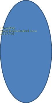

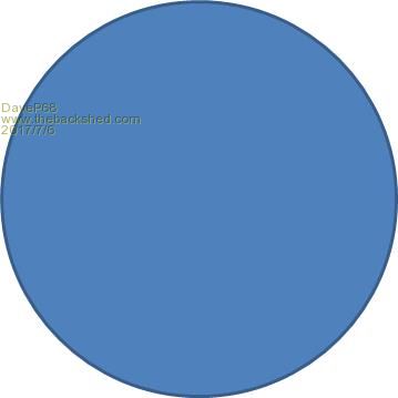

This is how I see what you were trying to explain about how the "front on swept area" of the blades actually looks during furling as explained above.
No furling full swept area of blades.
Now 50 % furling with blades at 45 deg to the flow of the air stream.
Now 75 % furling with blades at 67.5 deg to the flow of the air stream.
This along with an offset angle of attack of blades to the wind flow is the reason for the big drop in power in the shaft feeding the PMA.

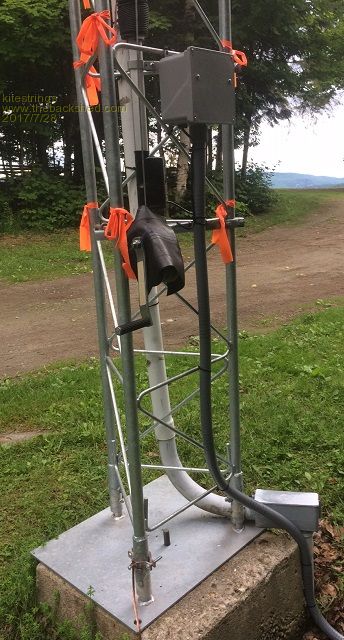

A couple minor tweaks to this thing:
Since it looks to be a more permanent feature now, I ran some non-metallic PVC liquid-tie and buried a portion of the run where we have a logging access road.

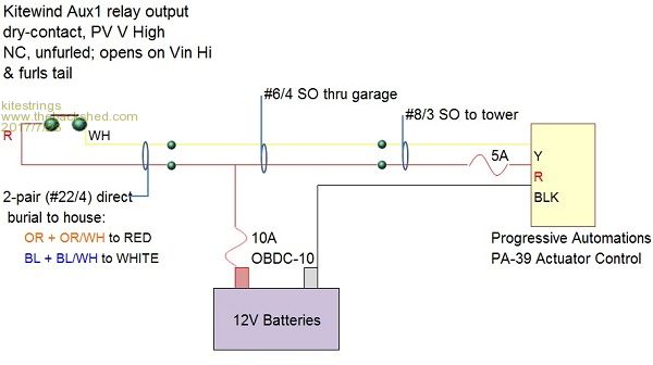

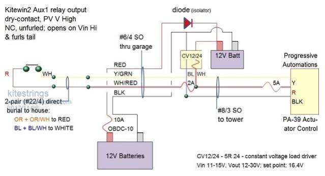

I documented a make-shift schematic for when ICRS in the near future.
Lastly, I'm adding a constant voltage pump/motor driver on the line to the tower. This thing runs off a small 12V bank in the garage. We have our (trusty) old Trace inverter there which runs the OH door openers and a few light loads. When the batteries dip what's left on the end of the run to tower is another ~1/2V lower. The pump driver will provide a steady ~14V output with a varying input (11-15V).

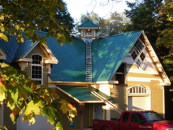

Notice the "Rutland" turbine on the cupola. I call this our functionalweather vane. It charges, a bit, into the 12V bank in the garage.

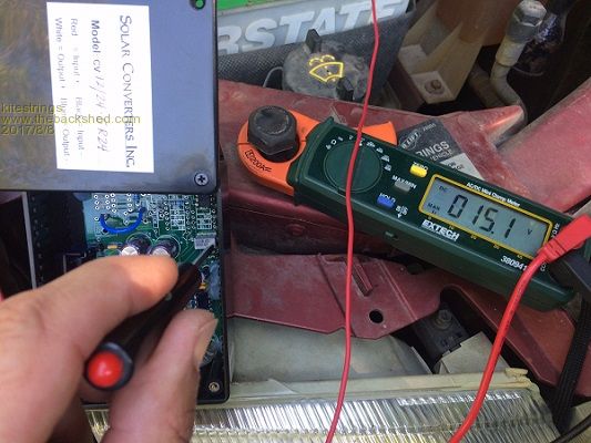

I've added this constant voltage converter. It is a pretty slick unit. Takes a varying input voltage 11-15V, (5A max.) and allows you to set the output voltage. Here I have the thing powered off my truck battery, and I'm setting the output voltage to about 15V.
Current losses have been causing me a bit of grief, so I plan to move the DC source closer to the thing. I also found a aux. battery isolator, so I should be able to isolate power to this thing on a cell that is unaffected by [other] load. Should of probably done this in the first place.

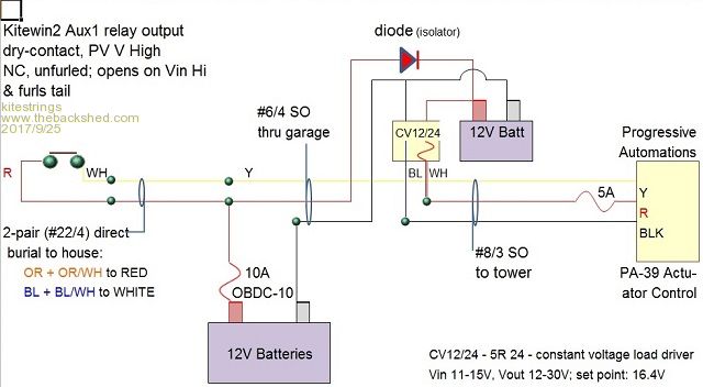

I was reminded that I probably should update this post. Our final schematic has changed a bit. We added another battery closer to the actuator (but still inside the shop), and I also put a diode/isolator in to block this battery from any local loads. The actuator uses a built-in potentiometer, and the controller is a bit sensitive to current losses. Seems to be working well now.
