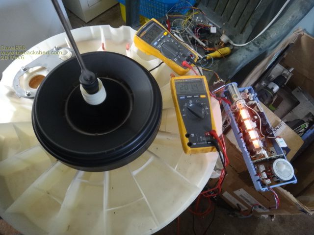

Here is a photo of a modified module used as a load at 900 RPM 1000 W of energy being extracted from the stator.

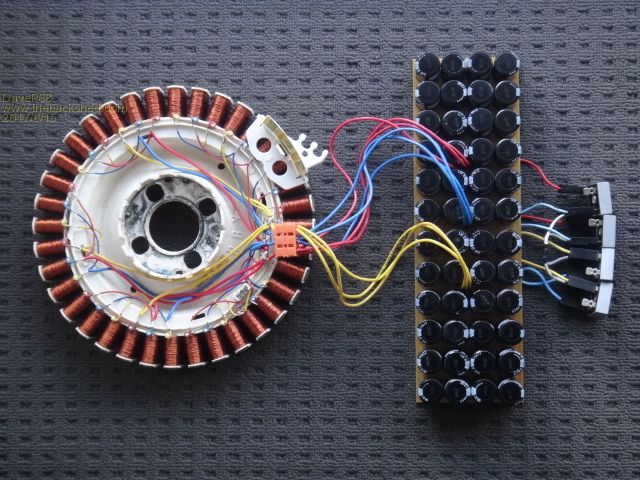

The proposal I have is to use a capacitor doubler to extract maximum current out of the stator before the core becomes saturated. The trick is to extract maximum power from say 2 stators on the same shaft when a peak RPM is reached. If more power is taken from the shaft than the blades can deliver we go into a lower TSR range. That way a controlled shut down can be done before the wind gets too strong.
This requires some fine tuning in terms of a workable system, but from some testing I've done with one stator it should be possible.
With this separate cap doubler (one for each stator) is used for braking only when running in over drive mode on a 36 pole 4x 3p Delta I get 72 VDC 16.4 Amps 1.18 kW @ 550 RPM. Thing is the shaft power required to drive the stator is >2 kW. That is from just 1 stator! This same stator when not used in braking mode would normally be charging a 48 VDC battery system. The same system can be set up for a 6x 2p Delta, with the brake operating at 48 VDC 24.6 Amps peak at brake application.

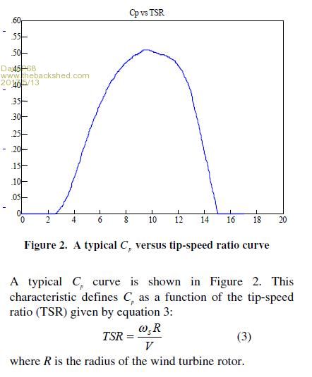

Taking more power from the shaft than it can deliver will push the blades into stall region slowing them down by dropping the TSR to below 5. The maximum current and voltages of course would reduce and have to be carefully controlled to slow the blades down.
This way the blades can brought to almost stopped state (tuning slowly if wind is strong enough) if set up correctly. The brake would release when the stormy conditions have passed so to speak. Yes you would not be making power while storm passes but wind turbine stays safe

Have been thinking of doing some more work on this Electronic Dynamic braking and I think you're idea to energise the stator is great to get the RPM down to a minimum amount. This can be done by firing an opposing waveform back into the stator. This can be a closed loop controlled system by making use of the RPS unit (Rotor Position Sensor) that sits on the side of the stator.
Refer to the white device that is sitting at the 2 o'clock position on the stator in the above photo. In this setup it's only going to be used to measure the exact operating RPM of this stator.
